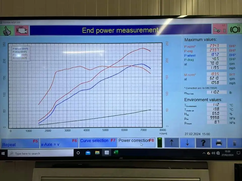

There was someone on FB that did a run. Will try to find it and edit this post
Thanks - that 187 is well down against the reported average of about 215 at the wheels. Something is amiss somewhere.
Yet corrected it comes out at 234.3bhp and 183.5lb/ft which is extremely close the published values.
It seems to be about the only dyno that is close to the published values
It's possible that the rolling road operators are all incompetent, but disappointing if that's the case.
Are they all reporting at the wheel figures? Might be some compensation going on by default (don't know if this is like the 0.3s they always knock off the 0-60 time for 'one-foot rollout').
They dyno pic from FB above looks very accurate - there is a ton of drivetrain drag on these cars (try dipping the clutch downhill and it's like you've taken a brake off).
