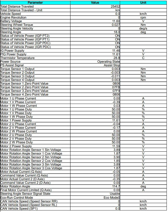

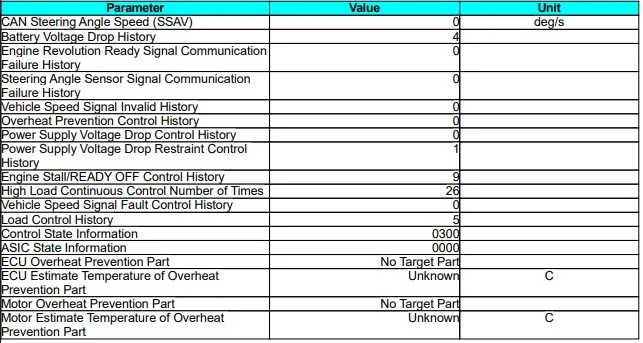

If you could hook up TechStream, there are actually a few interesting EPS parameters you can log. Or I could figure out the OBDII PIDs and you could log them with a Torque app.
Figuring out exactly why it's happening, whether it's a voltage drop, the system limiting the current, or it's just getting too hot, will give a better idea of what's going on and if there's a potential workaround.
If you do end up grabbing some data, the helpful things to look at would be:
Battery Voltage: to see if it's dropping off significantly under load.
Command Value Current (Q Axis): how much steering assist the EPS wants to provide.
Final Motor Current Limited (Q Axis): the actual assist you're getting after the system's internal limits and logic kick in.
Thermistor Temperature: to check if the system isn't overheating.
Even if you pull only historic and not live data, there are some values showing what was happening.
Realistically, this might not be something you can 100% fix on the current setup, especially since Toyota specifically upgraded the EPS for the Type 26 models. But it would still be really interesting to see exactly what the bottleneck is.

Cheers I actually have techstream - should just learn how to use it. But this was good intel to analyse the issue.

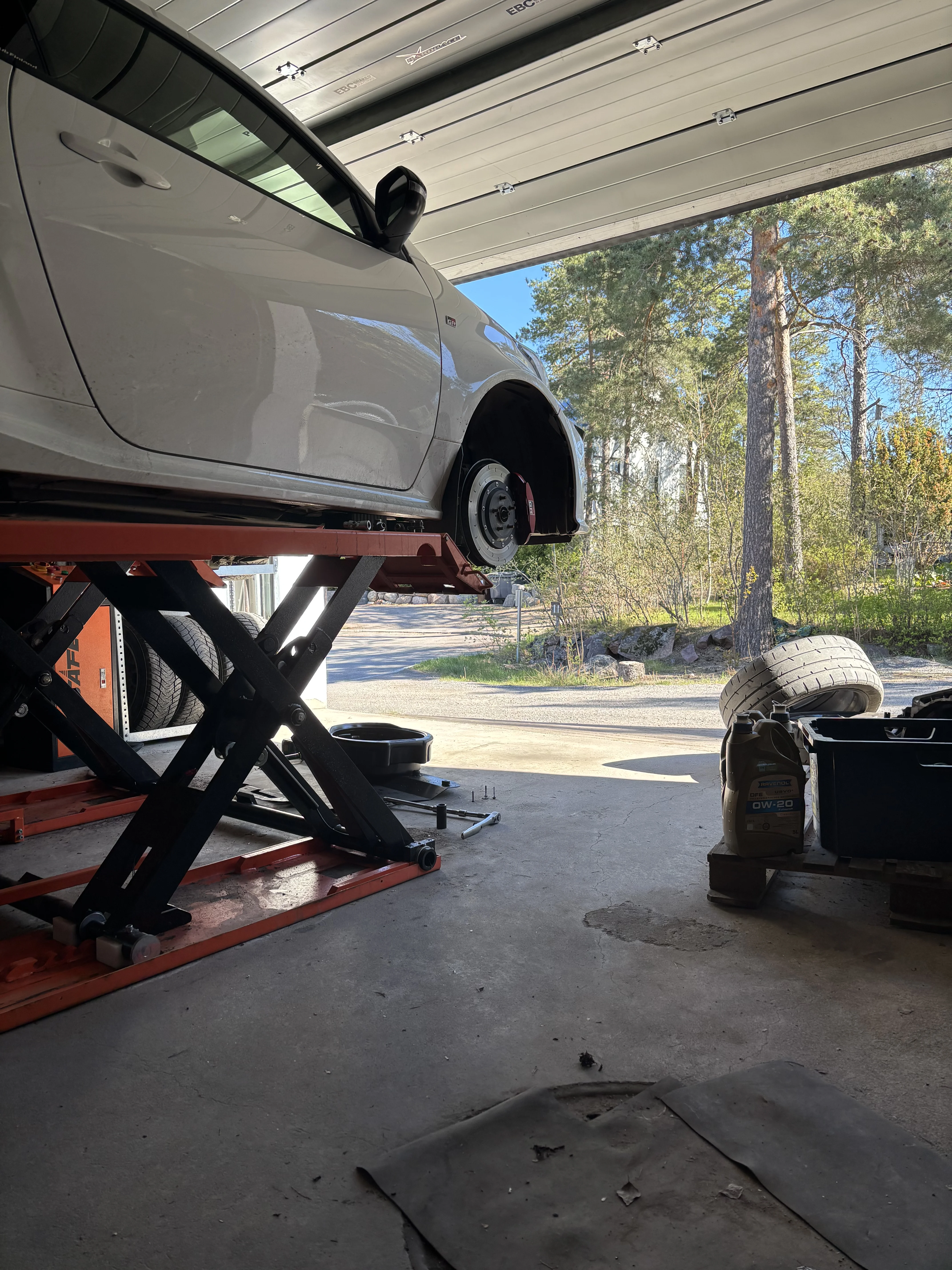

Swapped rear diff oils. Span the fill plug and was almost desperate but luckily it eventually opened.
Oils looked okeyish. Maybe 12tkm driven. Need to do the same for kulmavaihde later this wk.

Holiday day so transfer box oil change and front pads change.
Am i getting weak, old, or both, but filling that box juice with manual syringe is effin crazy push!! Started thinking that maybe next time is worth paying for the service vs getting an ruptured aneurysm..
Oil smelled very very bad.
View attachment 41078Holiday day so transfer box oil change and front pads change.
