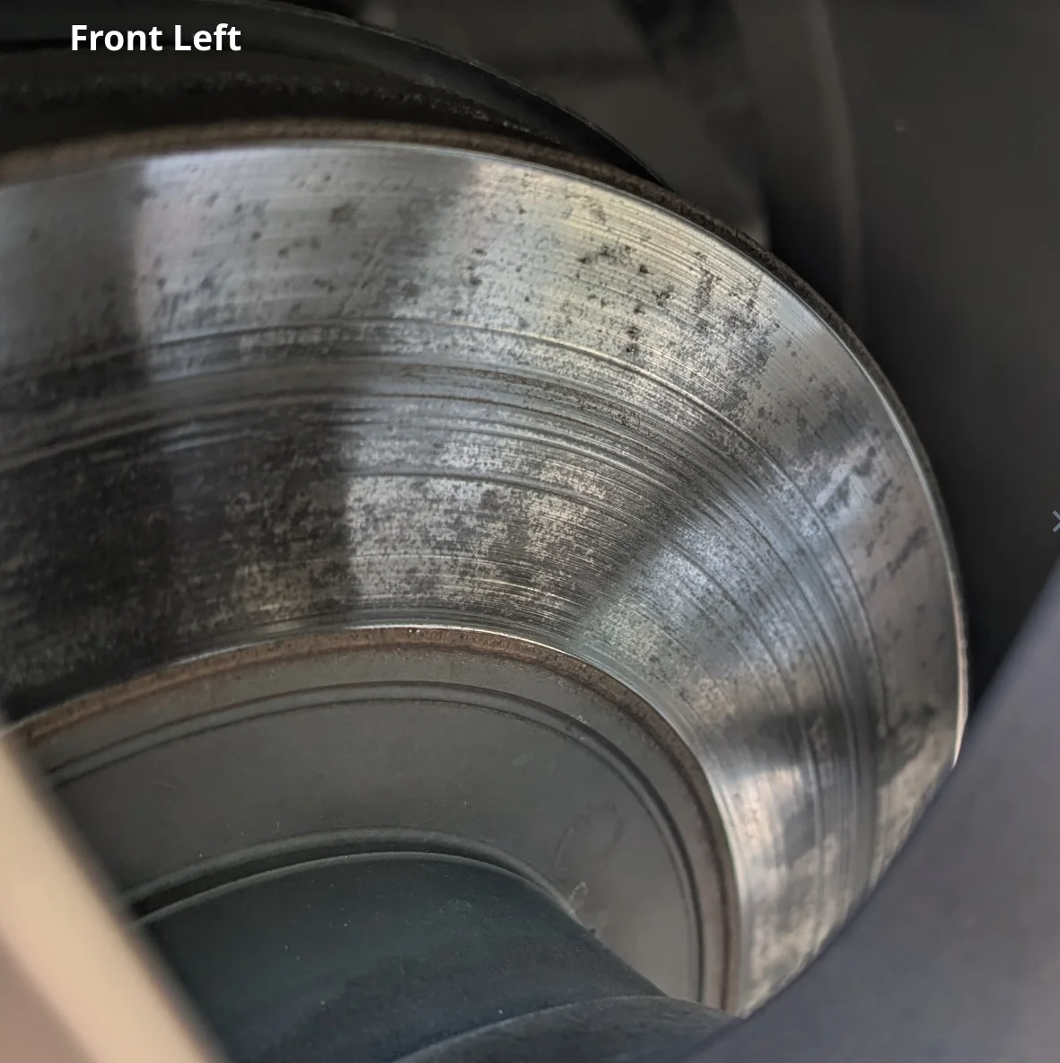

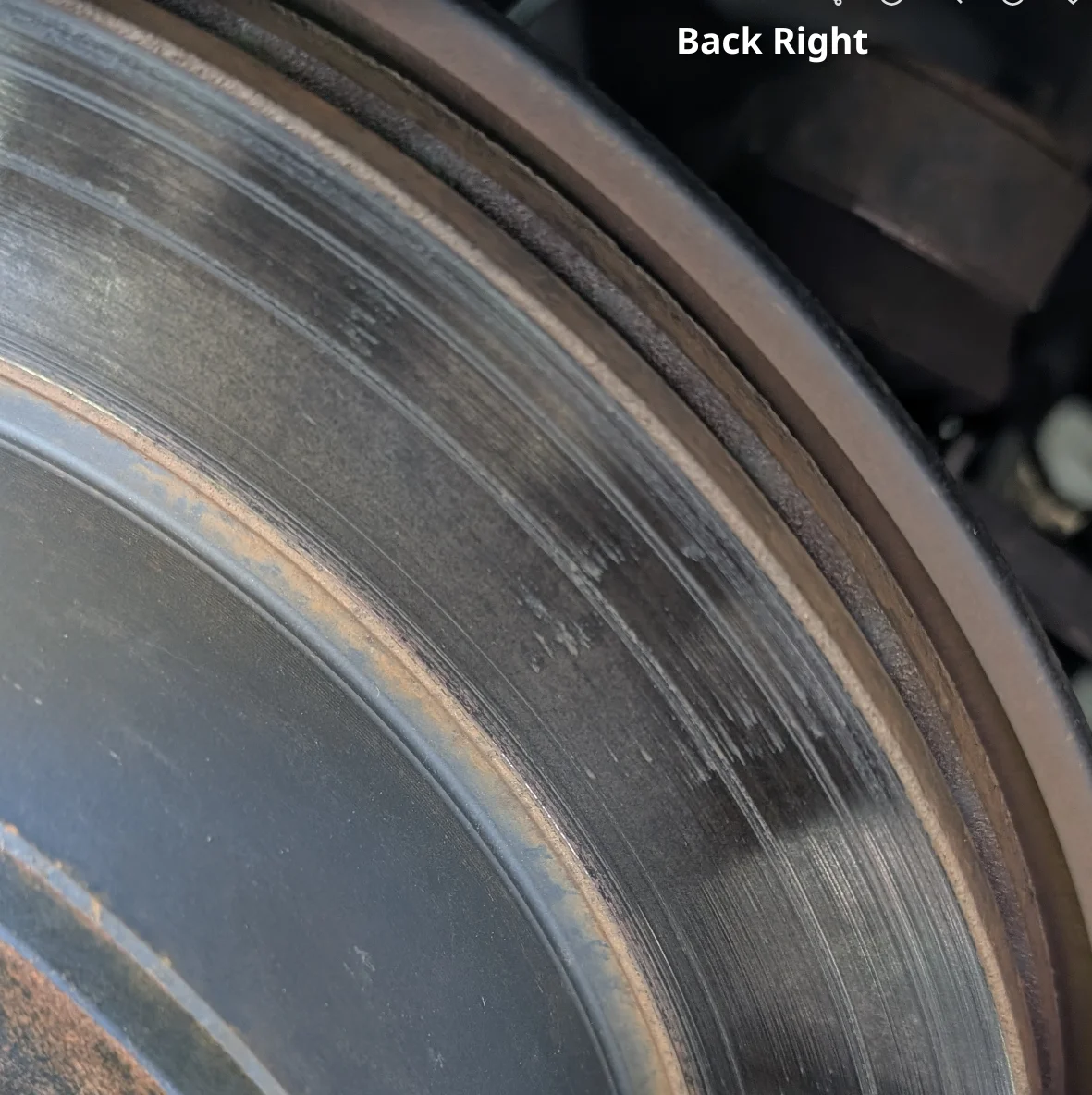

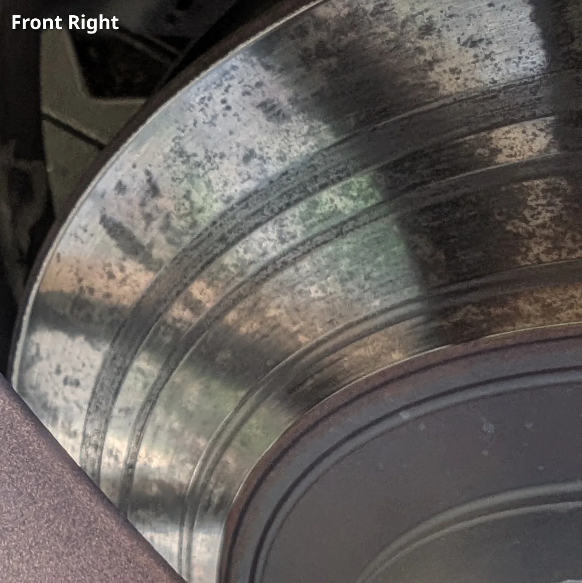

Hello,
I've noticed there are grooves in the brake discs. The grooves in the front discs are only in a few positions, but relatively deep/distinct. In the back they are more evenly spread out.
Hard to explain so here are some pictures:
For about half a year the car only gets driven on weekdays. It's parked outside and after a rain the brake pads usually stick to discs. Sometimes I could hear something scraping for the first few meters.
Is this normal wear for these circumstances? At which point do the brake pads and or discs need replacements?
Thank you.
For now, I drive around with the groovy discs🤓
Oooh, that doesn’t look great. I reckon you may have caught some debris (maybe iron from the discs) in there, or the pads are damaged.
The discs should have fine concentric lines all around with no grooves that can be snagged with a finger nail.

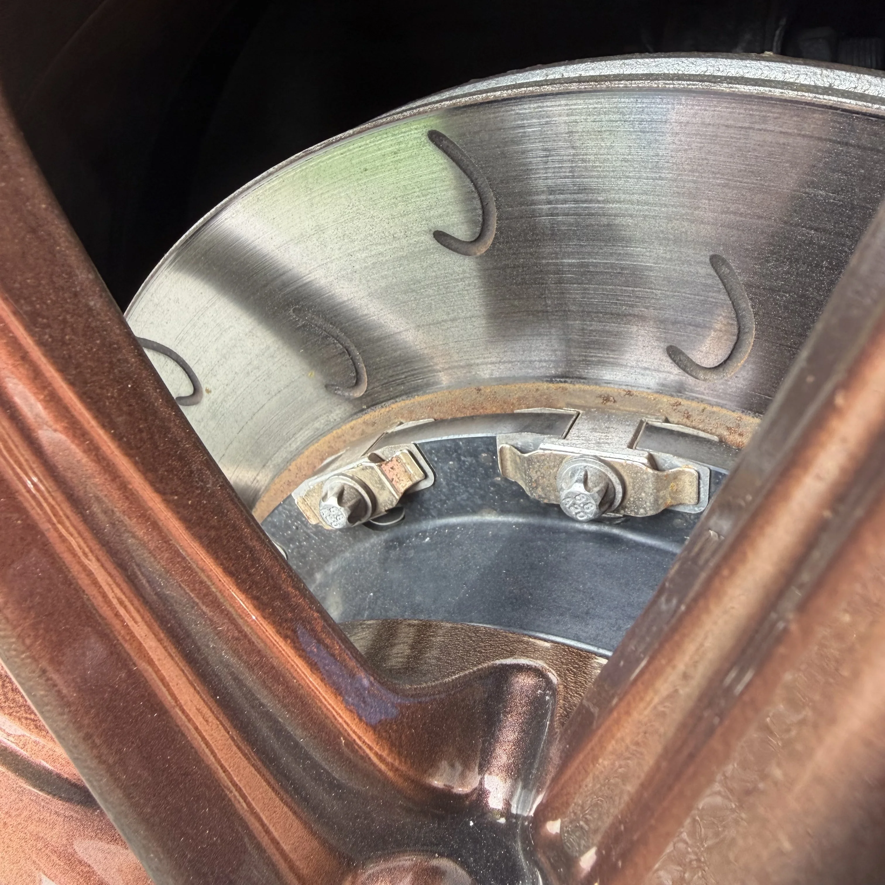

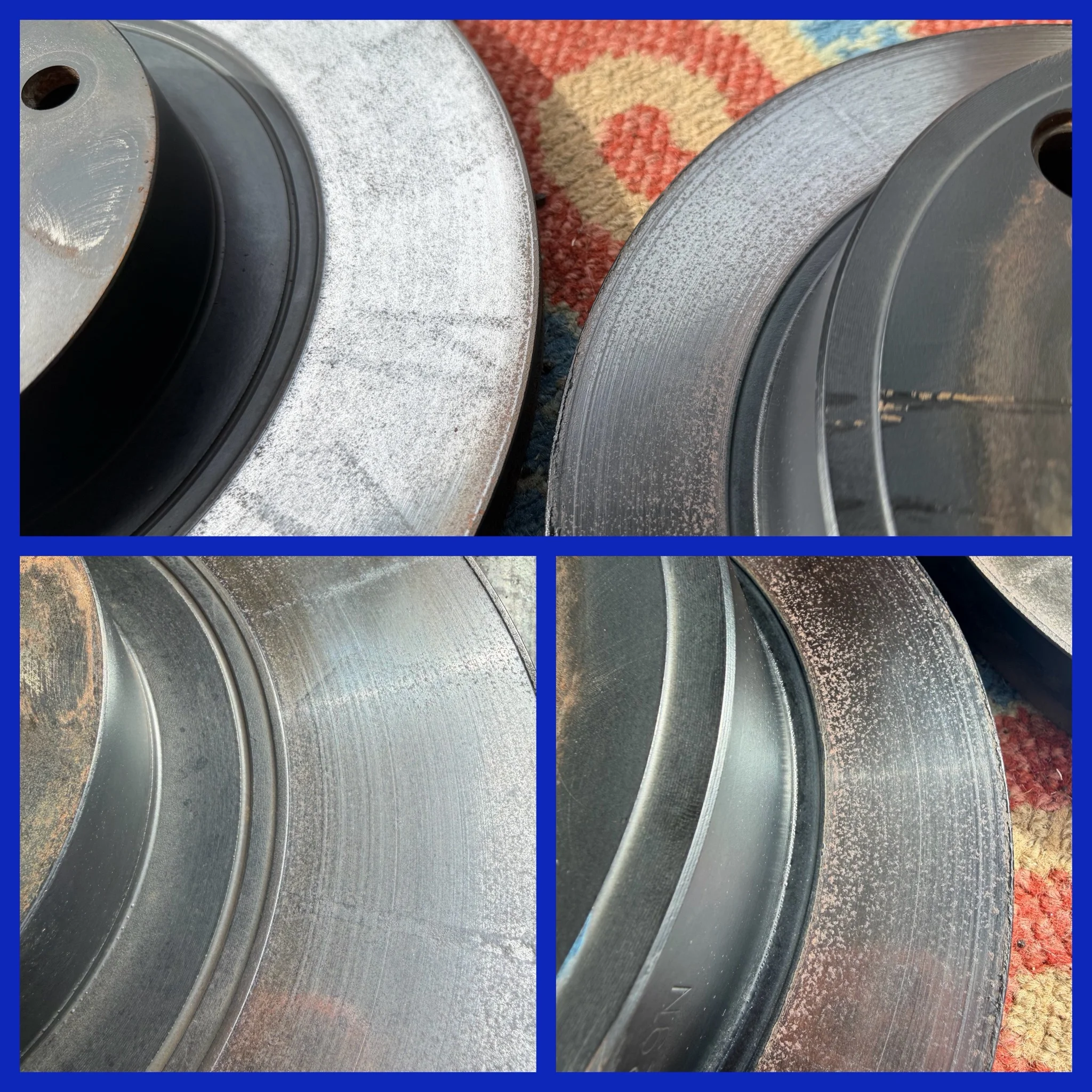

The image below is a shot of my OEM discs. Excuse the rust spots as they’ve been on a shelf in my garage. The second image is of my BBK as fitted.
I think you might want to look at getting those changed down the line …
OEM set:
BBK (fitted):

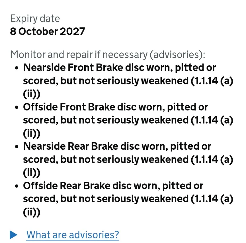

I had grooves in my discs which were caught during my service in July, the right rear brake pad (which was admittedly low and needing replaced within the next few months anyway) had also stuck which had to be jemmied off. Occurred some time between the car's MOT in January and the service in July, circa 27,000mi. Cost me a grand at the dealership for parts and labour so save yourself some money and at least order the pads and discs yourself!

Oh man, compared to your discs, Sonic, mine look completely knackered. o_O
