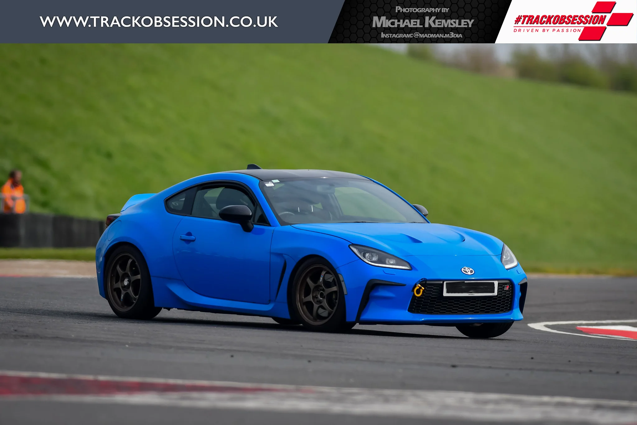

Track day photos
Oh man it's been a good while since I updated this. The list is too long to recall, these are the latest:
- MeisterR ZetaSport Coilovers
- Whiteline rear roll bar link
- MCA suspension traction mod v2
- GR86 performance package rear disk brakes, dust shields and ICP calipers.
- carbon fiber prop shaft
- Exedy lightweight flywheel
- Cusco steering rack brace
- STI steering rack bolts
- Dunlop sport max2 tires
- STI trans mount
- Weir performance 4.56 Final ratio
- Whiteline diff bushings
- Cusco rear upper control arms
How do you rate the MeisterR ZetaSport coilovers? I'm thinking about going for these hoping for a bit more composure at the rear end on bumpy B-roads. Already have the MCA traction kit but it's not enough. I guess you have 5kgf/mm springs all round? Does that make the ride even more choppy or is the damping really that much better at keeping things under control as they claim?
I am ashame to say that I do not remember the spring rate. But you may be correct, it was not far off from oem.
Damping wise it is better yes and you can go soft or hard on it. For a track oriented car you will want higher sprint rates though.
