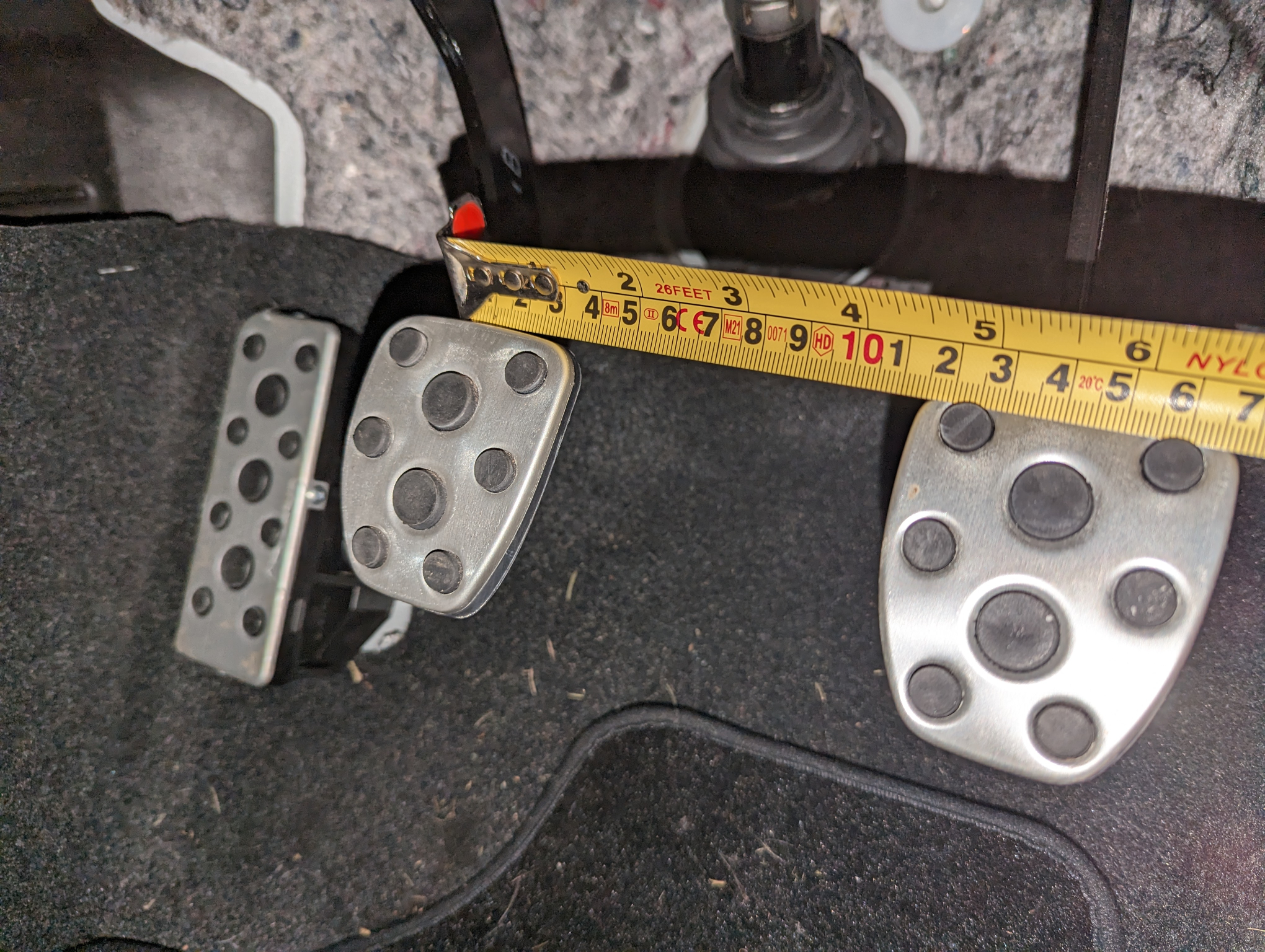

I've lowered the clutch pedal to be slightly higher than the brake pedal, and that's made a huge difference. Gear changes and pulling away definitely feel a lot nicer now.
As far as I can tell having the clutch that high isn't going to cause any issues with the clutch not disengaging properly (based on letting the call roll when in gear but with the clutch out, and the gear changes still feel smooth.
It's a bit awkward to show the height, but using a measuring tape the brake pedal face is roughly in line with the back of the silver clutch pedal face.

Thanks to @ZN8 I've now been able to fit another clutch spring which is about 75% lighter than stock (LC095L02M) spring, as he ordered a lighter one but was happy with the MTEC equivalent strength, and was happy to donate the unused one to me.
The result is about as I expected....it's improved the feel of the clutch even more. It's not as big an improvement as moving from stock to the MTEC equivalent spring (which is about 58% weaker), but I now can't feel the point where the clutch pedal pivots on the spring at all. It's now weak enough that it doesn't seem to be providing any meaningful assistance to pushing the clutch down, which means that most of the resistance I can feel must be from the clutch itself.
The clutch pedal does feel heavier as a result, but it's by no means a problem or obstructive. No heavier than most other manual cars I've driven. As I said a few months ago, really it's just averaging out the force required throughout the whole pedal travel; it doesn't feel like the pedal effort changes when you reach that point where the spring pivots from pushing the pedal up, to helping push it down.
I can see why many in the US ditch the spring entirely...that would give you maximum feedback by ensuring the only force pushing back against your foot is that of the clutch plate itself. But of course you'll end up with a mushy pedal as it won't return to its top position. I guess the ultimate solution is to fit the weakest spring you can find...literally just strong enough to keep the pedal from being slack.

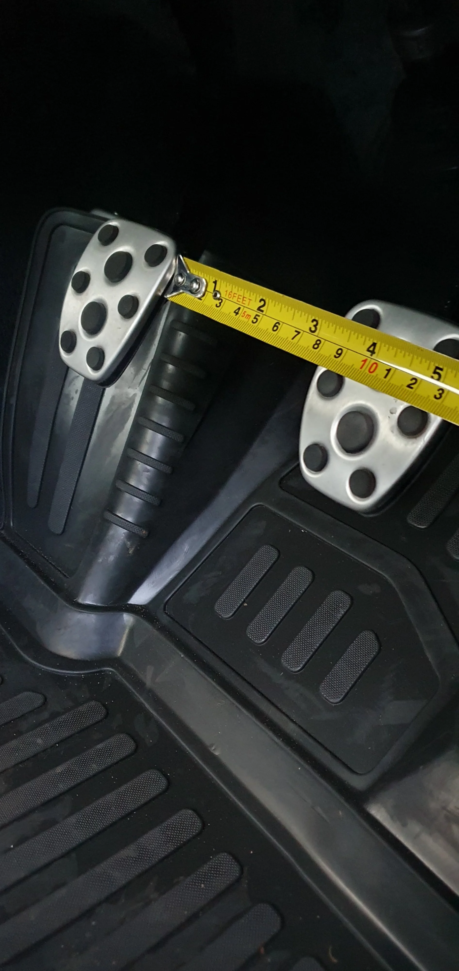

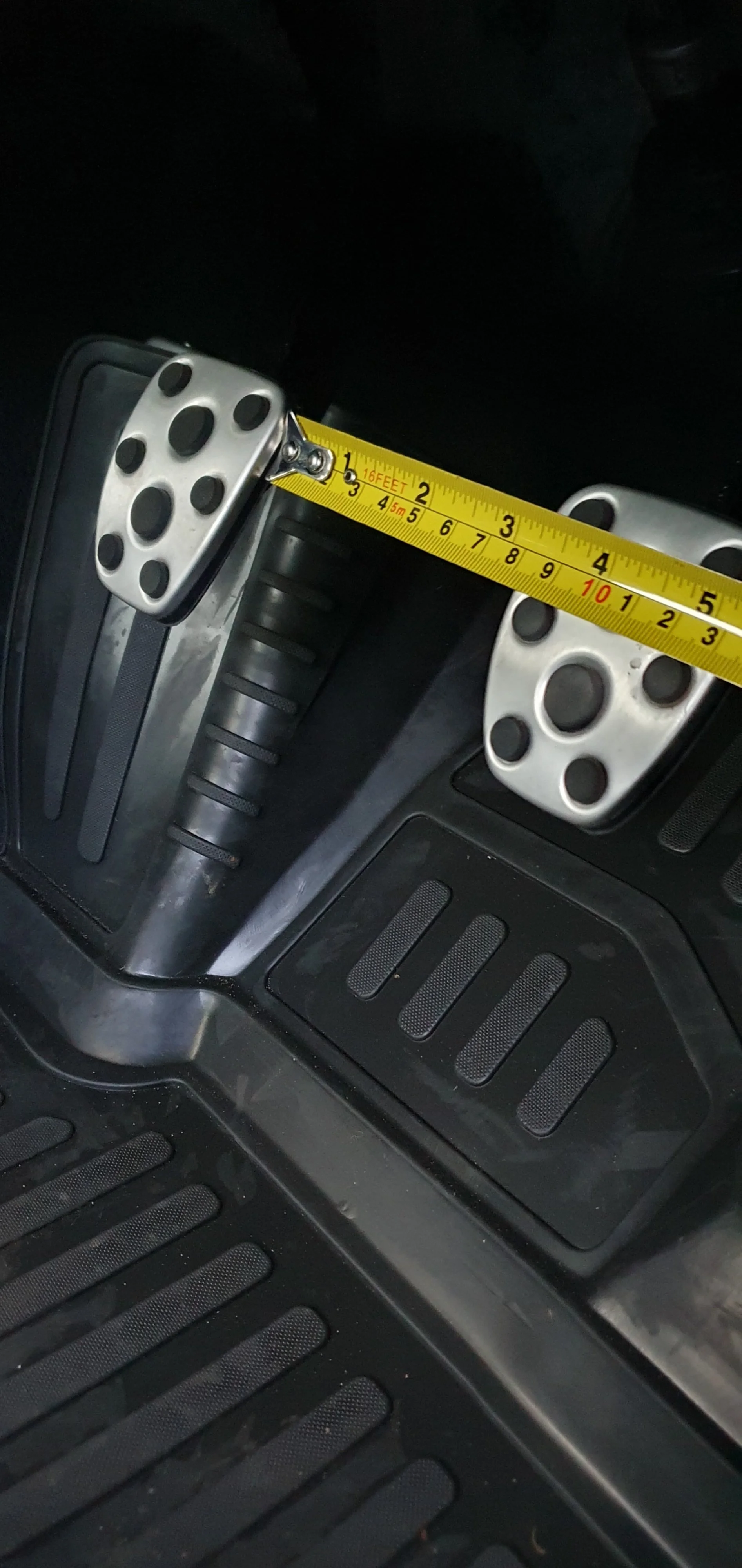

Installed my sorting today. But inadvertently I twisted the rod to get into place when I was fitting it back. But I don't know how to tell if it is too far down, it drives well though. Any ideas how to tell if this won't cause any issues down the line?
If you adjust the pedal too far down then you'll know because it will be difficult to shift gears (as even with the pedal depressed, the clutch won't be fully disengaged). But from the look of your photo, the pedal is still a fair way above the brake pedal. I think I adjusted mine lower than that and it feels fine so if yours feel and drives okay, then I wouldn't worry.
