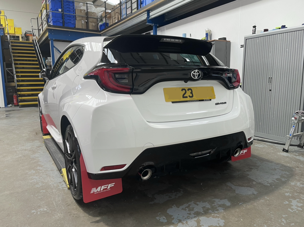

2 - Rallyflapz - Very popular as known, this is a size which actually do stop gravel and spray to a somewhat good level. Unfortunately the material is too soft for exited driving on gravel/snow/slush etc. The rear hips of the car still gets smacked. Also here very easy fitting in front, easy but with drilling in the back. Drilling in the back means removing the rear wheel, fit and adjust with tape, drill, mount.

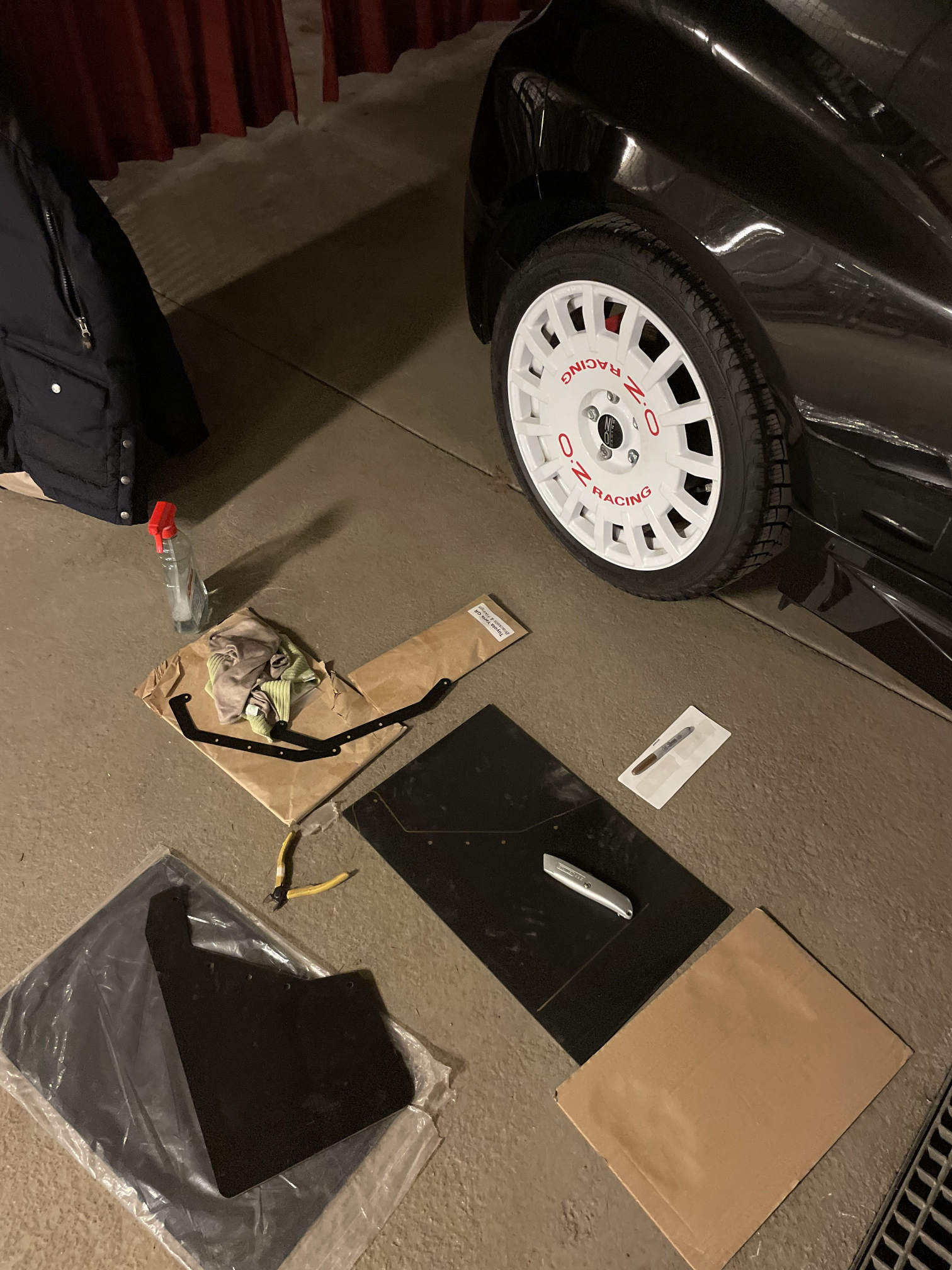

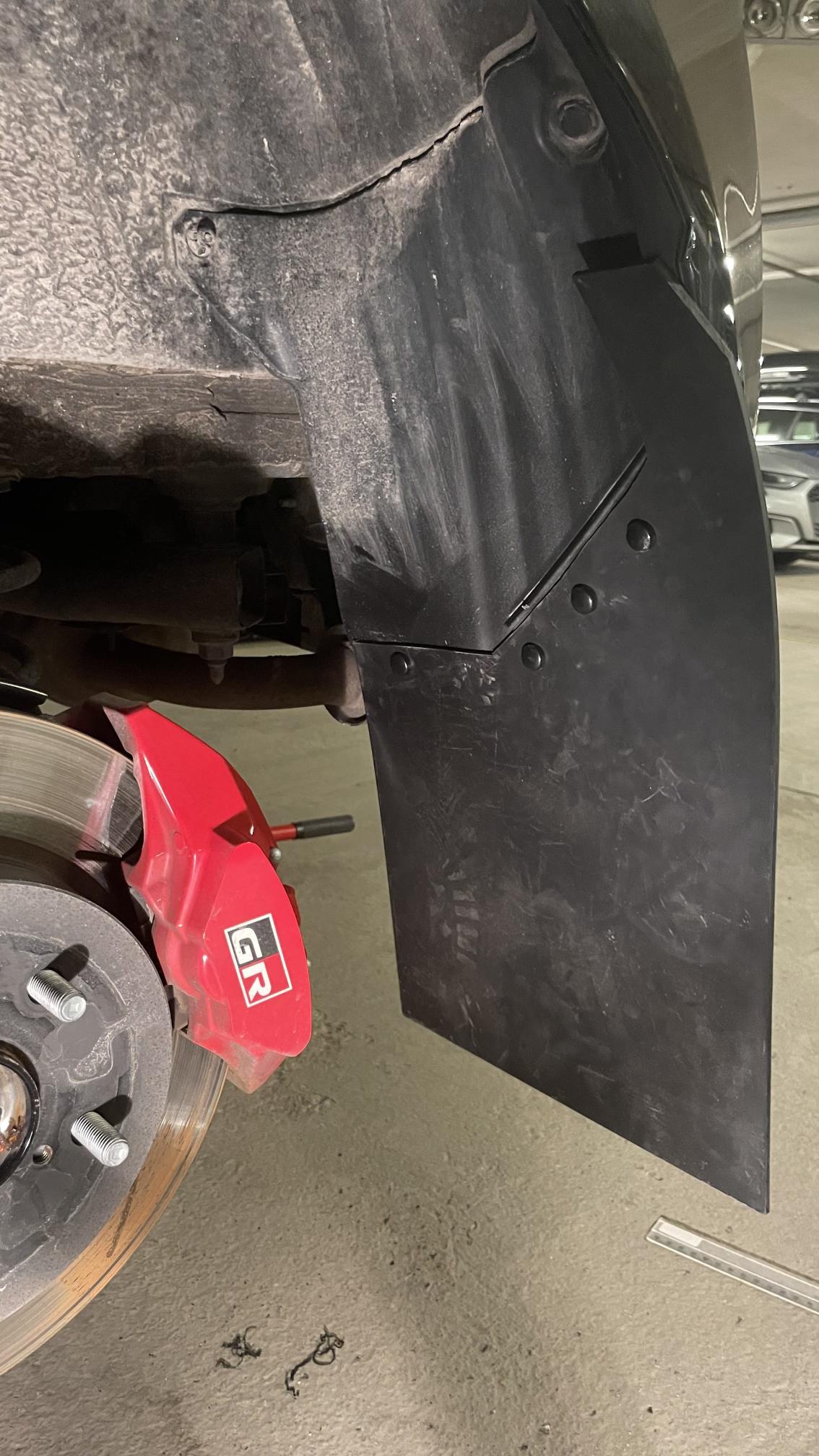

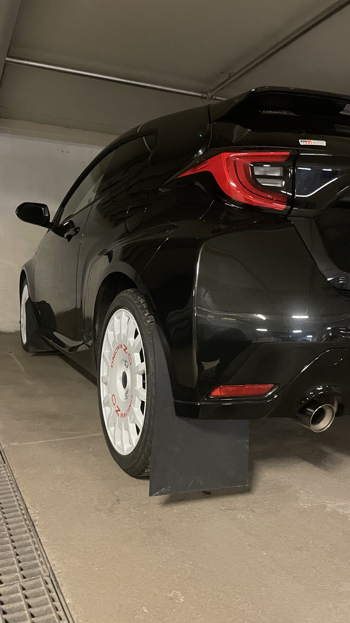

3 - Do-it-Yourself - After a bit of research online and on-site at Rallies, seeing what the "real ones" use and how, I bought two sets of flaps from an online store that sell Rally parts, 4 mm thick, 500 mm x 300mm. Heavy and sturdy indeed..! I cut them out, drilled and mounted in the existing holes since before. I made them wider than earlier Mudflapz in order to stop the gravel etc to hit the wide butt of the car. And it does work really well!!
I had to adjust the lengths of the rear ones eventually since they were dragging on the road at points..
Super happy with the result, function and look!
