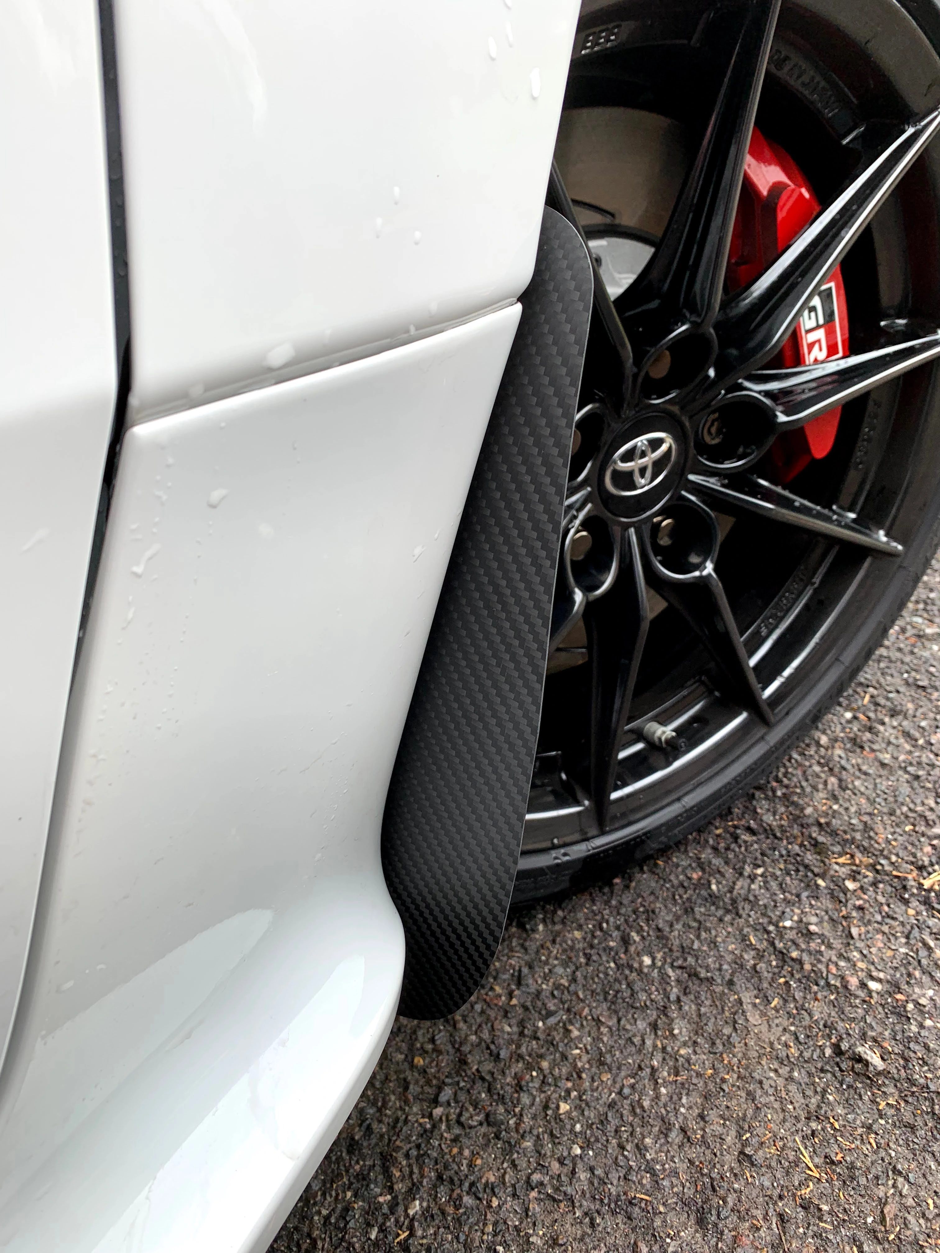

These are the smaller Rallyflapz (ShortieZ) in gloss black, front only.. Difficult to photograph on a white car in bright conditions due to the contrast but I like them as I’m not keen on the BIG FLAPS look but thought they’d give some rear arch protection from stones. They definitely don’t stop the sides getting dirty with spray due presumably to low pressure airflow along the flanks. So far no paint chips which is the reason I got them and I’m happy with the look.

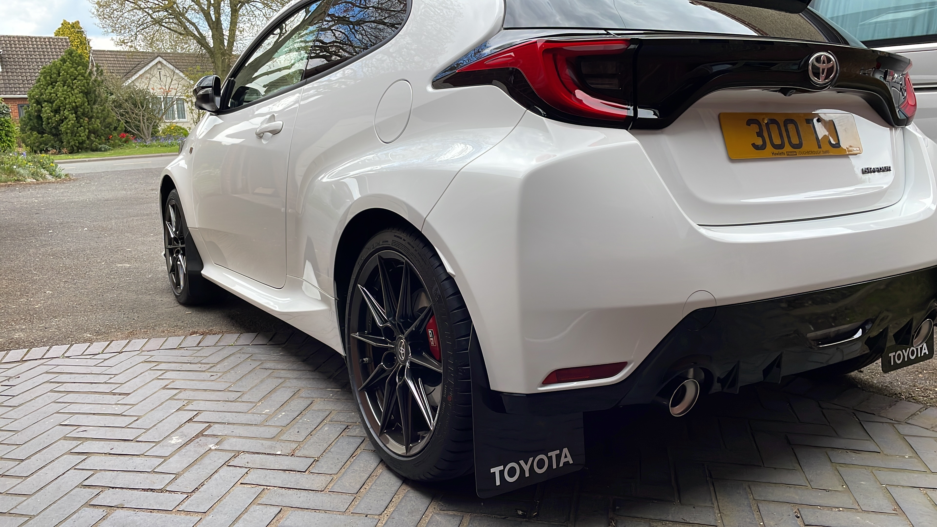

I've finally fitted my flaps
No more crud up the sides hopefully....

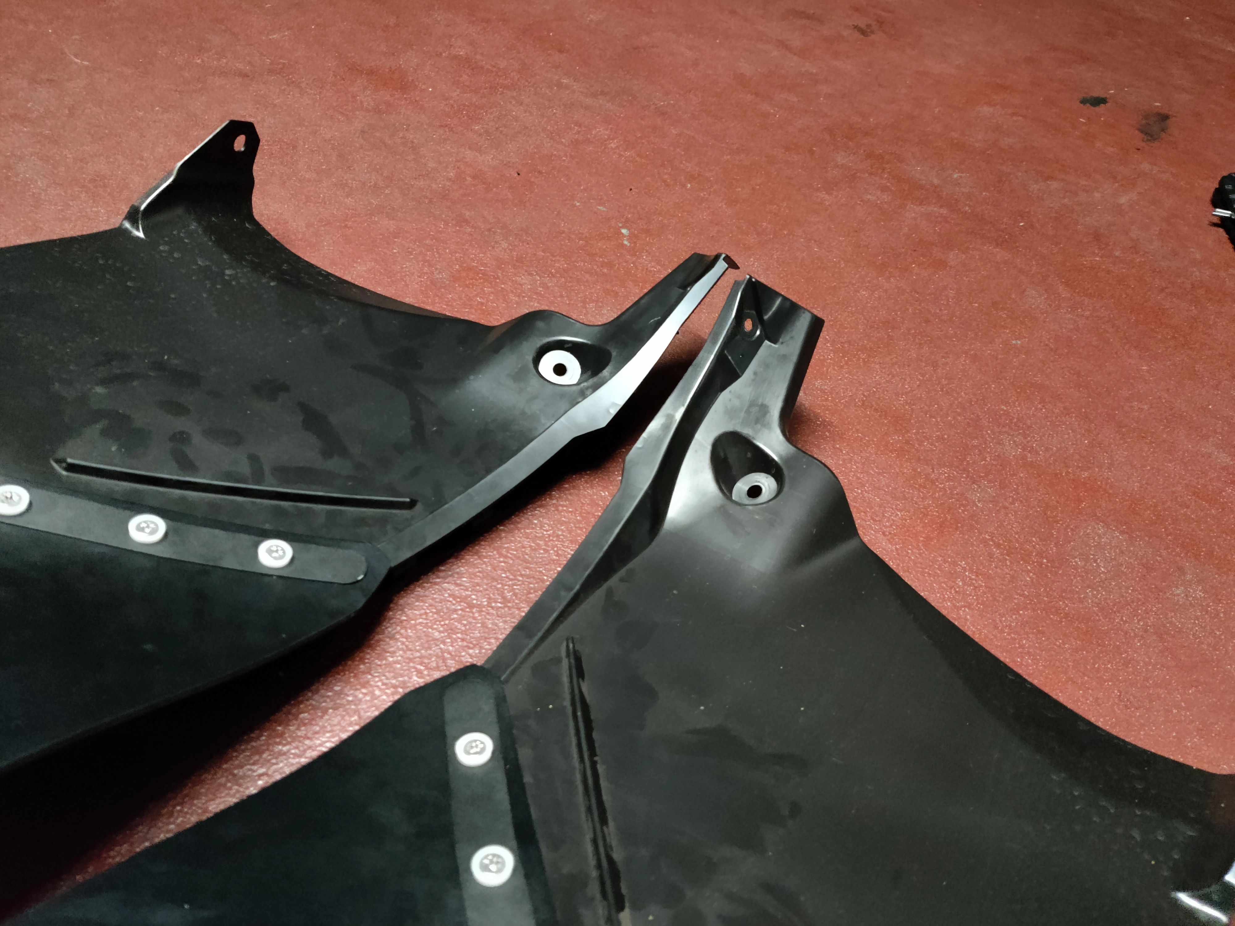

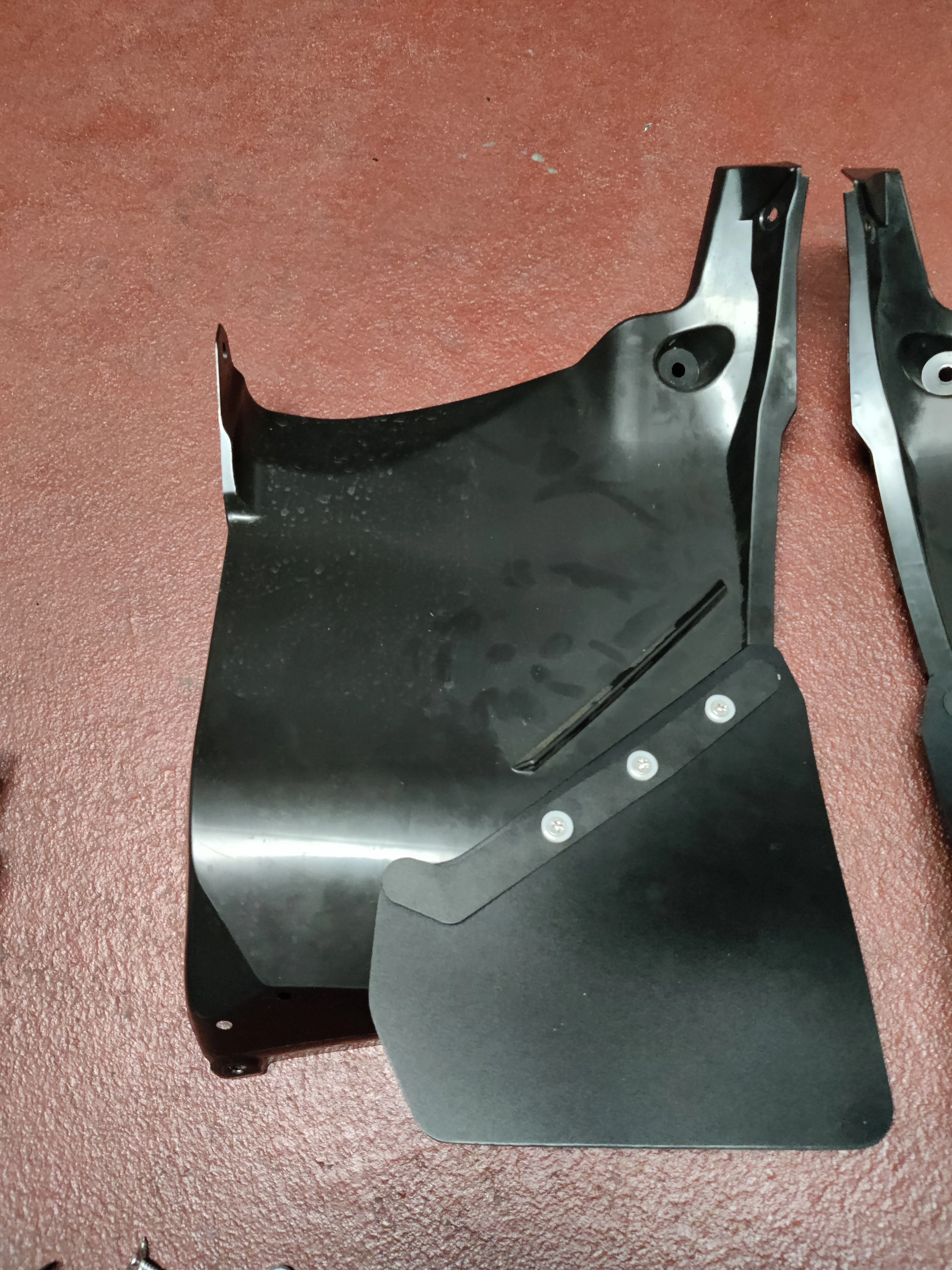

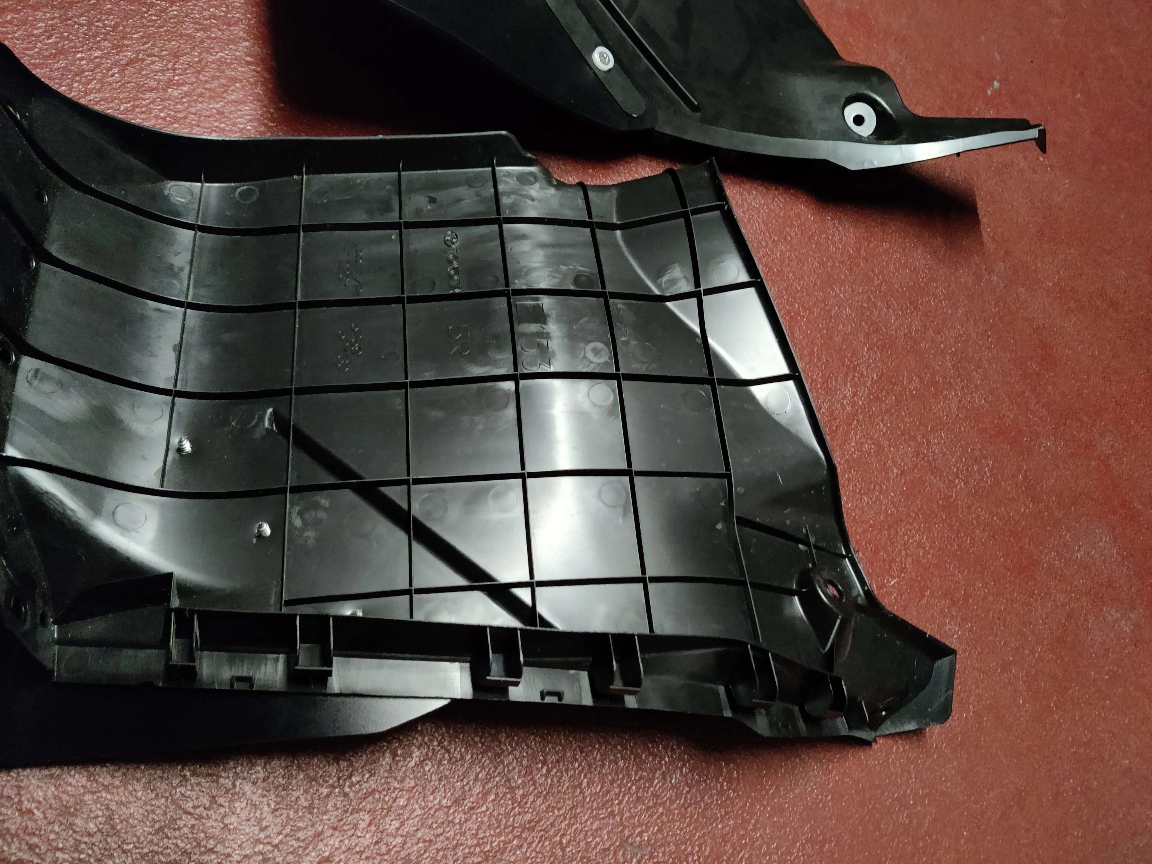

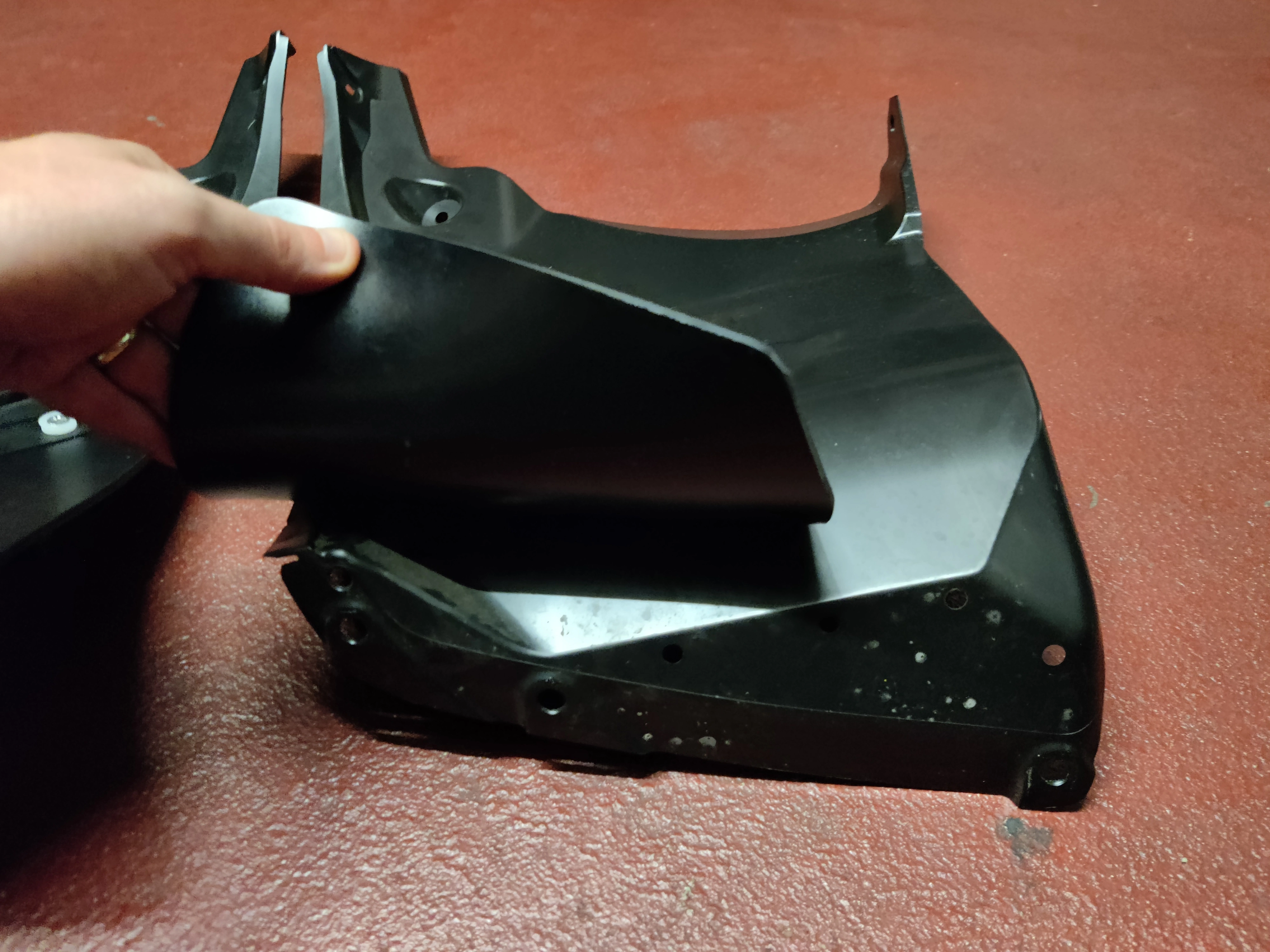

I'd seen advice on removing arch liners rather than removing the wheels and drilling in situ but not pictures, please see attached.
Take one side off then tape flap to the other side to find best location. Do first side (test fit if you want), then repeat on the other. So much easier to guesstimate when they're next to each other imo.
1 big attachment at the top, 3 at the bottom, a twisty one inside and a small fiddly one on the outer arch.
To remove the clips, from the arch, free the top or bottom and work your way down. It's much easier ln the second side.

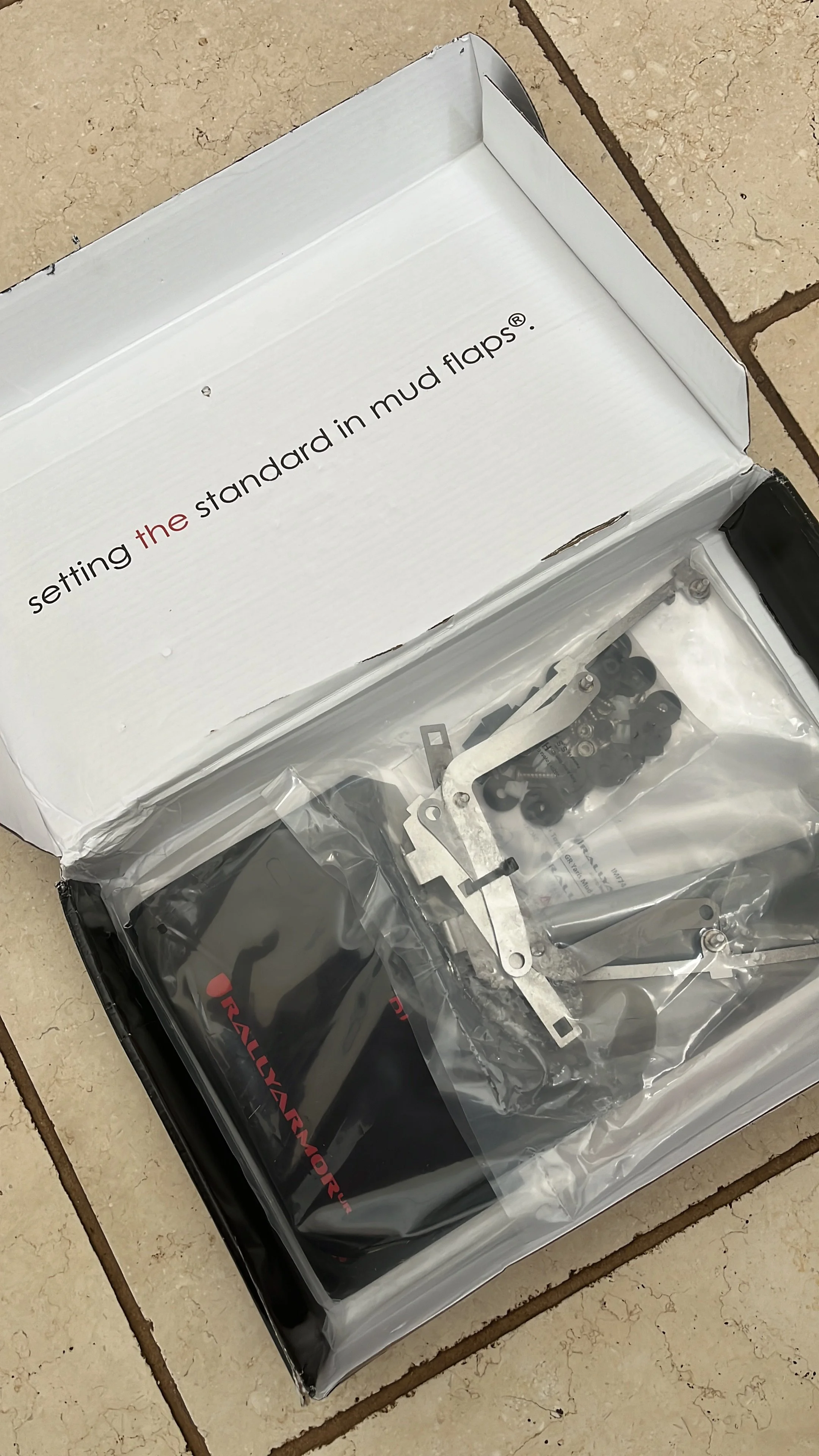

Rallyarmor for me … no drilling, no wheel removal and a red logo to match the car :cool:
