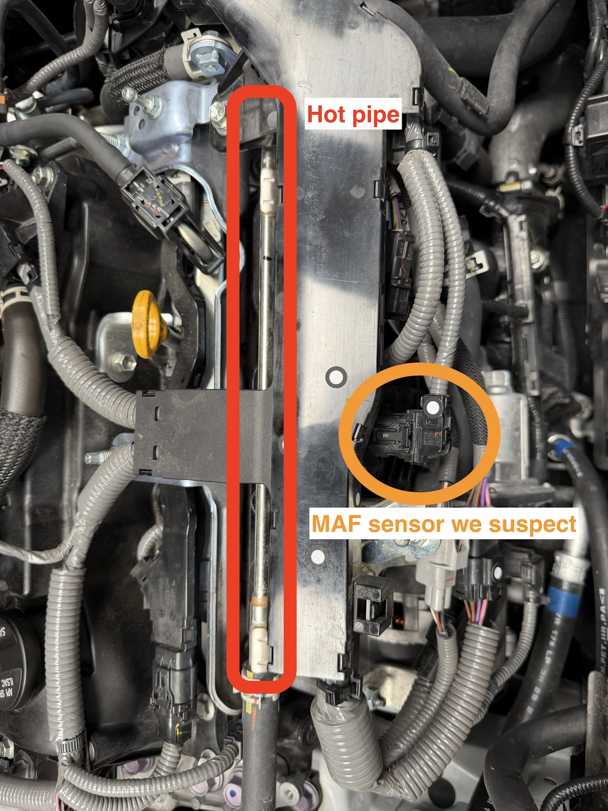

My car is on a stock ECU, no tune, but with an upgraded intercooler (AIRTEC) and the AIRTEC auxiliary cooler kit. One of my friends runs an EcuTek tune that supposedly addresses this, plus every cooling upgrade available, and he still gets the same issue (he even got it in his first heat after just driving to the track and standing for an hour in the pit with the car).
Our current suspicion is the MAF sensor getting heat-soaked: there's a heater pipe about 20 mm from the sensor that radiates heat onto it while the car sits in the pits. My next step is wrapping that pipe in insulation to block the radiation. I added a small heat shield next to it before my last session, and I've been using a leaf blower to cool things down before each heat, it seems to reduce the problem slightly and the car recovers more often, but nothing has been a 100% fix.
Has anyone solved this completely? Found the root cause? Any ideas welcome. 🙏

There was some talk about this in another thread that the maf sensor got heat soaked. Piras have a duct for this problem.
Yeah but the duct wont do much in the pits. Maybe it will help recover fast though. 🤔

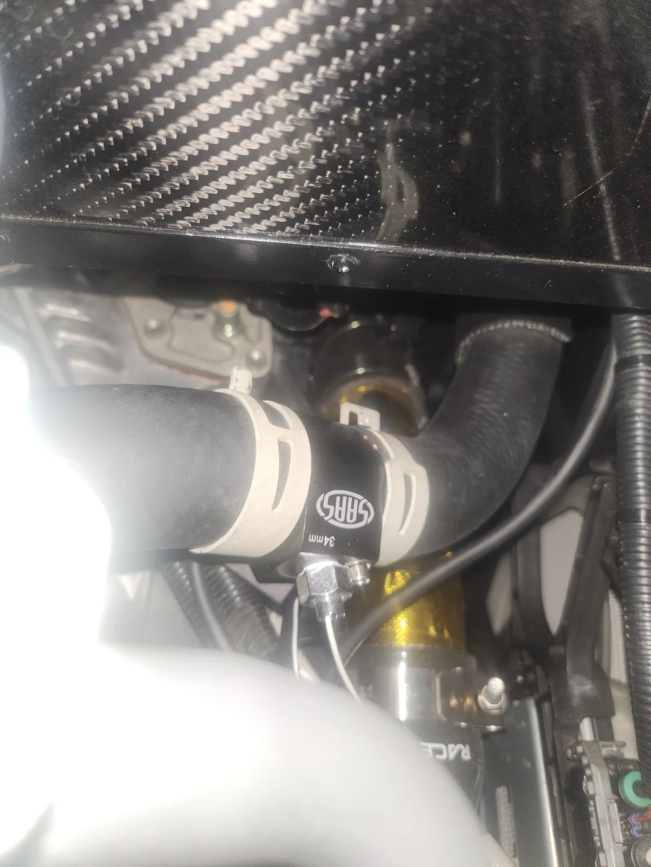

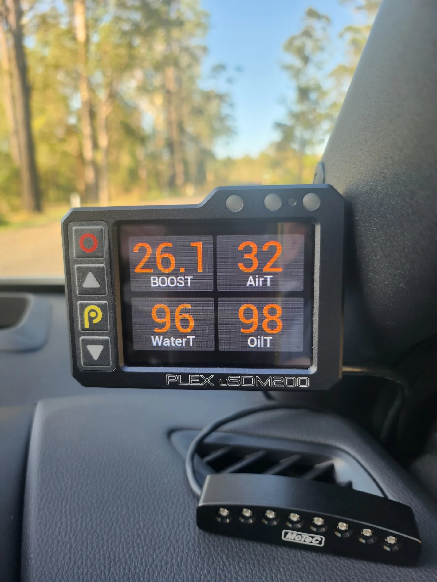

I measure intake temps using a stand alone set-up. I started by placing the sensor in the pipe between the IC outlet and TB. Cruising down the Hwy I was getting readings of 50-60 C°. This was purely from heat soak. I ended up repositioning the sensor to the silicon hose on the IC outlet.
I insulate this pipe now with reflective tape and the pipe to the turbo inlet.
Cruising down the HWY my intake temps are around 2 °C above ambient
Theres no doubt in my mind this vehicle suffers badly from heat soak.
