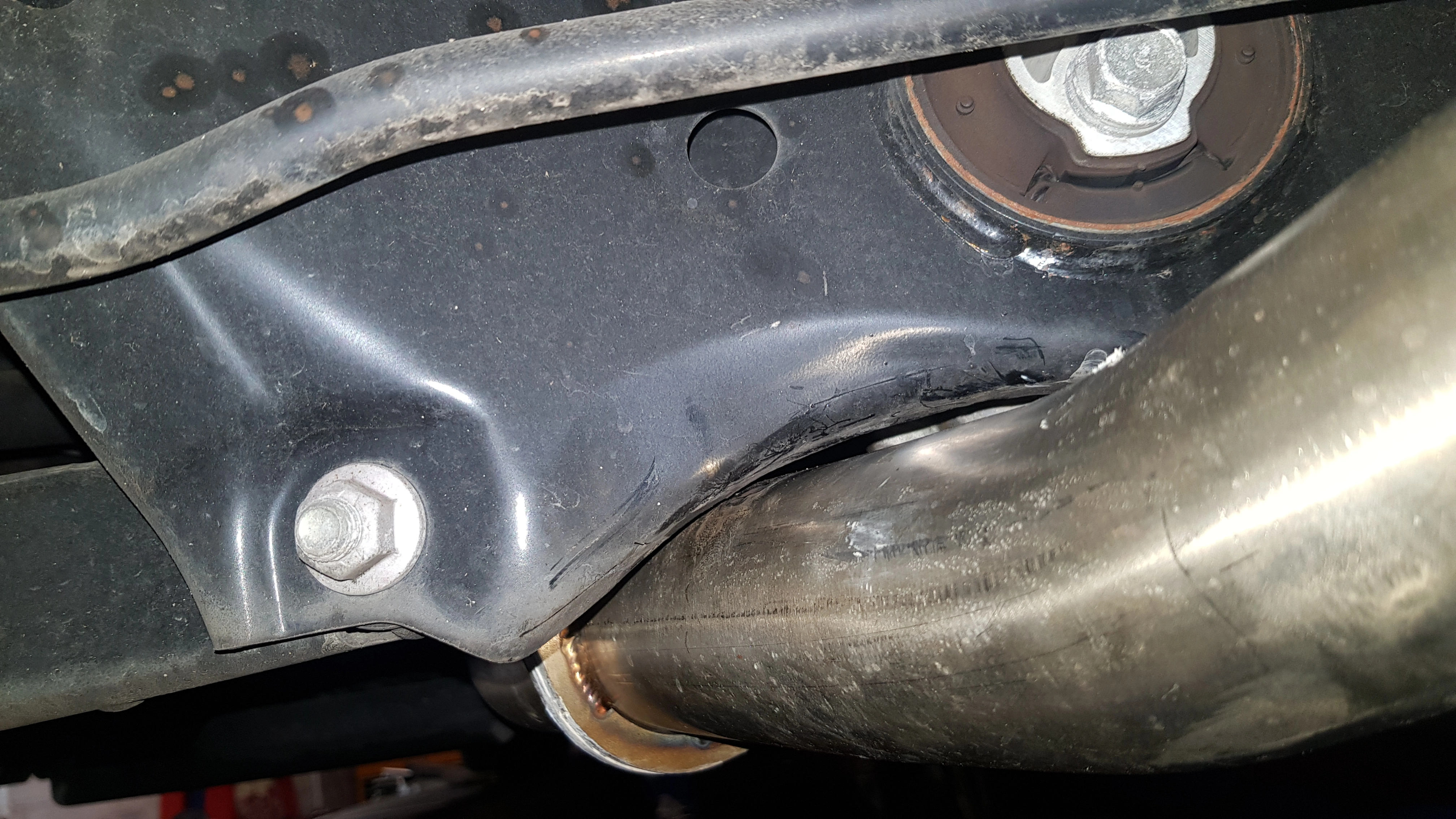

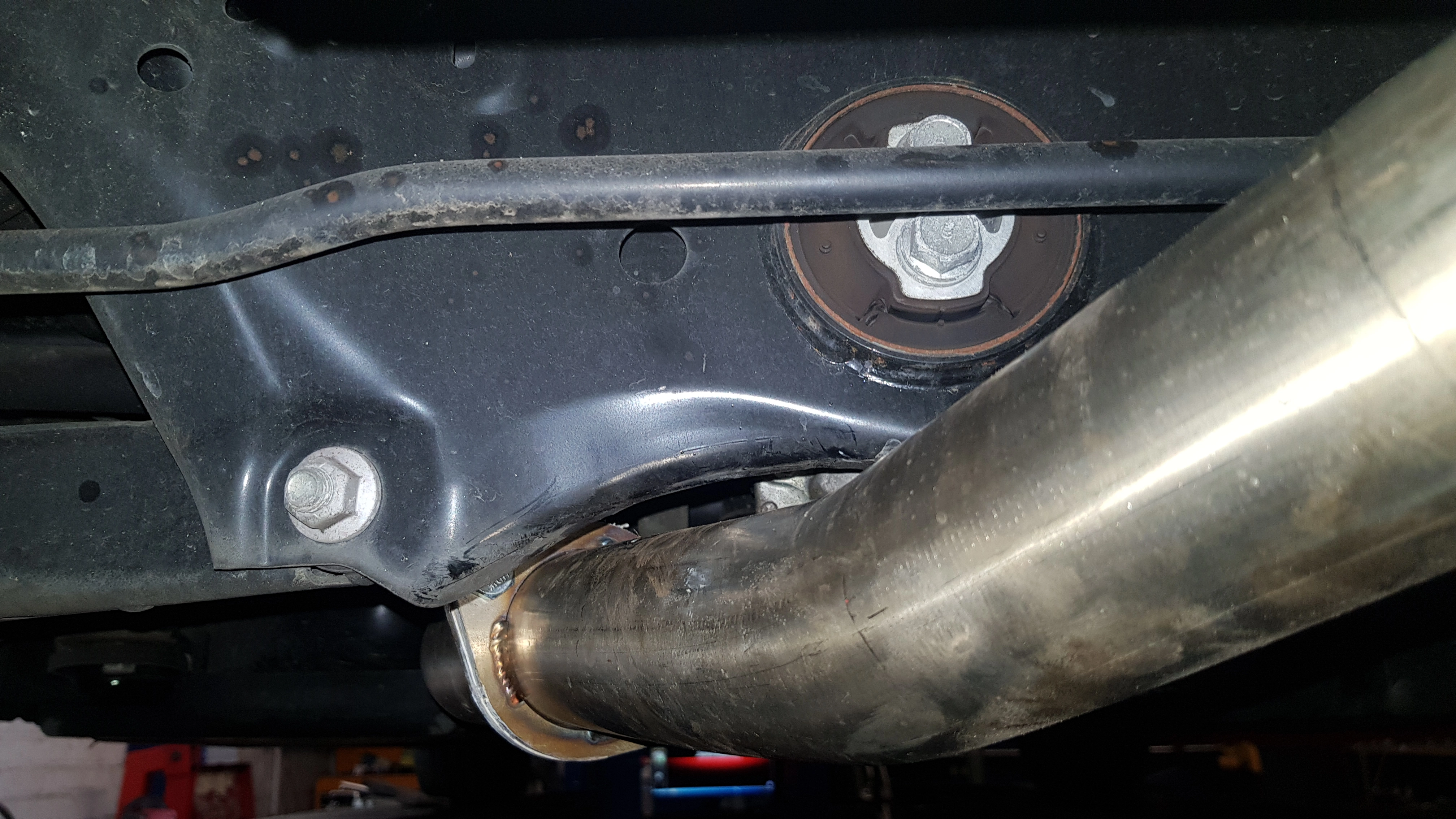

As someone seriously considering the same system, this is a disappointing update to read. I hope you get a resolution for the drone.Took the car back to the garage today for adjustment. The exhaust was too close to the crossbeam after it had warmed up and expanded. Then, when it wobbled, on acceleration or driving over a bump, it hit the beam making the awful rattle sound.
Everything looked very solid and no apparent leaks. So not sure what I can do about the drone around 3000rpm.
Will give Cobra a call tomorrow.
Before
After
