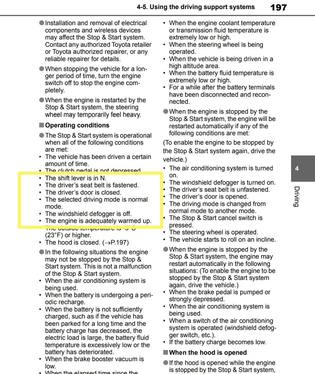

I want auto stop/start in all modes, with the option of turning it off off necessary. I often drive in track mode or sport mode, but have to change the mode from sport if I go into city centre driving where I want/need the auto stop/start. It's good I don't have to do it in track mode.
While the manual states that engine stop and start the system only works in Normal mode, it turns out that the system works in Track mode as well. It could be a bug, my rain bug is a special case.
I'd love it fixed if I could, but I'd rather have the dealer fix my blistered roof as soon as possible.
It's weird as it says it in the manual, but my start stop works even in track mode. I pretty much always have the car in track, and occasionally forget to do imt and start stop, and I always curse myself when I stop at the lights and my engine cuts out and I get the start stop message on the dash.
Yeah, the manual isn't quite right on this. The auto stop/start operates on normal and track mode. Only sport mode disables it by default.
I think everyone with the car experiences the same thing.
Me too. :ROFLMAO:
