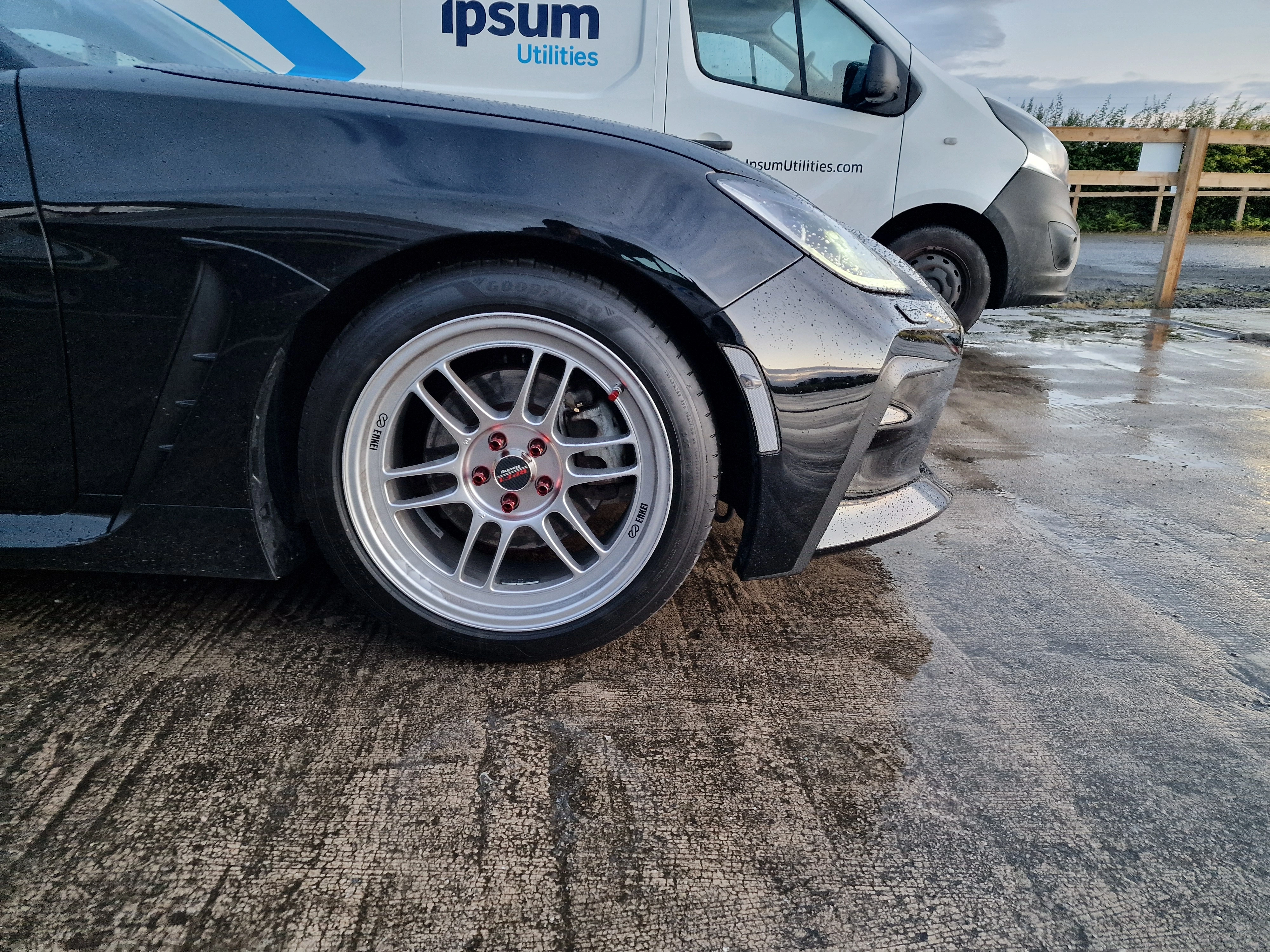

I'm currently lowered on KW V1s and on the standard drop links .
Here's a pic of the ride height.

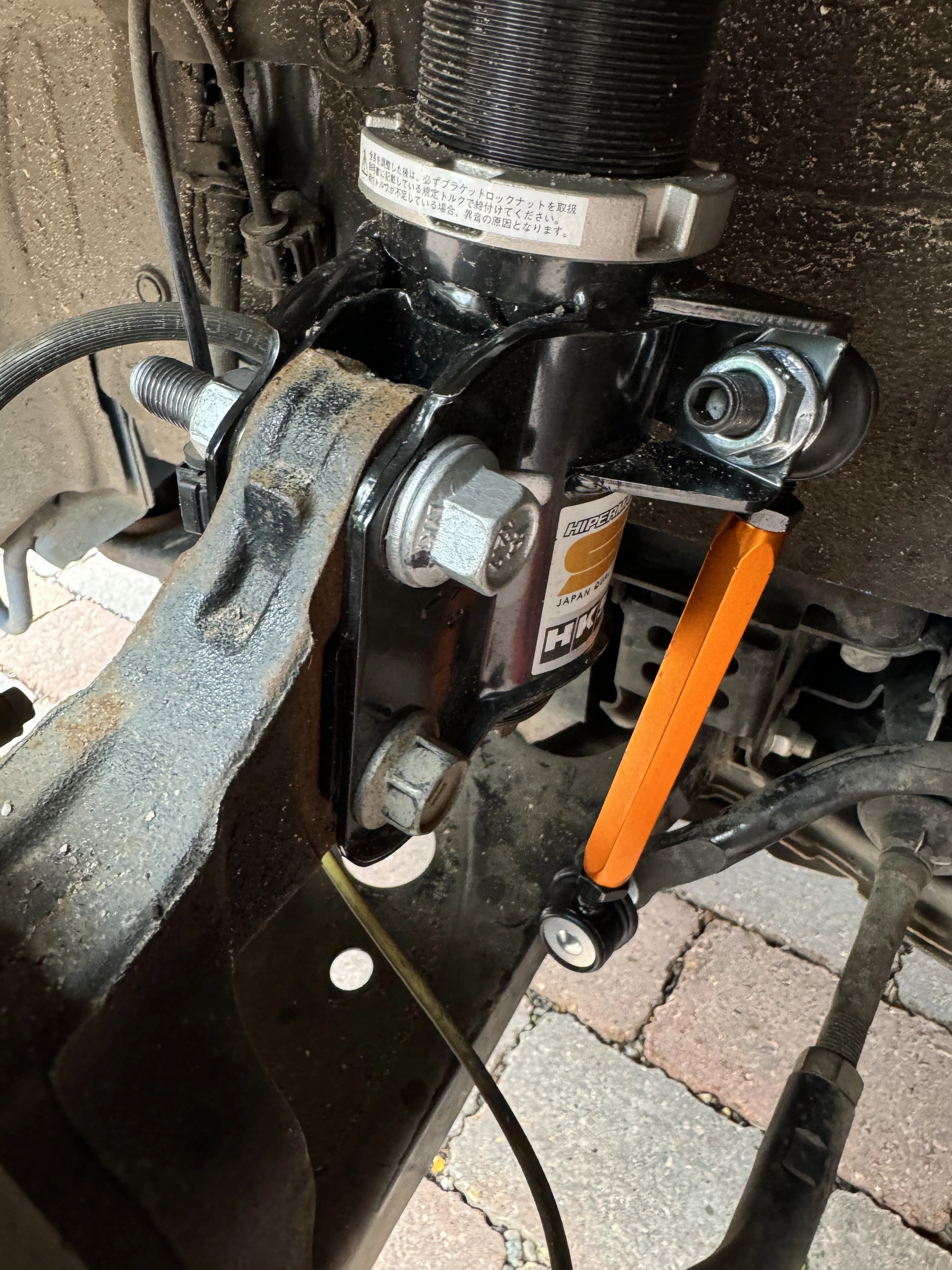

My HKS coilovers came with shorter drop links but it’ll depend on the specific design if they’re needed or not. Are there any witness marks on the lower arms?

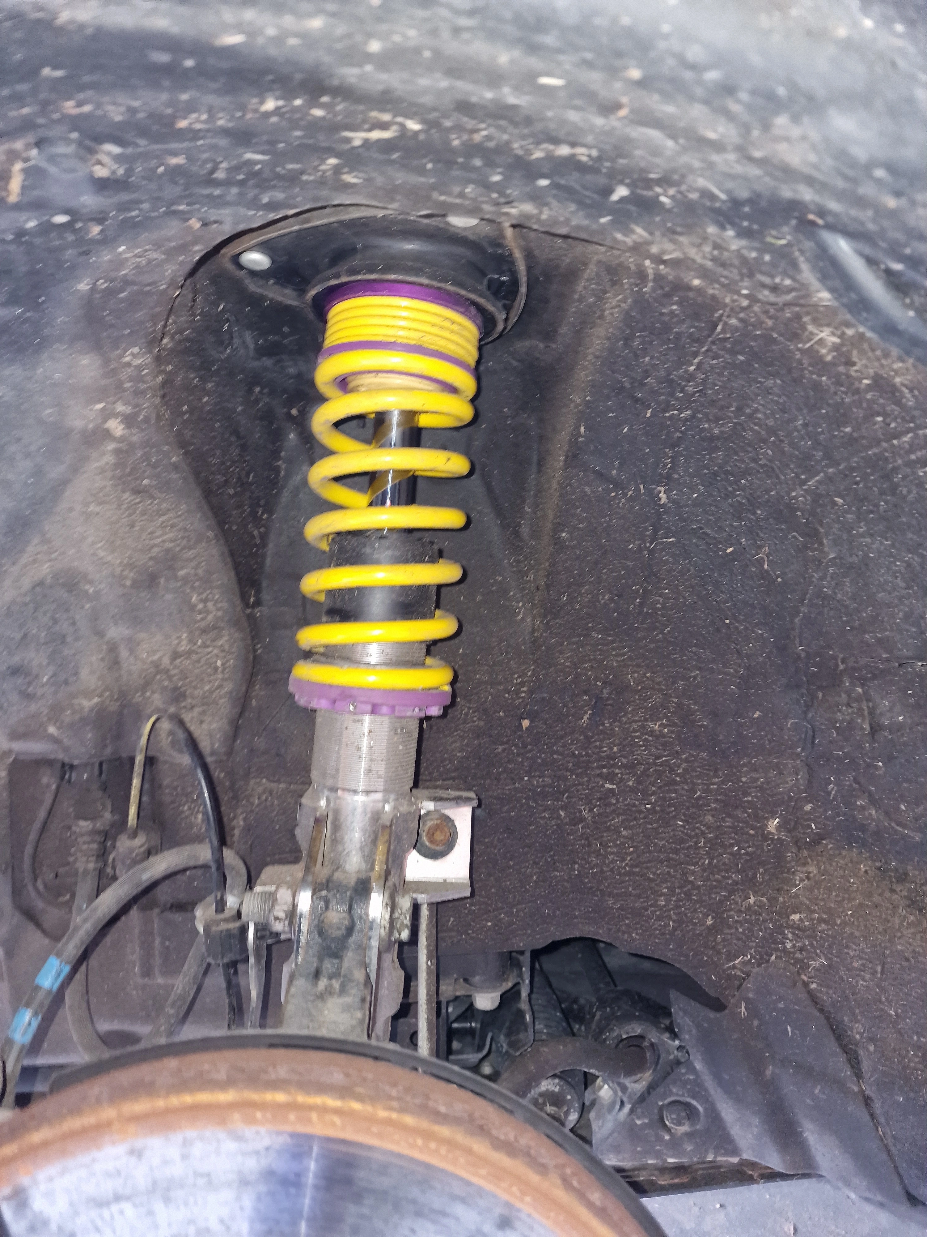

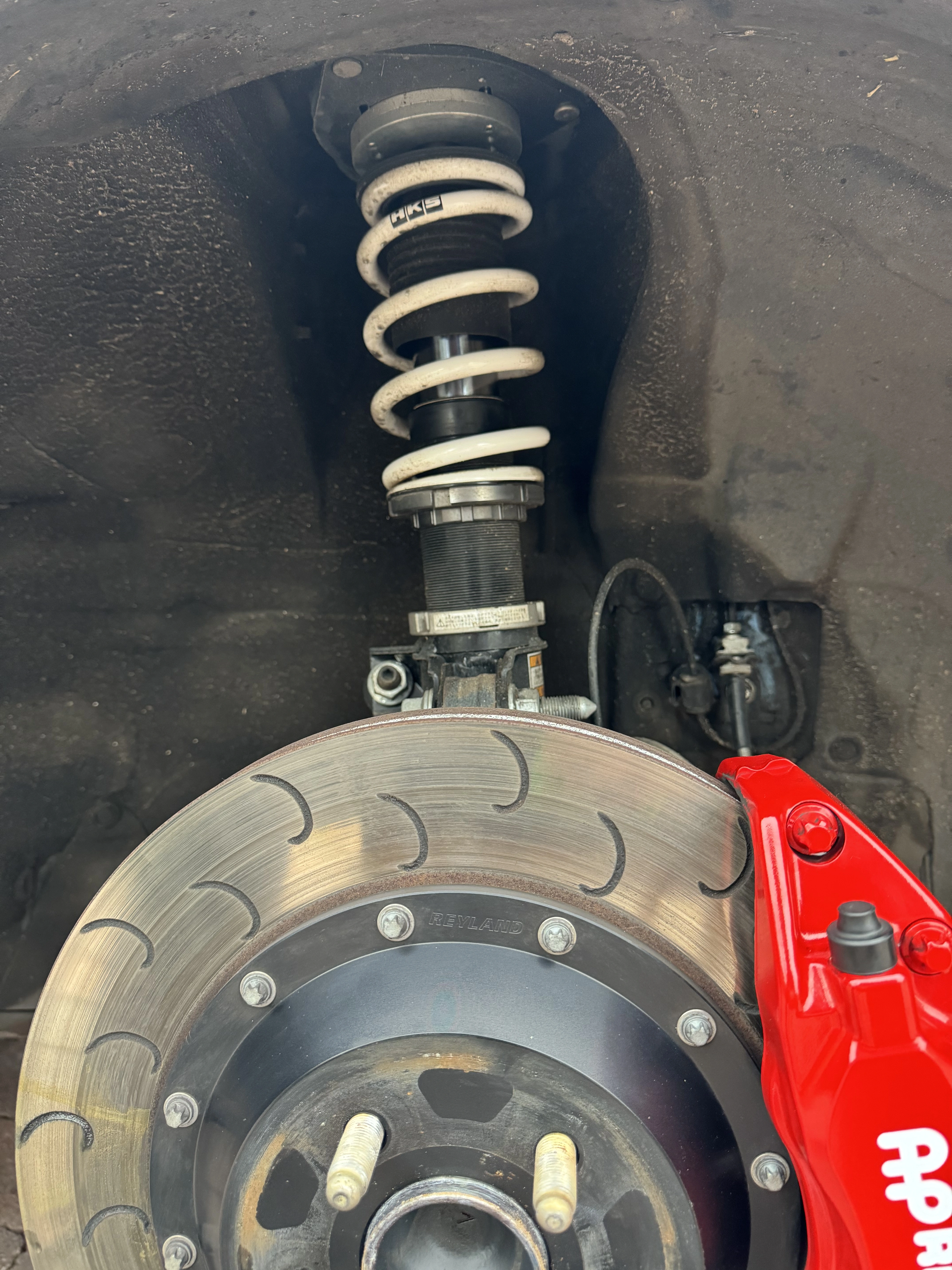

I think the clunking might be from the spring perch. It appears that the grub screw isn't really doing much so I think it's the spring twisting round when it's on full lock. I tightened it up, but I think the threads aren't holding up - the spring perch is plastic. It's better, but still sometimes a little clunking.
I noticed the helper springs are also basically useless at this ride height. This is on axle stands so full droop and they're still compressed.

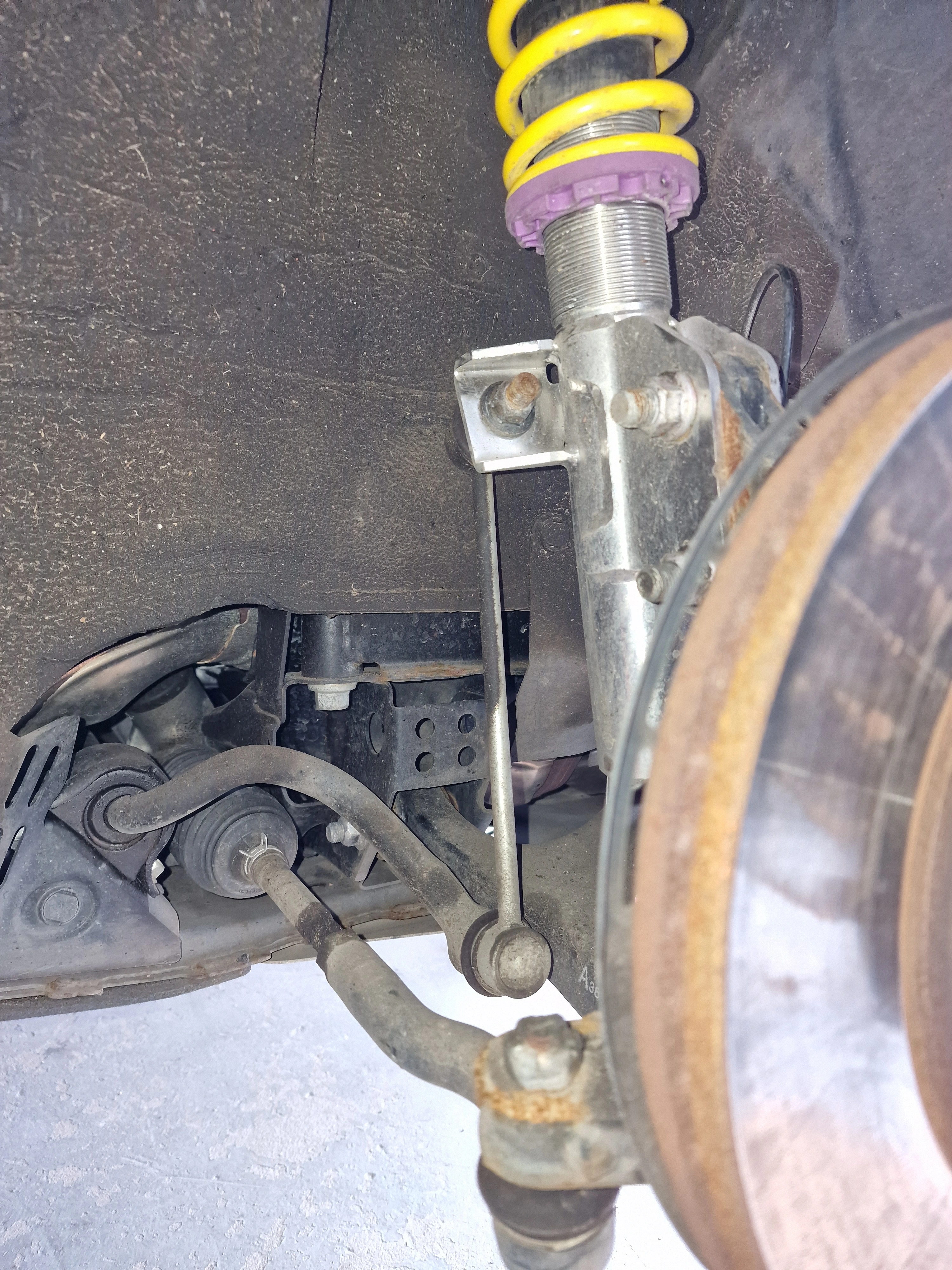

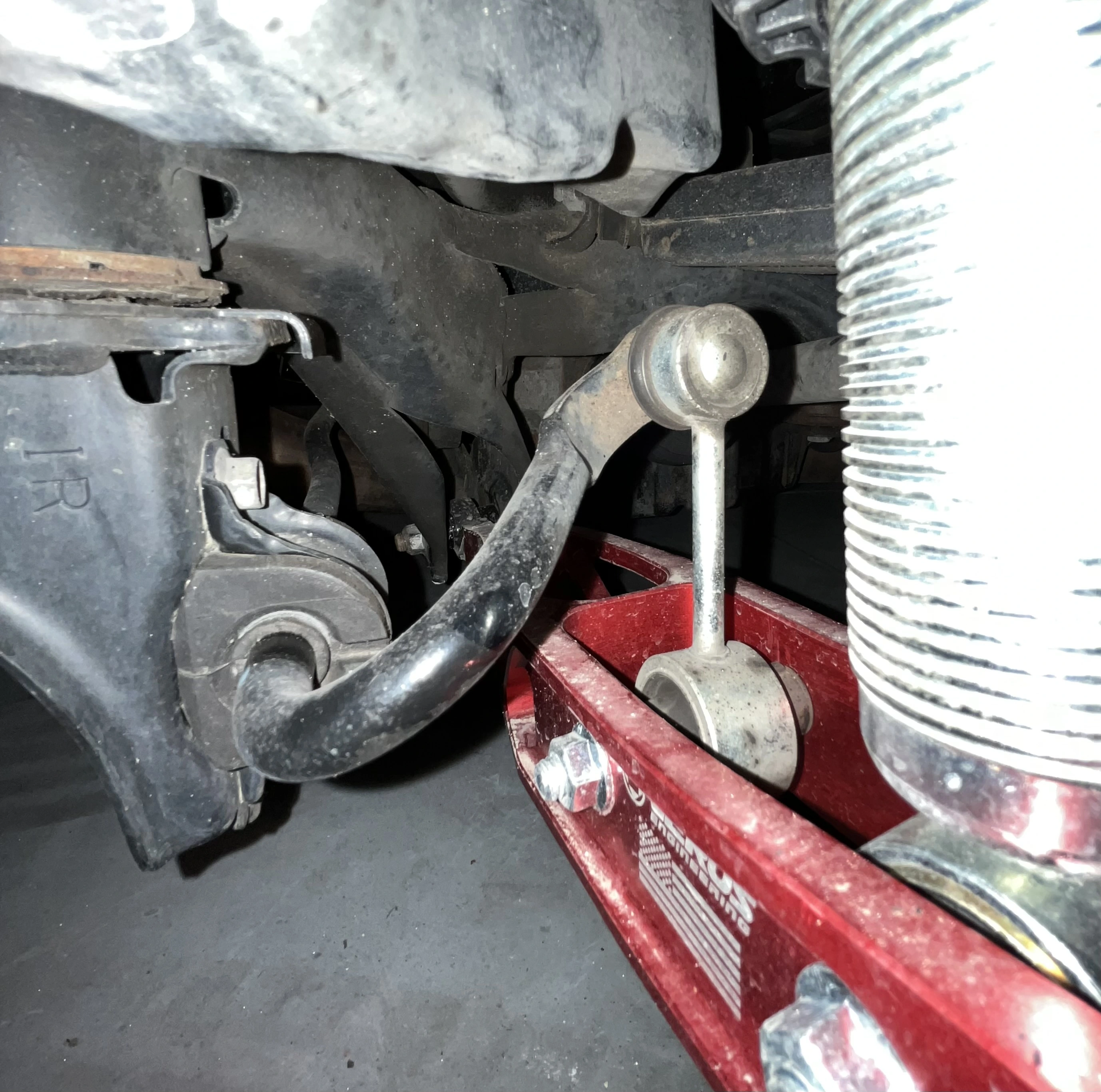

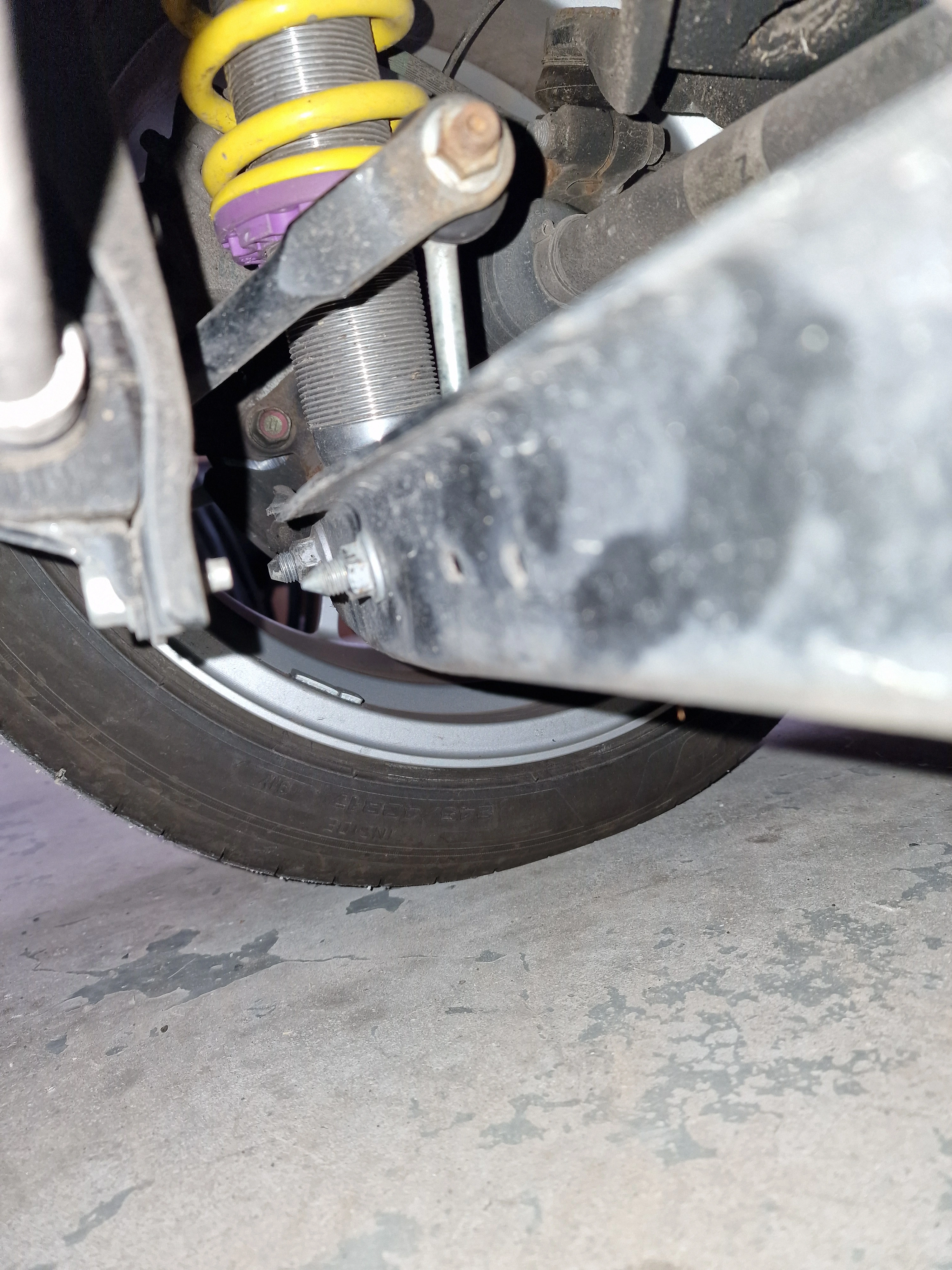

I couldn't find any witness marks for interference but took pictures of both the front and back ARB end links. What do you think about these angles?
Rear (loaded)
Front (on stands)

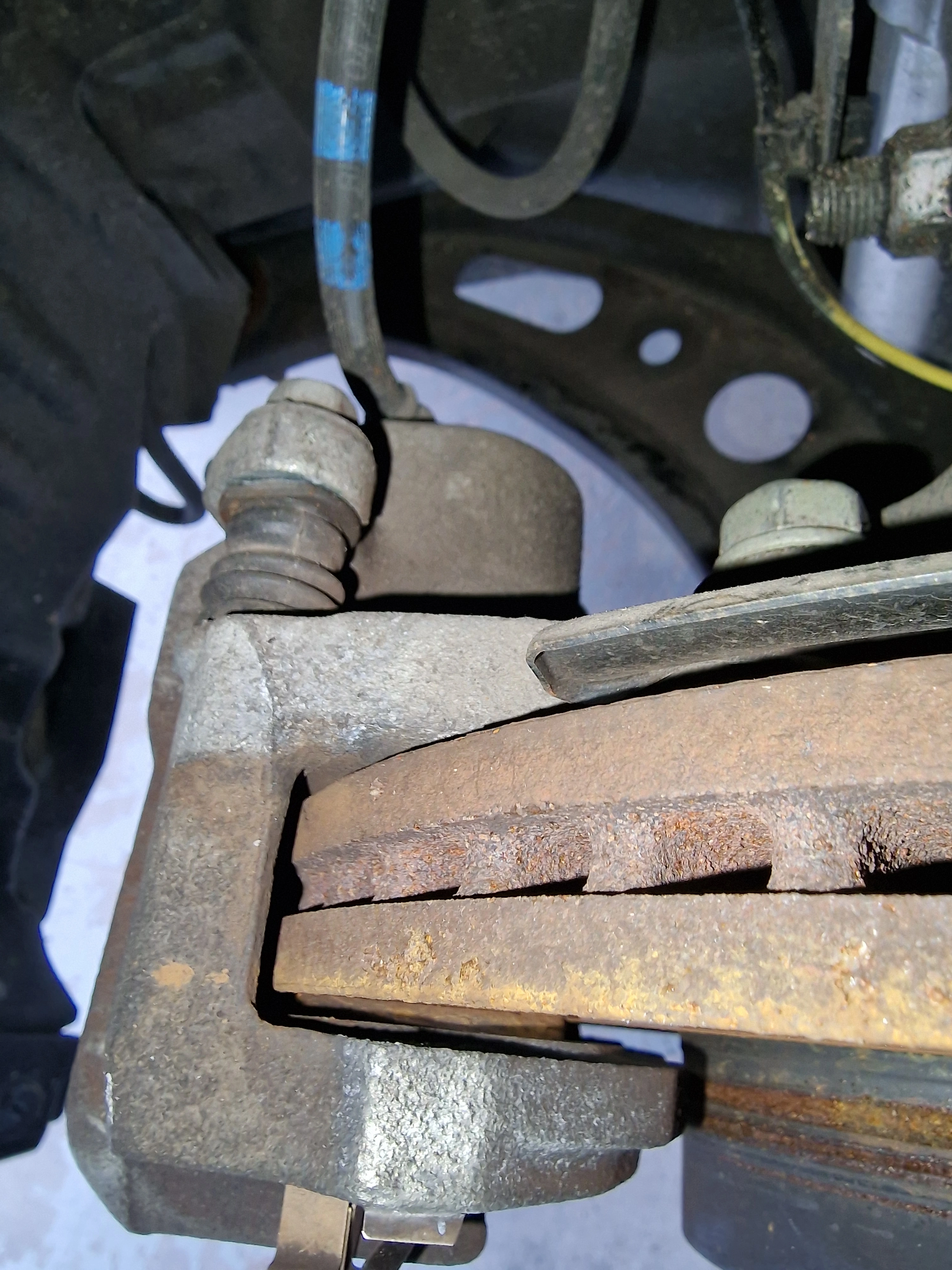

Also, I realised that my front pads don't have loads of meat left on them.
I did half a track day this time last year, in the damp and was careful only to do a couple of flying laps each time. I guess it's true what they say about the stock pads being no good for track work 🤣.
the disks are fine so i think i will just pads this time around. Looks like the BBK will have to be next time around.

For comparison the HKS ones have the lower hub flange portion threaded. The kit only uses helpers on the rear though.
Above is my drop links, they look slightly shorter but if there’s no marks and everything is tight I doubt that’s the issue.

Had same “problem”, sounds like binding from roll bars, but also I’ve been told the KW coilovers are on the loud side which is expected.
If you want to improve the clunking, consider shorter rear anti roll bar end links as well as fronts.
For rears, there isn’t much of an option. If you don’t want to introduce more noise, choose these:
They retain rubber bushing but will fix rear geometry.

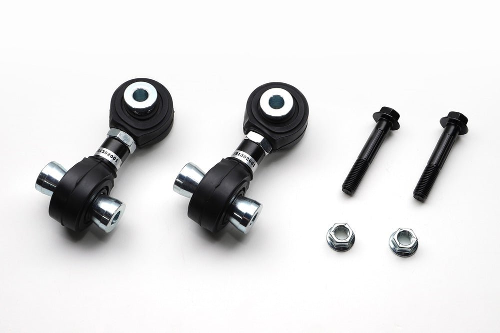

If you don’t mind extra noise, then revolution have GR86 specific product:
This needs to be combined with:
I have BRZ (slightly different mounting for rear roll bar) and this is how it looked without revolution end links (it looks a little different for the GR86)
In my case, it was even difficult to tighten the end links as they’ve been preloaded already. No issues with revolution end links, except it’s all metal so transmits more NVH.
For fronts you can use anything that works for first gen as mountings are the same. Consider hardrace as it’s cheap and available in EU.

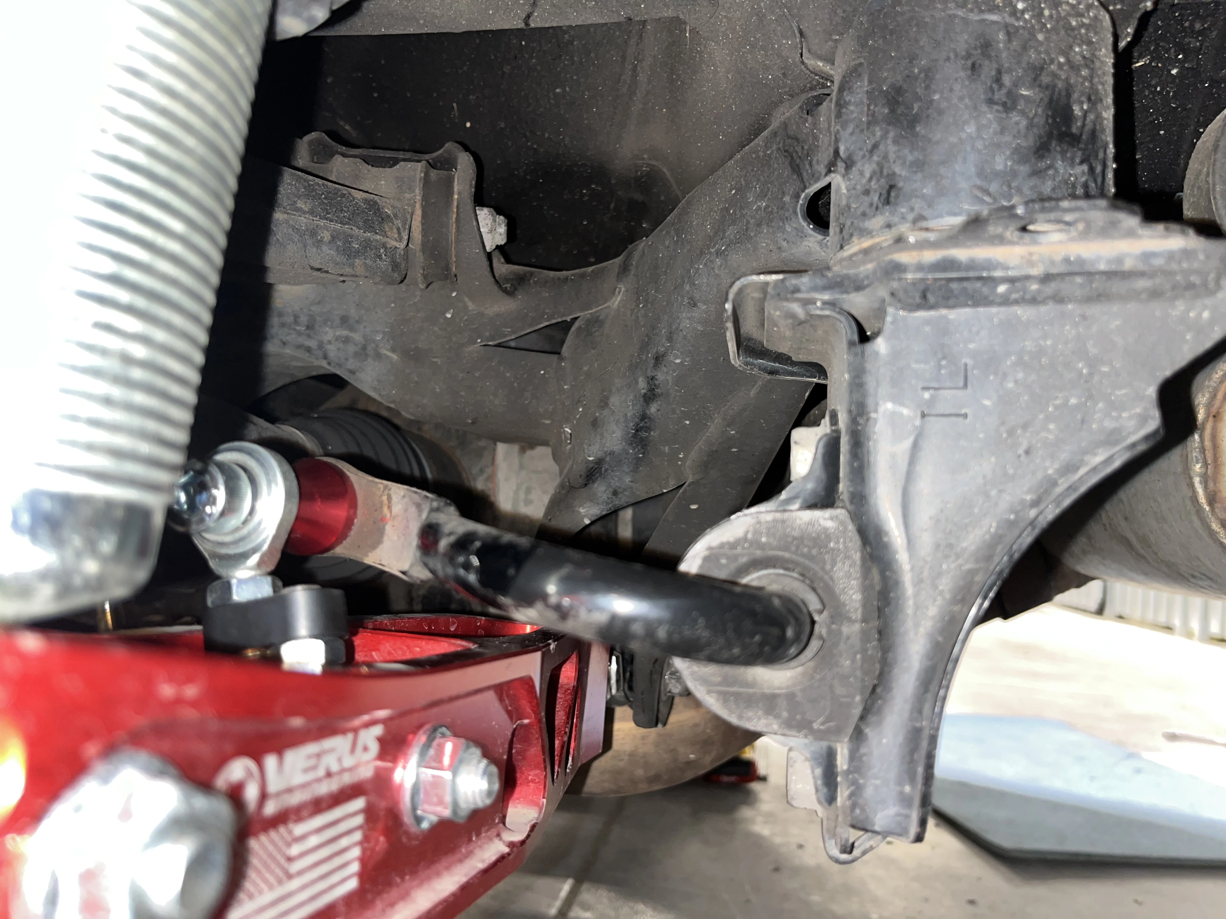

I have BRZ so I could get away with just a revolution rear end links.
It is still a bit angled but no force is being applied and sway bar can move freely.

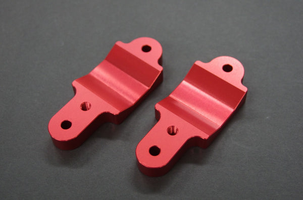

On GR86 on the other hand, there is improved version that looks following:
You adjust the position of mounting brackets by going upwards and then use shorter end links:
These should also work if you are worried about too much of a NVH from revolution end links. Given your use case, I'd incline to revolution relocation mount kit but first I'd bought the Blitz rear end links to see how sway bar will settle with your setup. It might be that it will be short enough to remove the binding on the ARB.
