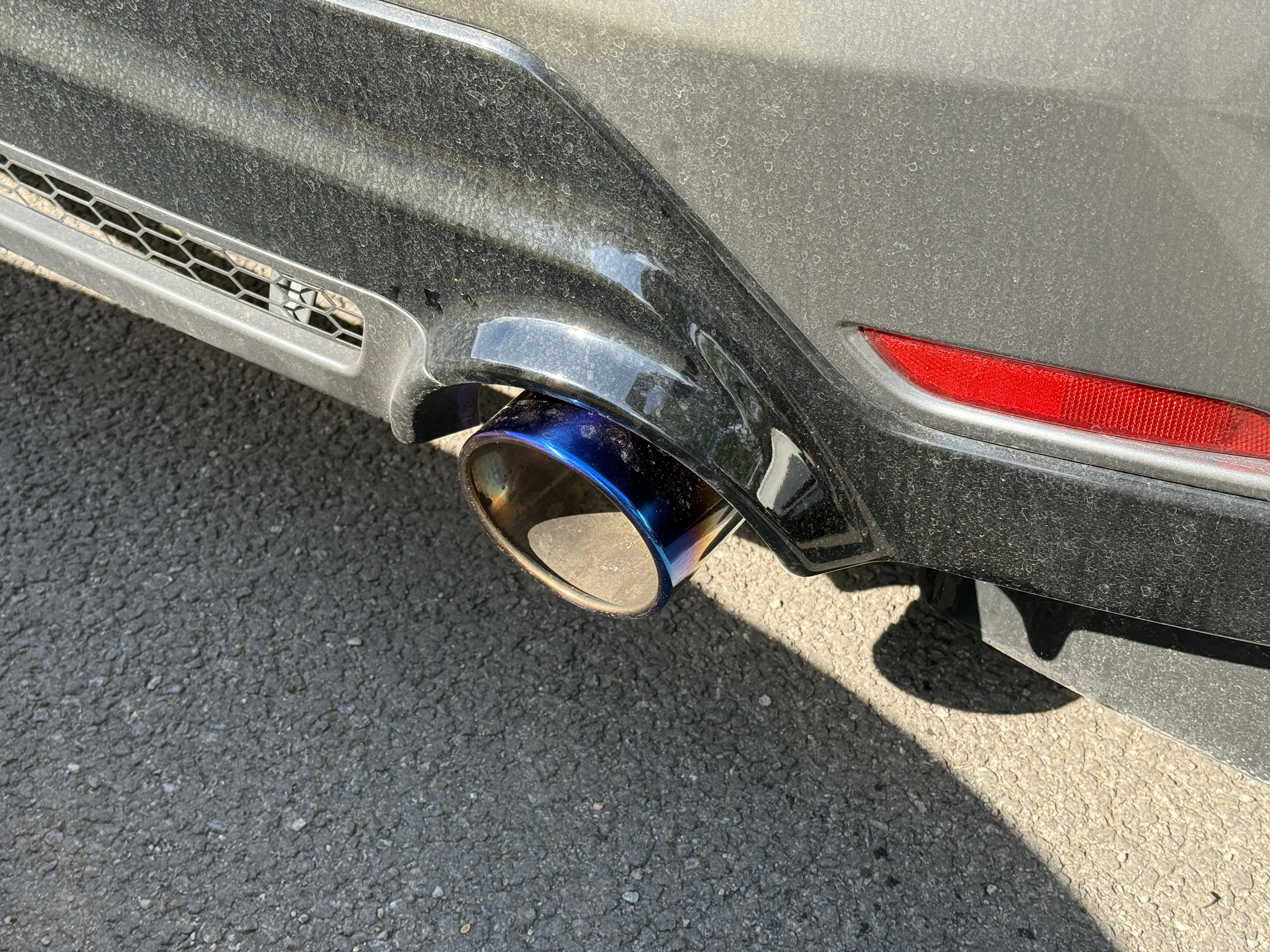

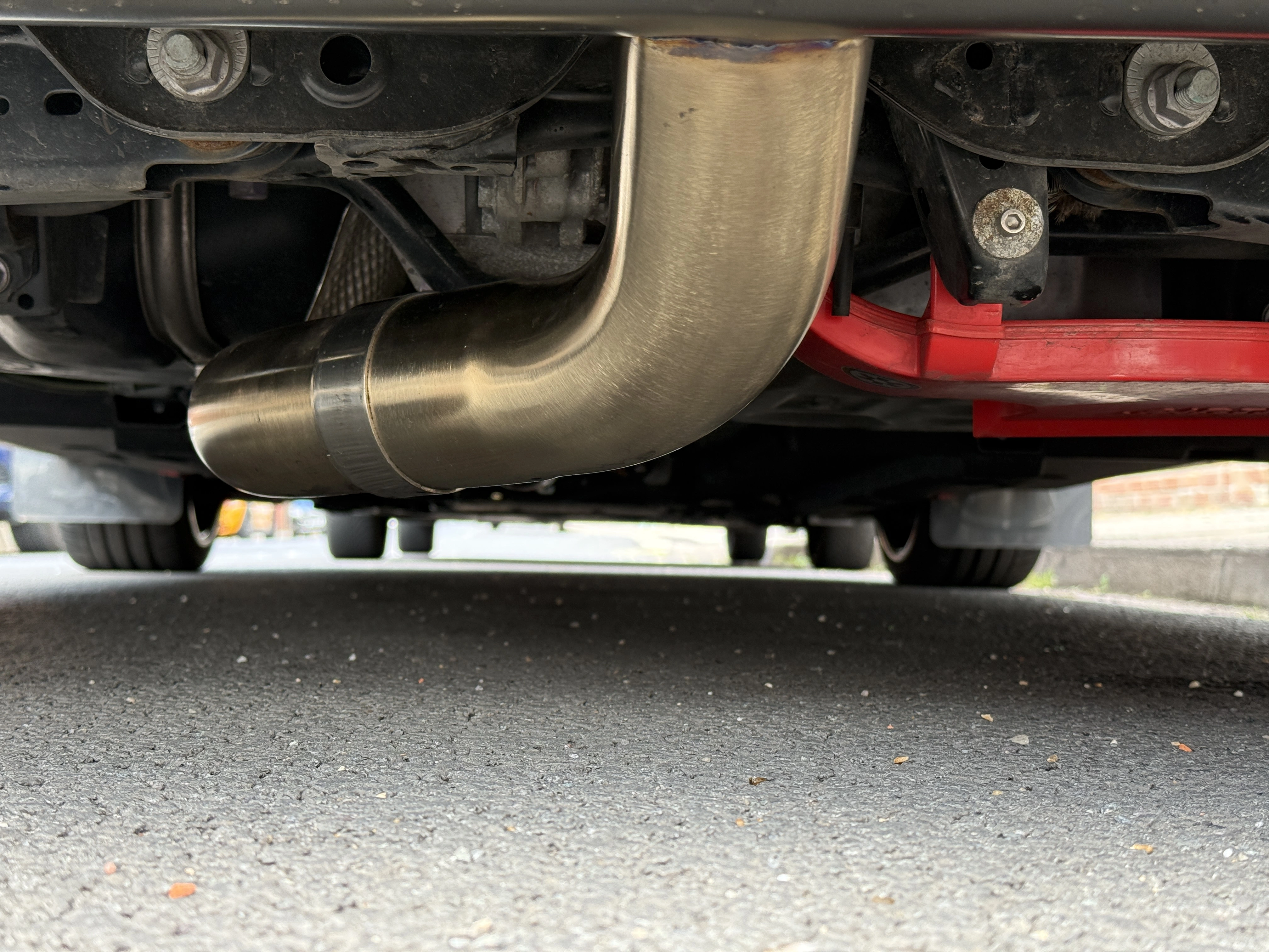

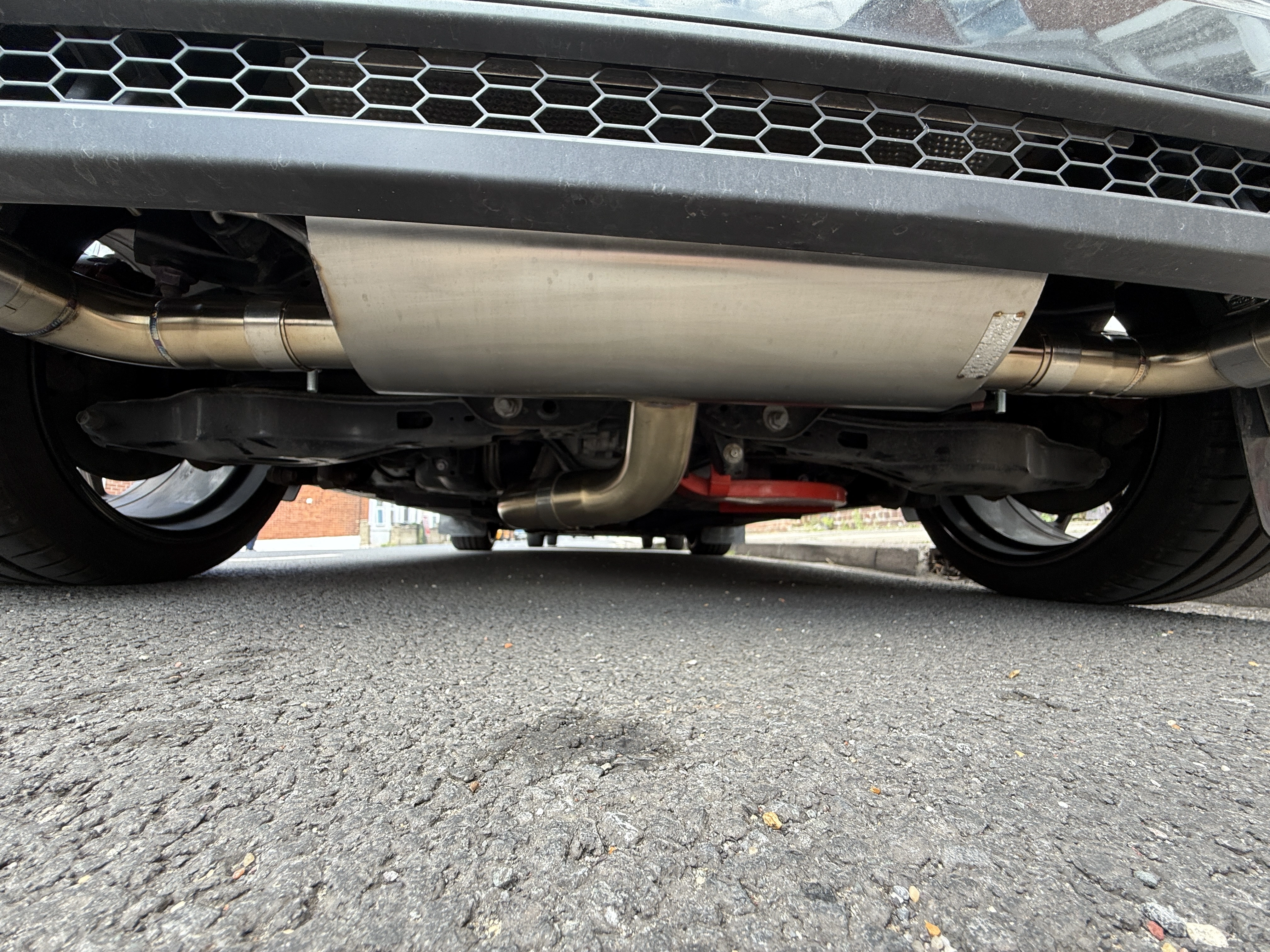

Hello. I just installed Akrapovic slip on exhaust system. For me I want a little bit extra sound. Therefore I’m thinking about adding some sort of OPF/GPF delete like Eventuri link pipe (so it would fit my Akra slip on).
Can anyone share their experience if you needed ECU remap after adding this? Any fault codes or check engine lights?
I don’t want to do remapping as it would void my warranty (according to my dealer).
Akrapovic representatives themselves told that this is luck thing if ecu remapping will be needed or not. Thanks for your help!
Might be that the Akrapovic rep is right and in your case there might be erros. But usually you can install the Akra Slip On with the Link Pipe without any issues. But its going to be loud. :D

Update: so far no error codes. Sound is more deep and louder mid-high revs. 👌also more pops and bangs 🍾
