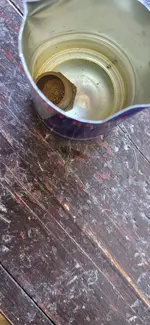

Just to add, removed Airtec catchcan after some 20.000km. Checked the dipstick few times before, hardly any signs of oil, but never opened the can. Now with it out of the car, I've opened it and found around 1dl of waste in it, but what shocked me was the filter cap was also in the can. Fully blocked with waste. My assumption is that is got blocked and unscrewed itself under crankcase pressure.
On the photo, the cap has already been cleaned a bit and is soaking in medical benzine to try and clean it.
