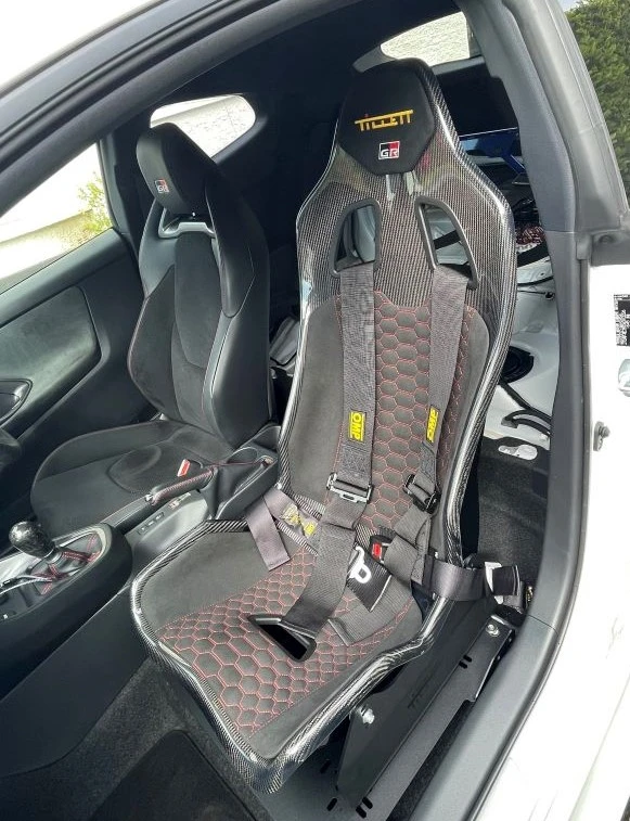

I forgot to add yesterday, for anyone wondering, I make these about 5.5kg each. Obviously there’s some seat brackets/frame to go on. Not sure how heavy the stock seats are. I will try and weigh everything when I get around to the installation. I have some black 3 inch OMP harnesses to compliment them.
Annoyingly I had the wrong base for the drivers side, so I need to wait a couple weeks for that to be delivered. I made the (correct) bases and brackets to be comparable in weight to the stock seat brackets, so I'm pretty confident these work out between 4-5kg lighter per seat fully installed. Pulled all of the original belts out of the car too. I went with some comfy OMP four-points.
Next on the list, Rally 1 style bonnet vents..
Annoyingly I had the wrong base for the drivers side, so I need to wait a couple weeks for that to be delivered. I made the (correct) bases and brackets to be comparable in weight to the stock seats, so I'm pretty confident these work out between 4-5kg lighter per seat. Pulled all of the original belts out of the car too. I went with some comfy OMP four-points.
I had the chance to sit in some Tillet seats for the first time on Sunday and as I had read several times, they are very comfortable, which is slightly at odds with the stripped back look. Yours looks ace, especially with the CF weave 😍. Drivers side will finish it 👌
