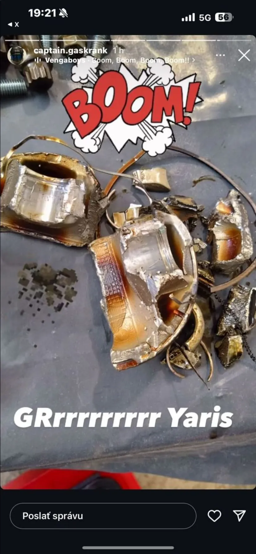

Another piece of the puzzle. Piston from a GR Corolla engine that failed in the US.
Even at this point, after 3 plus years since it was released, it still seems that even EcuTek hasn’t discovered how all tables work and for repeated track abuse is better to stay on stock map, to be on the safe side of things…
somewhere from the interwebz, do not know any details
That’s Captain Gaskrank who does lots of Nürburgring vids. His insta is private rn though.
Seems the piston has disintegrated, hardly that's an oil starvation problem.
Edit: change of mind 😀 If the oil squirters weren't doing their job or if piston was dragind along insuficiently lubricated cylinder wall and heating up, it definitely could have helped to start LSPI/detonation.
When the GR pistons fail the above mentioned picture is often the outcome (shattered). Need to check if i find the source why (material composition if im not wrong).

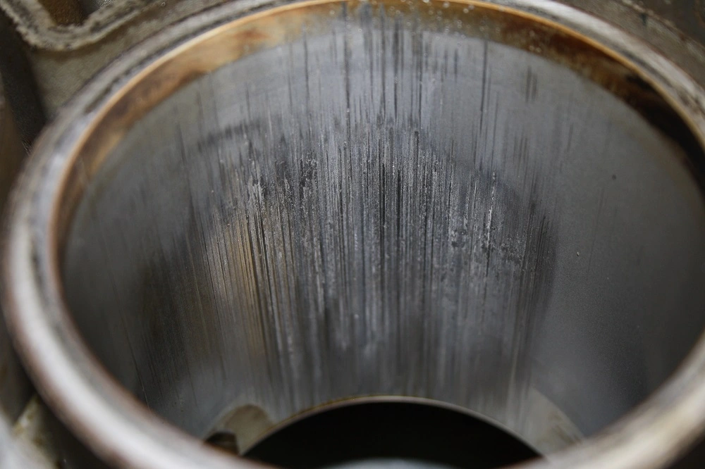

I appreciate your analytical thinking, but I highly doubt that’s the actual cause of the engine failure. Here’s why: insufficient cylinder wall lubrication and inadequate piston cooling can lead to cylinder wall scoring, which is exacerbated by the fact that an undercooled piston expands, decreasing the cylinder-piston gap. If you examine the photos of the failed cylinder 3 and the 'healthy' cylinder 1 from the same engine, despite deep scratches from the piston pin, there’s no scoring on the cylinder walls from the piston. Additionally, the piston is heavy enough, with sufficient thermal capacity, to not be affected by short periods of insufficient cooling. Moreover, oil starvation usually occurs during heavy braking, which is almost always done off-throttle (unless left-foot braking), so no combustion is happening at that time.
Some random scored cylinder:
