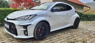

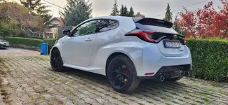

Put on winter tyres and rims, installed Whiteline AntiLift front bushings, rear Verkline bushings, Cusco rear diff cover for 750ml total oil in diff, and came a step closer to finish intercooler water spray retrofit, still missing some damn wires.... And finally, did geo on the car. Strangely, guy said he couldn't get more than -2deg20min (2.3333) on the front (Powerflex camber bolts). Running -2.333F, 1mm toe out total and -2R, 1mm toe in total.
Gonna go for a blast tonight to see how it feels :)
View attachment 9157View attachment 9156
Japan racing SL01? What width & offset did you go for?
