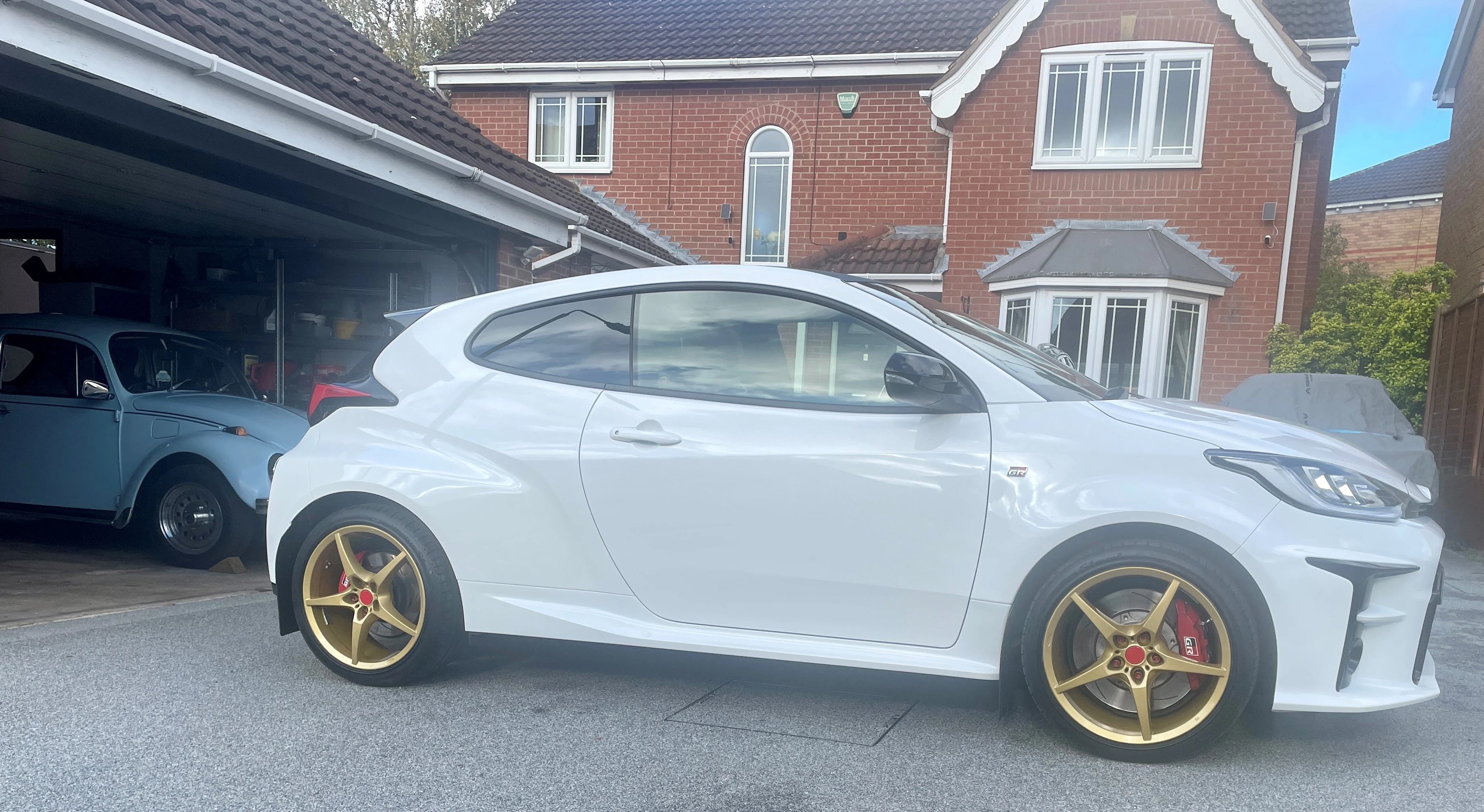

I bought some cheap Italian ones originally fitted to an Evo. They were black but I had them powder coated gold. I did look for 18" Toyota ones but there were none local to me. They are lighter than my Speedlines. I do now have 3 sets of wheels for this car though !
I had to mount angled bolt in valves as the valves are mounted on the inner drum, strange I know but I am happy with the look for a cheap set.
