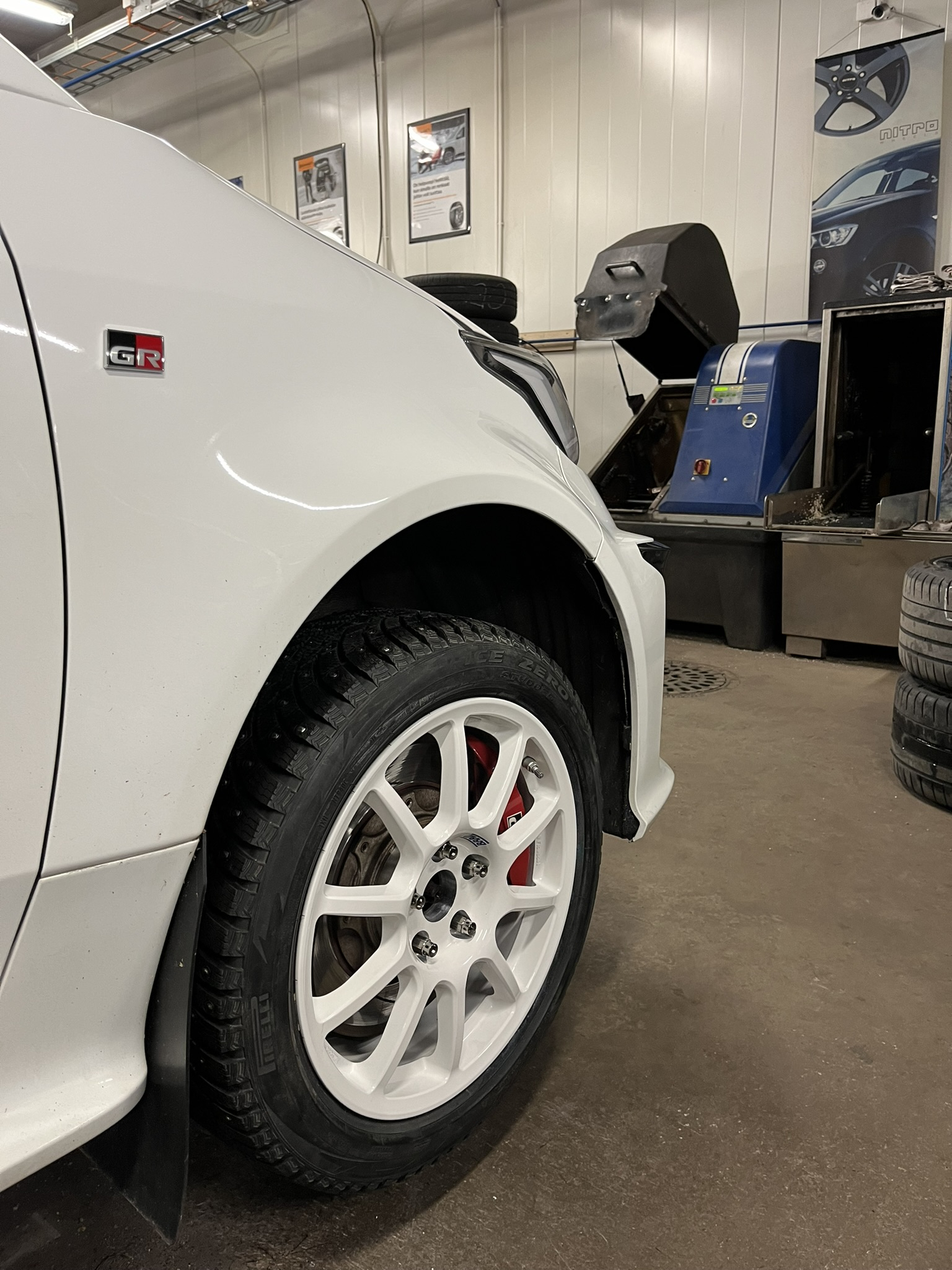

as a overall first impressions I like the feel of narrow tire. car feels light on its toes. cannot wait it to get tossed when it gets more slippy..

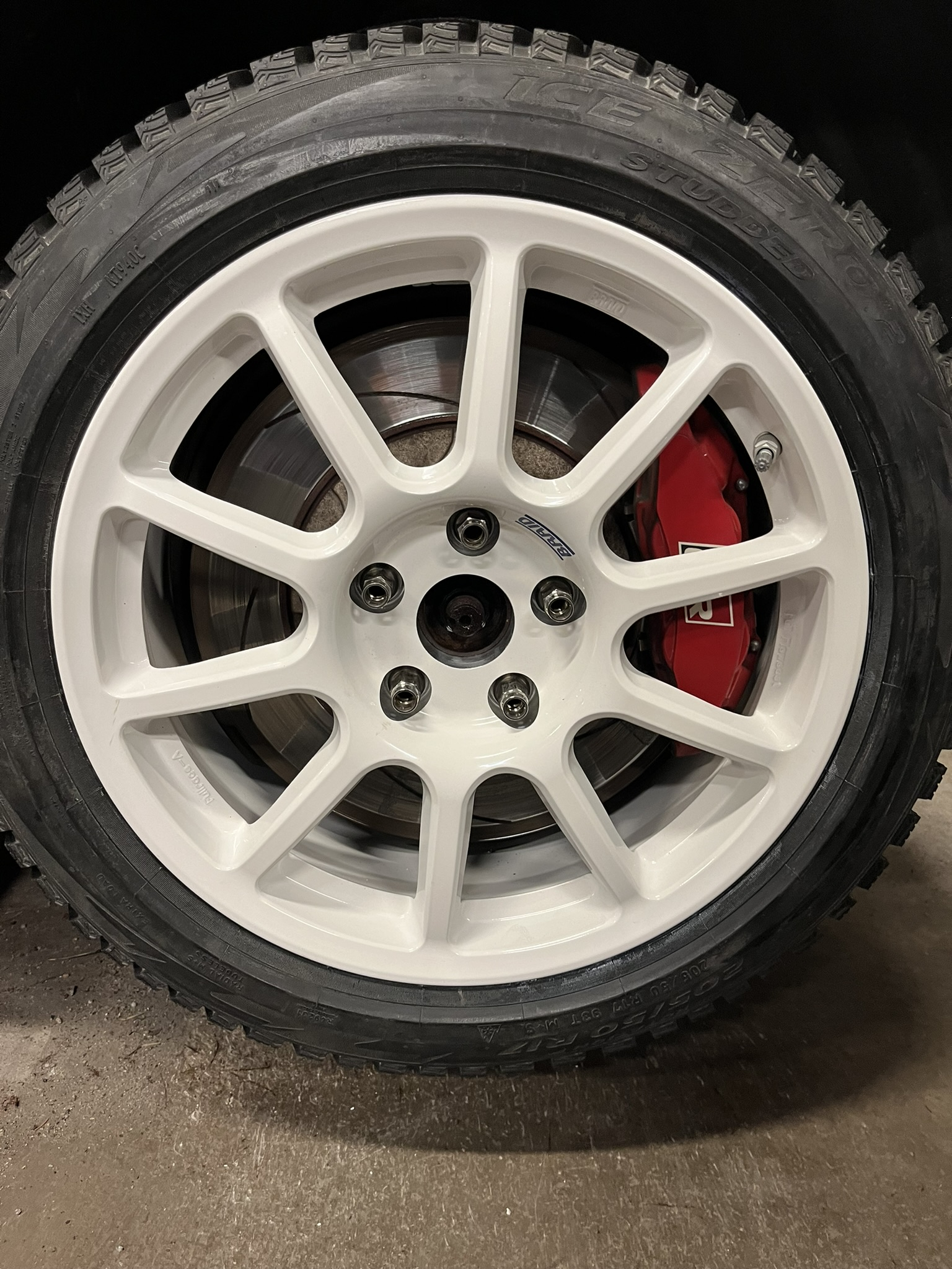

MacG Racing is happy to step in and investigate for you. We are the UK distributor for Braid and we want all customers to be 100% happy with their wheels. We may not have been your reseller but we are happy to take the time and investigate further.Got the Braids installed. ET35 17x7J. More space between wheel and brake saddle than with ProTrack One 17x9J ET45.
One wheel is not straight (center hub is rocking) - asked from reseller and Braid what to do.

Cheers - i can check the wheels more in detail once fiddling with the car this weekend. Have been really busy and also Ill for 3wks now so has taken its toll. Btw ’bad ’ wheels are now installed to rear wheels - should I test them in front axle to see if they cause any excessive vibration or what would you recommend?MacG Racing is happy to step in and investigate for you. We are the UK distributor for Braid and we want all customers to be 100% happy with their wheels. We may not have been your reseller but we are happy to take the time and investigate further.

Hi Michael, the perfect solution is to use a dial indicator to check any movement in the tolerance. Did you have a tyre balancing machine? That's a great base to mount the dial indicator but I would also check the balancing machine itself just to be fair. If you have any lazer etched markings on the wheel in between PCD of hub face that identifies the wheel and any reseller details, we can approach Braid and investigate. Please DM if any sensitive information but we will be happy to publish the results to all.Cheers - i can check the wheels more in detail once fiddling with the car this weekend. Have been really busy and also Ill for 3wks now so has taken its toll. Btw ’bad ’ wheels are now installed to rear wheels - should I test them in front axle to see if they cause any excessive vibration or what would you recommend?
Cheers I will check. All I have the comment from the tire shop guy & video from the wheel on the balancing machine that I can share.Hi Michael, the perfect solution is to use a dial indicator to check any movement in the tolerance. Did you have a tyre balancing machine? That's a great base to mount the dial indicator but I would also check the balancing machine itself just to be fair. If you have any lazer etched markings on the wheel in between PCD of hub face that identifies the wheel and any reseller details, we can approach Braid and investigate. Please DM if any sensitive information but we will be happy to publish the results to all.
