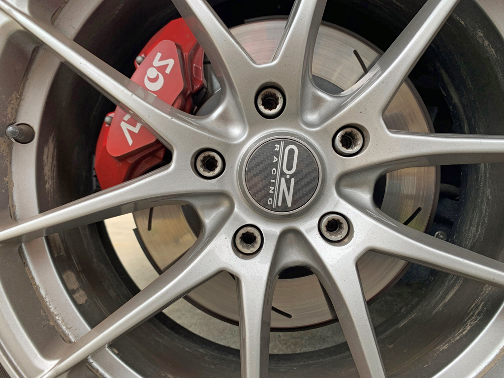

Hi,
Got my OZ Leggera a wile back, but with no wheel nuts. I think the standard ones from the forged are no good on the OZ.
Does anyone know what kind of wheelnuts I need for the OZ ones?
OZ leggera 8x18 ET45
M12 x 1.5, 60 degree tapered. You might find some shaft nuts will give you an extra turn or two, but 8 turns is sufficient.

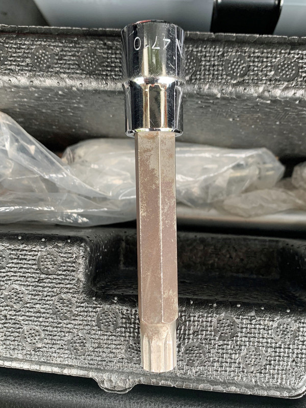

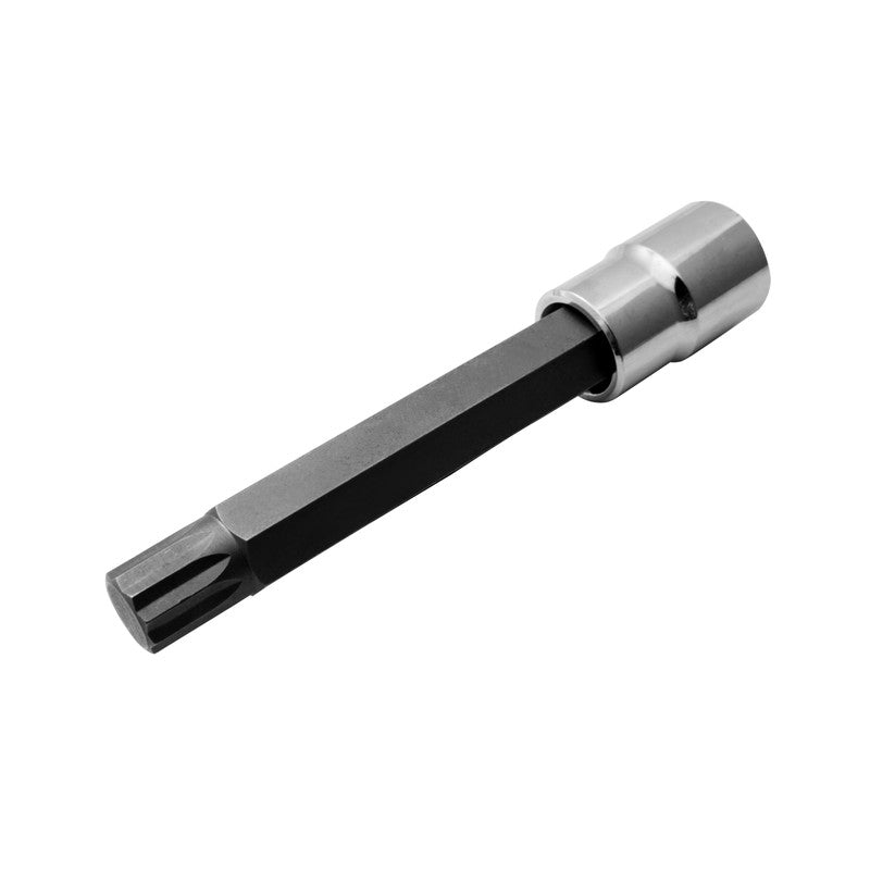

Sorry guys, I thought I had replied to this. I have these wheels and they came with nuts. Oz call them 'tuner lug nuts'.
They require a 10 point tool. Oz supplies one which has a hex head and fits a 19mm socket but I bought a specialised tool that the Lotus guys use that goes straight on the 1/2" drive on the breaker bar.
I figured this out myself/through dealer, so now I’m good for winter
