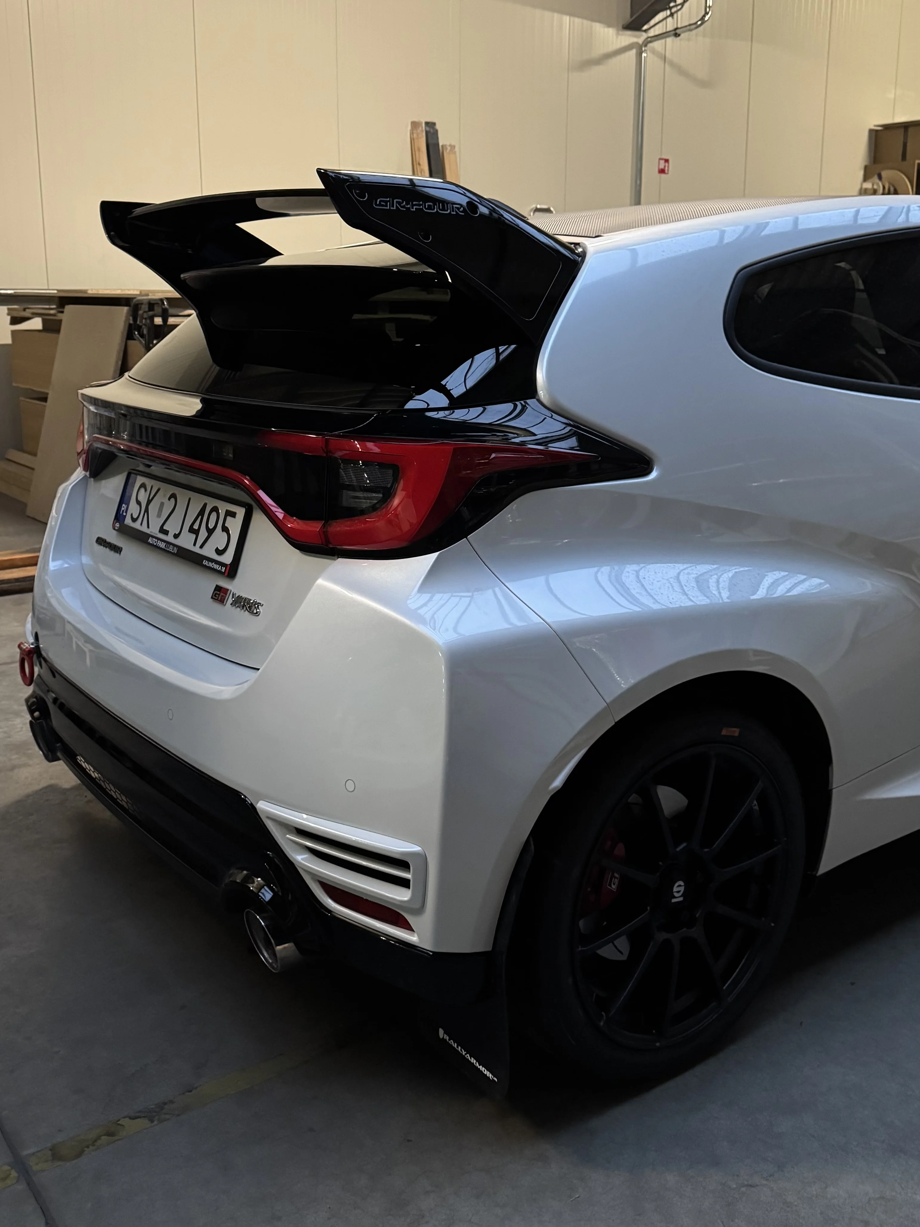

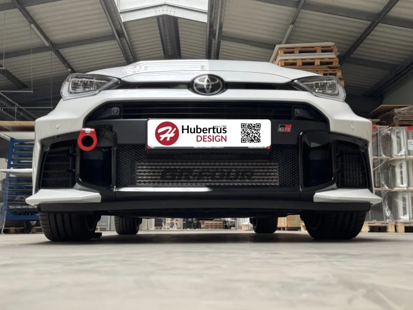

I also installed a front splitter; I know it's necessary. On the 911 Turbo S, the rear spoiler extends at higher speeds, and the splitter extends under the front of the car. I also installed different grilles to better protect the radiators.
How much was the wing itself, cheapest i see is 5000 eur, without markup through official channels. I wonder how some get it for 1700 pound or eur.
When buying in Japan, for example, as I did, the cost of the rear wing, including shipping costs to Poland and fees (customs duty + VAT) is approximately 2500 EUR.
Nice, looks like a solid setup (y)
Did you also go for the underbody aero bits?
Have you had a chance to properly test it? Any noticeable difference in stability or feel?
