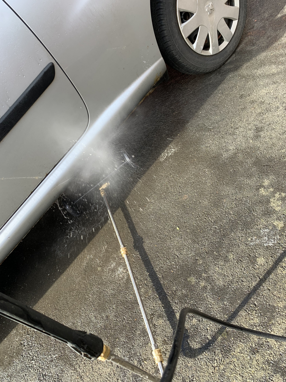

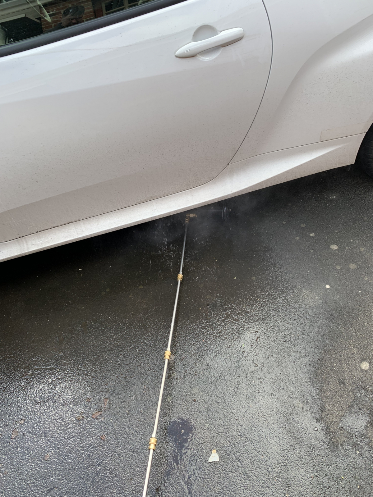

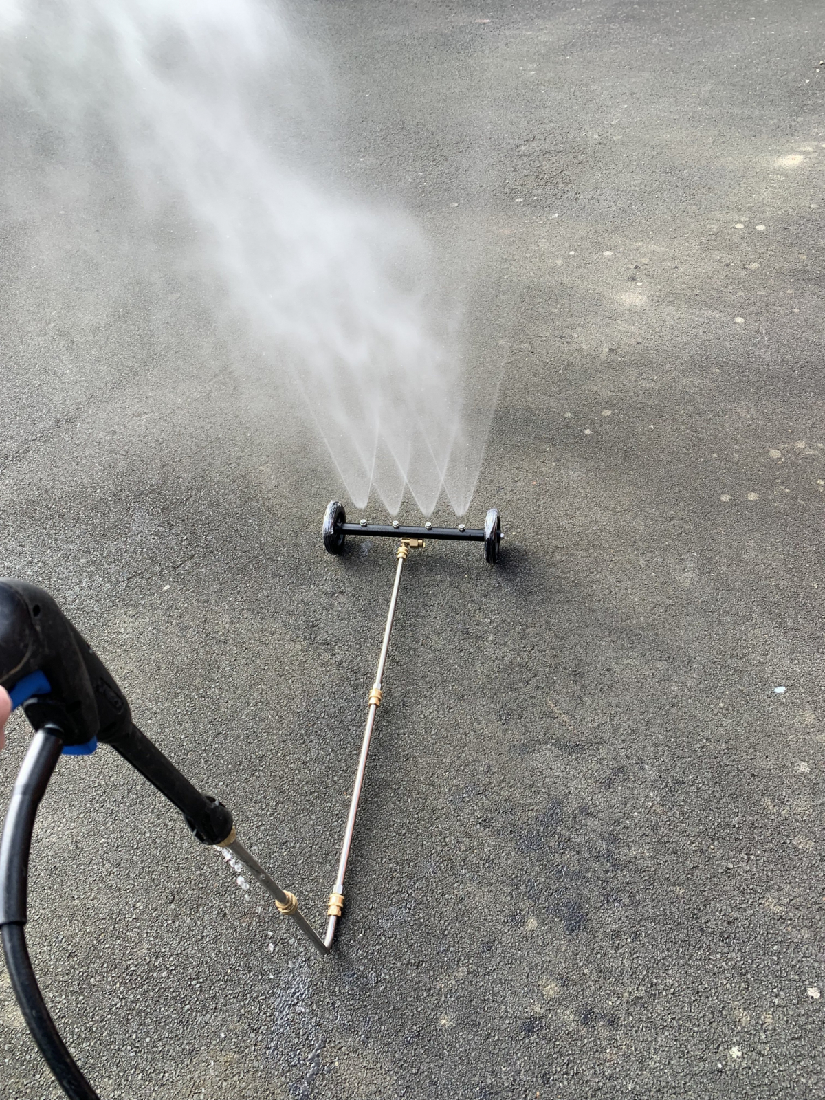

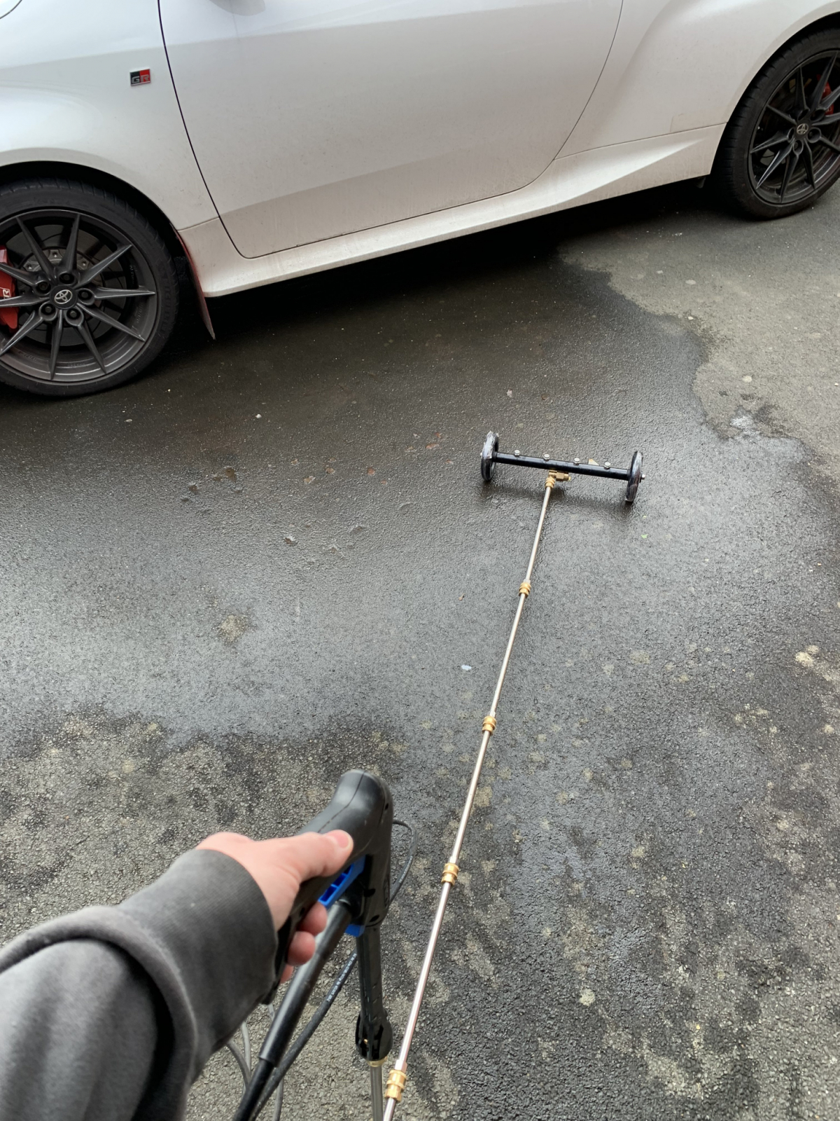

Today I tested my new makeshift underside chassis cleaner, I decided I didn’t want to coat the underside and went the route of regular cleaning of the underside to remove salt and crap before it gets chance to cause some rot. I tested it on the old dog car first then done the Yaris. I’ve been using salt-away for underside washing but now feeding my jet wash with it so can blast it under pressure, I’m happy with this set up no jacking up, no lying on the ground just a quick 5 min set up and blast then done. This stuff keeps boats, trailers and marine engines used in salt water pristine so should be good enough for the salt under the car.

View attachment 1967View attachment 1968
Now that is cool 👌 Fancy making some more & selling them on here? 😂

It would be cheaper to buy the parts made up mate there’s loads online they are 1/4 quick connects which I had to cross over to Nilfisk to use with my jetwash. Just had to make sure they were all pressure rated
