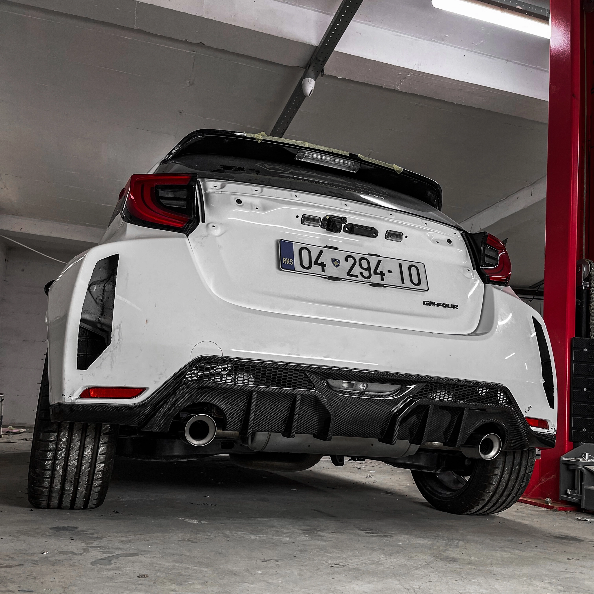

OH HEY! Its me that makes those, hope you like it! I'm glad it got there in 1 piece!
Feel free to send me a pic when you have installed it :)
Here it is 🤩 almost in disguise when black-on-black. (I let the GRFour badge stay though)
Thank you 👋🏻😊
Realized I have friends living not too far from where the envelope was sent from in NZ.. small world 😊
