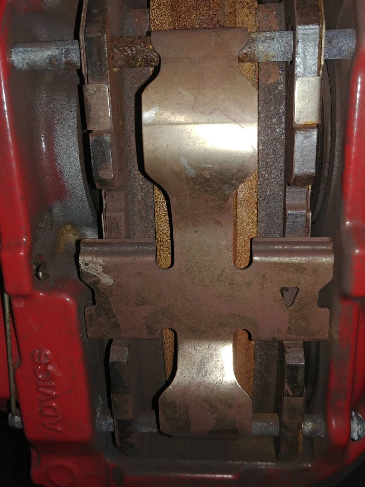

I put on an old set of tires for this thinking they would be worn out after the morning, but they weirdly have around the same amount of tread on as when I started, between 1.6 mm and 3mm. My new pads however tell a different story
New on the day before and looking about half worn. 🤦‍♂️

That looks like you need to get some sort of additional cooling to the brakes, chewing through pads that fast is a sign they’re getting too hot.
