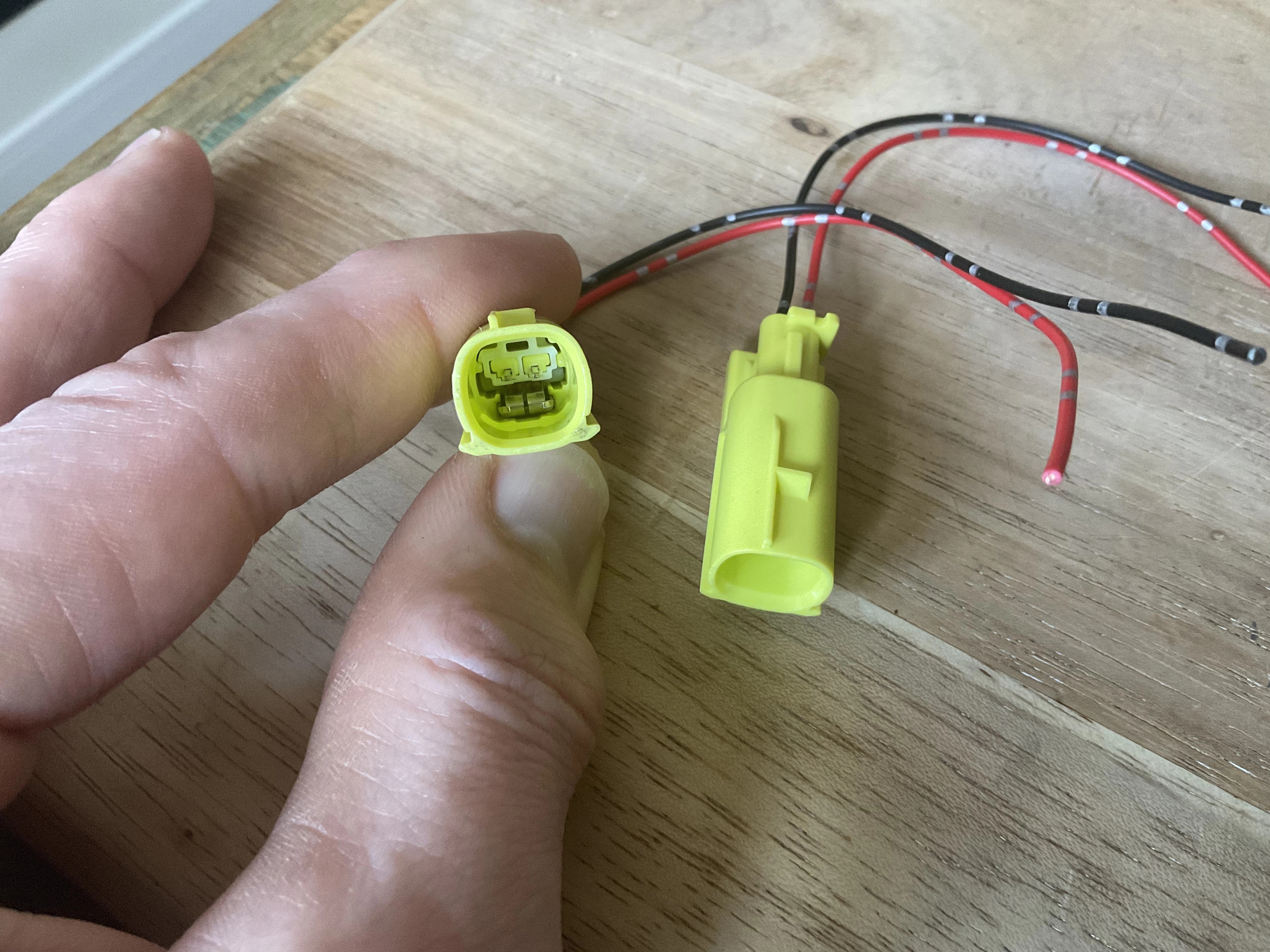

I just had some pre wired Toyota airbag plugs arrive. To be honest I am amazed that they actually turned up and checking them they are identical to the OEM. What I have found with the Lexus plug and vw terminal is that there is a very very small difference with the pin and that can result in some longitudinal movement. So far this has only been when plugging the two connectors together and simply required that the wires be held when the plugs are connected. In service there has been no movement but given I have over 20 years training invested into my Mrs I was not happy with anything other than perfect.
I have a set spare if anyone needs a set.
