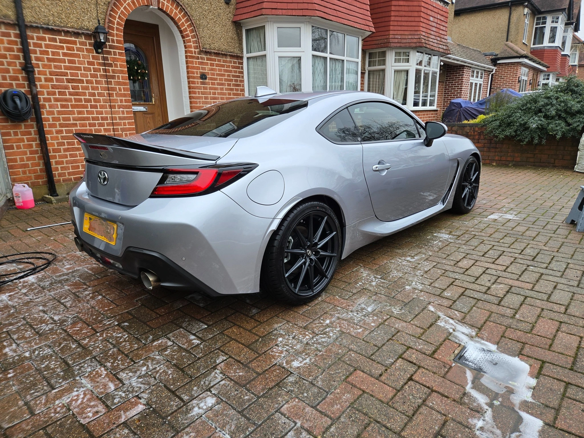

This is -30mm with lowering springs, the motivation was for the aesthetics, I never could like how it sat just a bit too high from the factory. Now it's an even gap between the tyre and body all around. It's worked out really well for me, happy it was more budget friendly.
I can't comment on performance, no track use or pushing. It is firmer and still familiar. You cut the rubber bump stop down to account for the shorter spring, so the dampers work the same and due to the shorter spring you naturally add about 1.5 camber. Comfort wise it wasn't great stock, but now i notice more bad roads then i did before.
1 year in and no issues with clearance, some obscene speed bumps and still not been an issue.

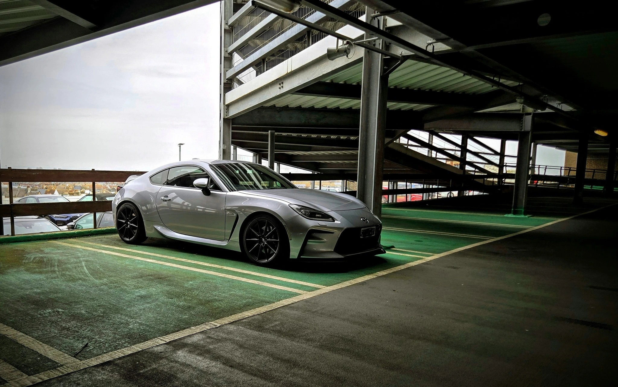

My car is set up for handling over aesthetics but I hazard a guess at 30mm front 25mm back. (I measure from pinch welds to the ground and didn't have the stock height before adjusting) .The reason of the difference in Front and Rear height is this how the car performs its best on track.
For Road, I run stock wheels with 20mm spacers all round. Front looks a bit weird as I have -3 degrees of Camber.
