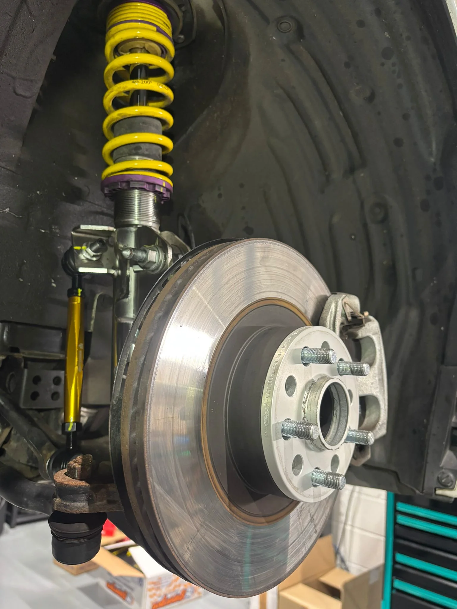

I've a GR86 that's lowered circa 25mm on KW v3's.
Planning on fitting Eibach 10mm spacers.
Unlike screw on 15mm or 20mm spacers, the wheel studs need replaced with 10mm spacers so not as easy to 'reverse'. Not sure if rear hub needs loosened (along with caliper/disc removal) to get the Eibach studs in as I can't find info on the stud length that comes with the kit
The stock studs are not known to be very strong so changing them for 'good' Eibach ones may be a nice side benefit?
I'm not looking for the flush wheel to arch fit lads using 20mm are... more trying to counteract the exaggerated wheel sunken into arches look that lowering generates.
Rims I'm running are 17" BBS RF504 for weight reduction and ride on our now crap roads.. but also have stock rims and may try others as they come along used...
Anyone have experience like my situation?

I fitted 10mm spacers on the front only to give clearance to AP calipers with an old set of 17" wheels I use on track.

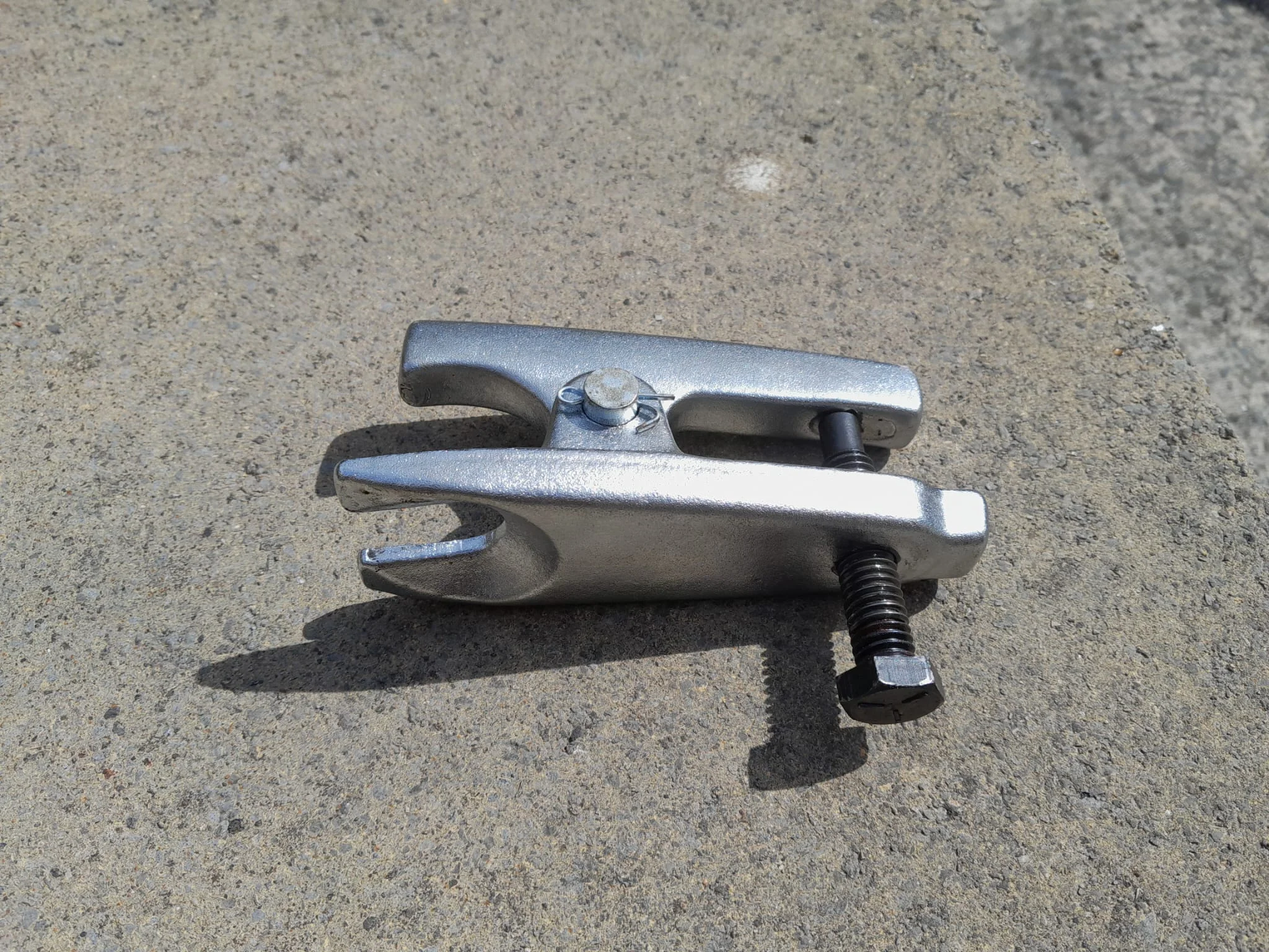

Don't whack them with a lump hammer like Kevin Vo! The impact is all going into the wheel bearings. A ball joint splitter will remove and refit them without abuse.
No negative impacts from using the 10mm spacers but you'll notice the longer studs require a much larger angle to get them up to torque which is disconcerting at first - feels like a stud that's about to break but it's just due to the extra length being stretched.
