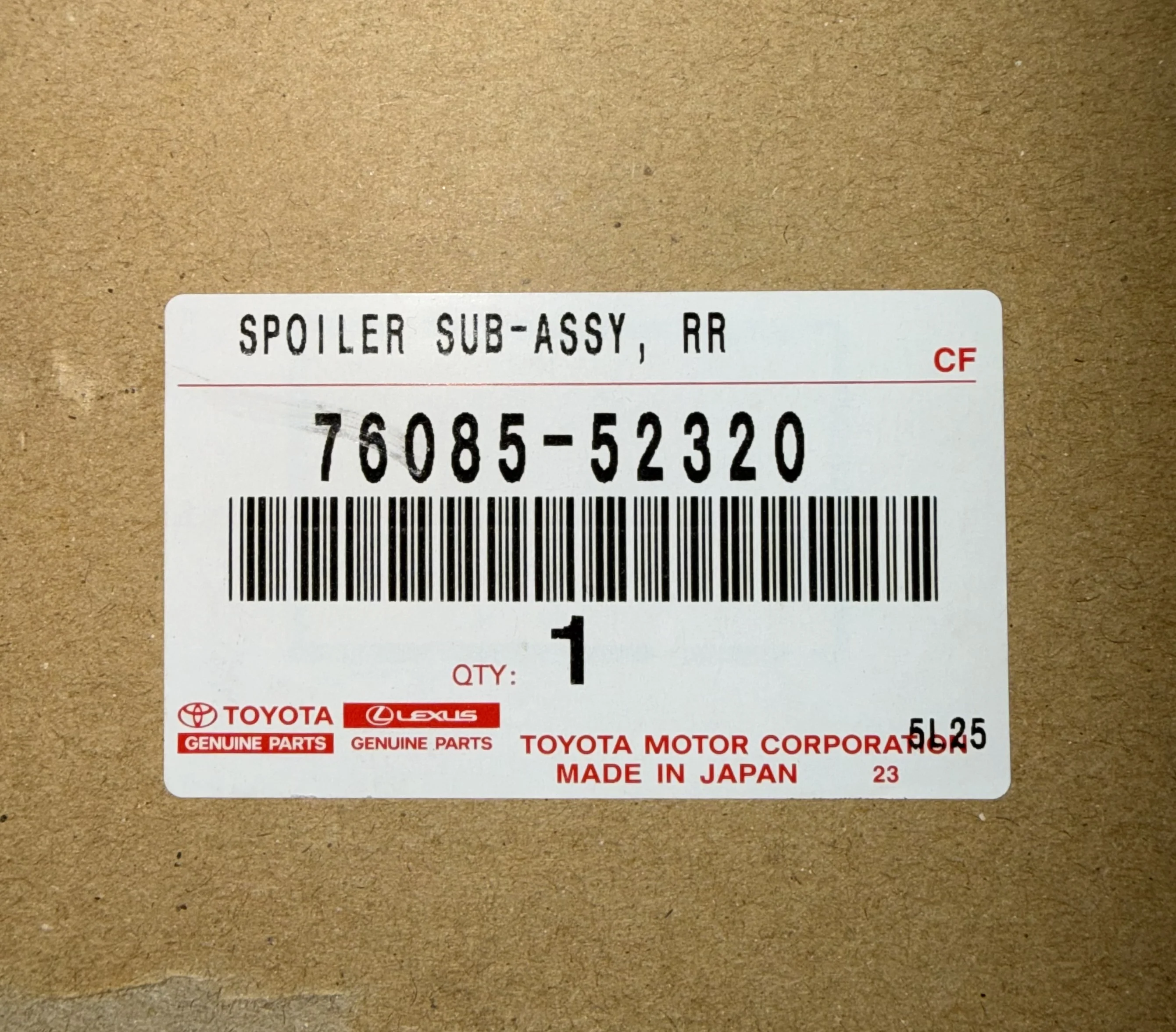

The box my wing came in has one part number, I’ll post it here tomorrow. It came fully assembled other than 4 x screws that were in a small bag. The wing looks as though it can be built up using individual part numbers (like the post above) but a fully assembled wing looks to come under its own single part number. I’ll report back & hopefully give some clarity.
