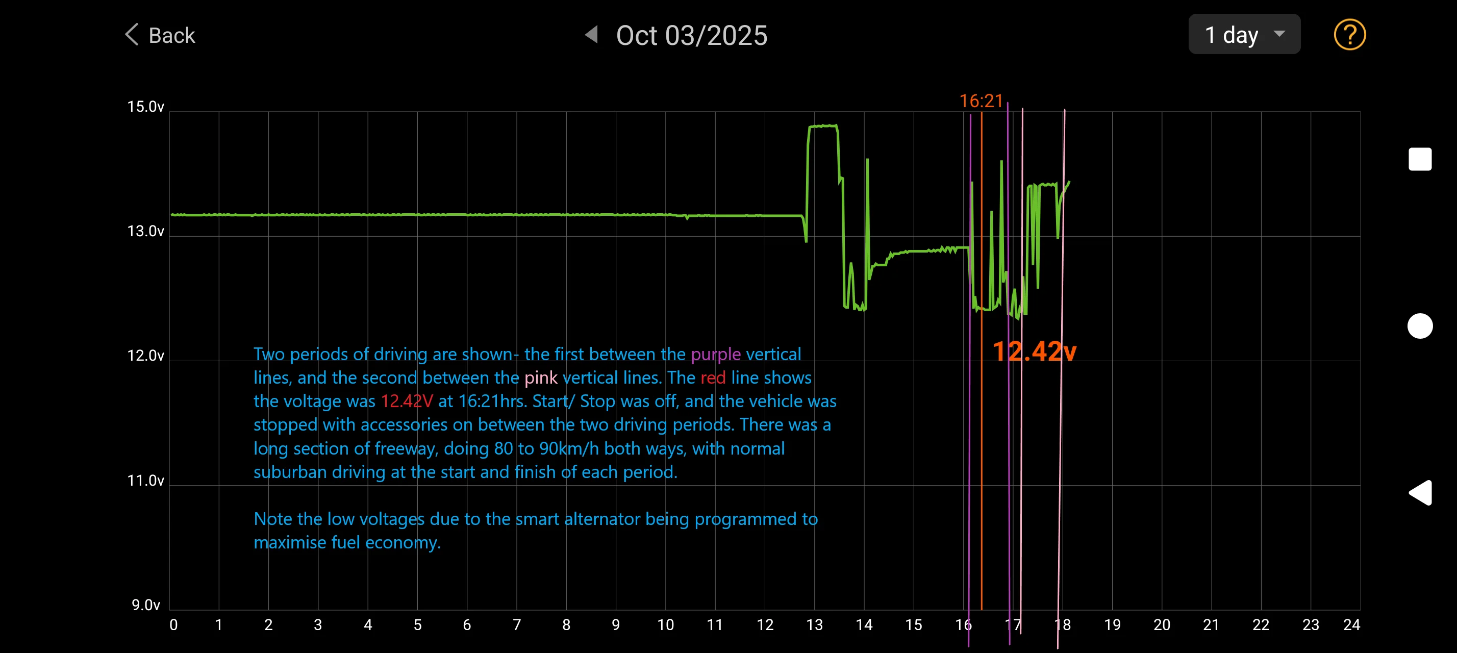

theres clearly two modes in the charging (can also be battery / BMS related) - constant charging and then mode where charging is dropped for some reason and battery runs clearly without alternator charge. Thought this to be vehicle/ecu driven but who knows..
I've got the same battery monitor on my GR Y too.
The GR Y do use a smart alternator/ charging system and the normal operating/ charging voltages I've observed show it's definitely not going to work properly to charge a LiFePO4 starter battery. The alternator output is often down in the 12.4 V range while driving- which is basically below 25% SOC for a LiFePO4 battery, but 80% for a lead acid.
