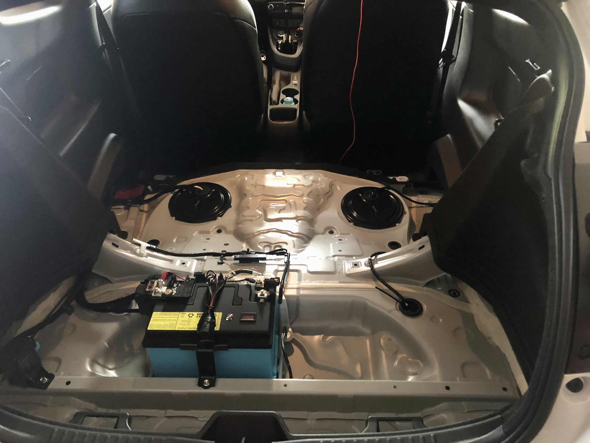

Hi guys
What would be the best lightweight battery for street use? I'd like change the heavy oem acid battery.
Im planning to drive the car in winter also, so it should be suitable for colder temps too.
no easy choice if you need to do lot of cold starts. I'd opt for 40Ah LiFePo4.
Currently using 20Ah LiFePo4 but starting car usually from warm garage (i.e. not sub zero 'C).
I ordered from here, but a little brother version to this. they do not seem to have 20Ah variant in stock?
this is the smaller variant
issue with LiFePo4 is that it doesn't take charge when below 0'C though not sure if that smart BCM can warm up the battery once getting moving.

guess they're ok too. no first hand experience but guess some on the forum are using them. My budget wasn't that high so chose a moderate priced item that seemed to be ok quality.
How long have you been driving with that 20ah battery? How is it holding up?
Have you left your car in a garage for a few weeks without charging? Could it be started?
I'm just wondering if I'd choose the 40ah version then how long the car can sit without having starting issues.
Have used it for 2 years or so - no issues.
longest time car has been without use has been maybe 2-3wks? but I do drive it usually daily (not that long drivers though).

Before I had a power thief via the OBD port, the battery lasted 3 weeks without charging.
If I had to choose, I would pick the 60AH version, so its 100% equivalent to the stock battery. the 60 is just a tiny but heavier than the 40 AH

I have had the battery installed since I picked up the new car in 2021. You don't have to do anything, just install it.
yup, when you install in a new car....but mine is already 2 years old ...
ok, seems legit. but we still dont know if there is a way to reset battery data or if our gr works without ibs.
