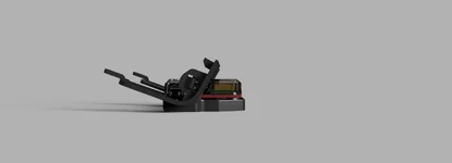

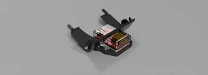

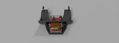

Been working on a better integrated data logging solution.
GPS
Instead of ordering a ready made GPS with built in battery like a normal person I decided to buy the DIY version from Racebox which supports all the features the normal ones does but doesn't come with a power source, therefore in a very compact and modifiable form.
Since I changed the stock mirror with an unpowered Opel Astra mirror, the cable for the stock mirror remained unused. Turns out I can simply tap into that cable to power the Racebox Micro which supports anything from 3.5V to 16V.
I designed this part that fits into the mirror assembly and integrates a slot to slide the racebox micro in.
GRY_MirrorGPS_noBattery_v2 v6-p10.webpGRY_MirrorGPS_noBattery_v2 v6-p2.webpGRY_MirrorGPS_noBattery_v2 v6-p11.webp
Some test prints and earlier versions:
Connected it all and now I have a 25Hz gps module that turns on/off with the car now!
