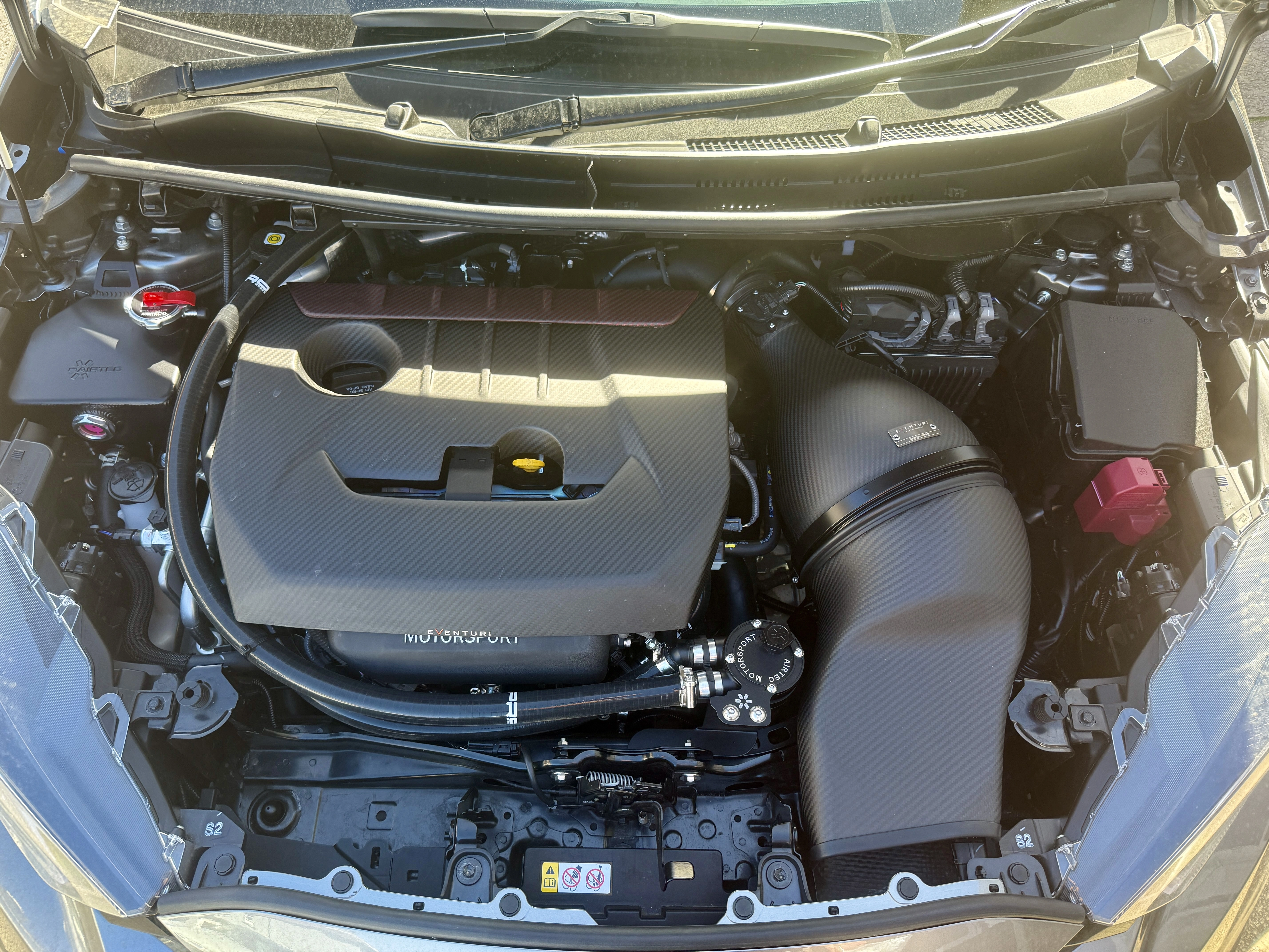

I have an eventuri fitted and it fits the same, I also have an inlet manifold which fits mk1/2. Intercoolers and oil coolers fit although some modification was done by Airtec and that will end up being backwards compatible. Suspension is different but Ohlins and KW have released their versions.
