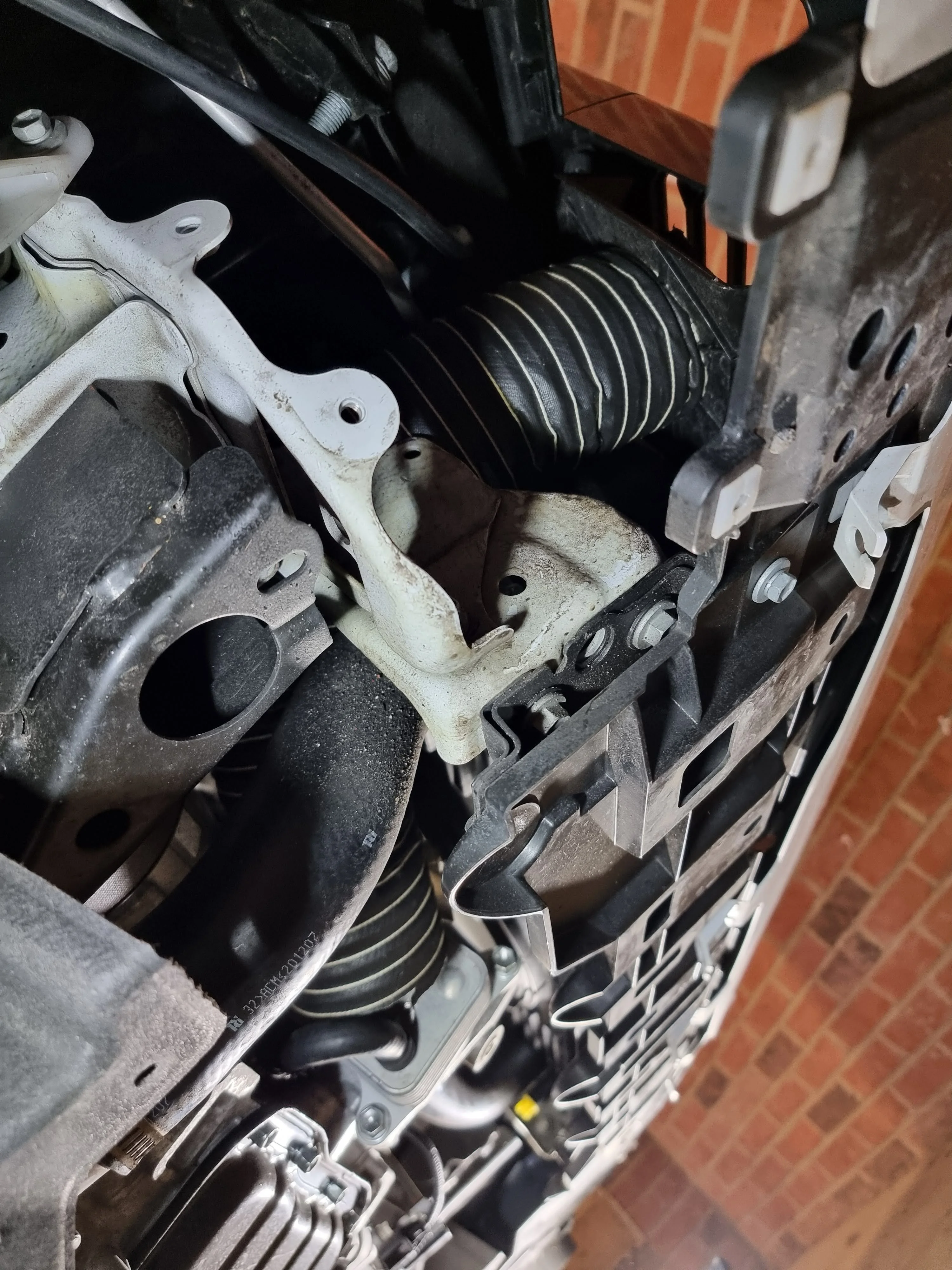

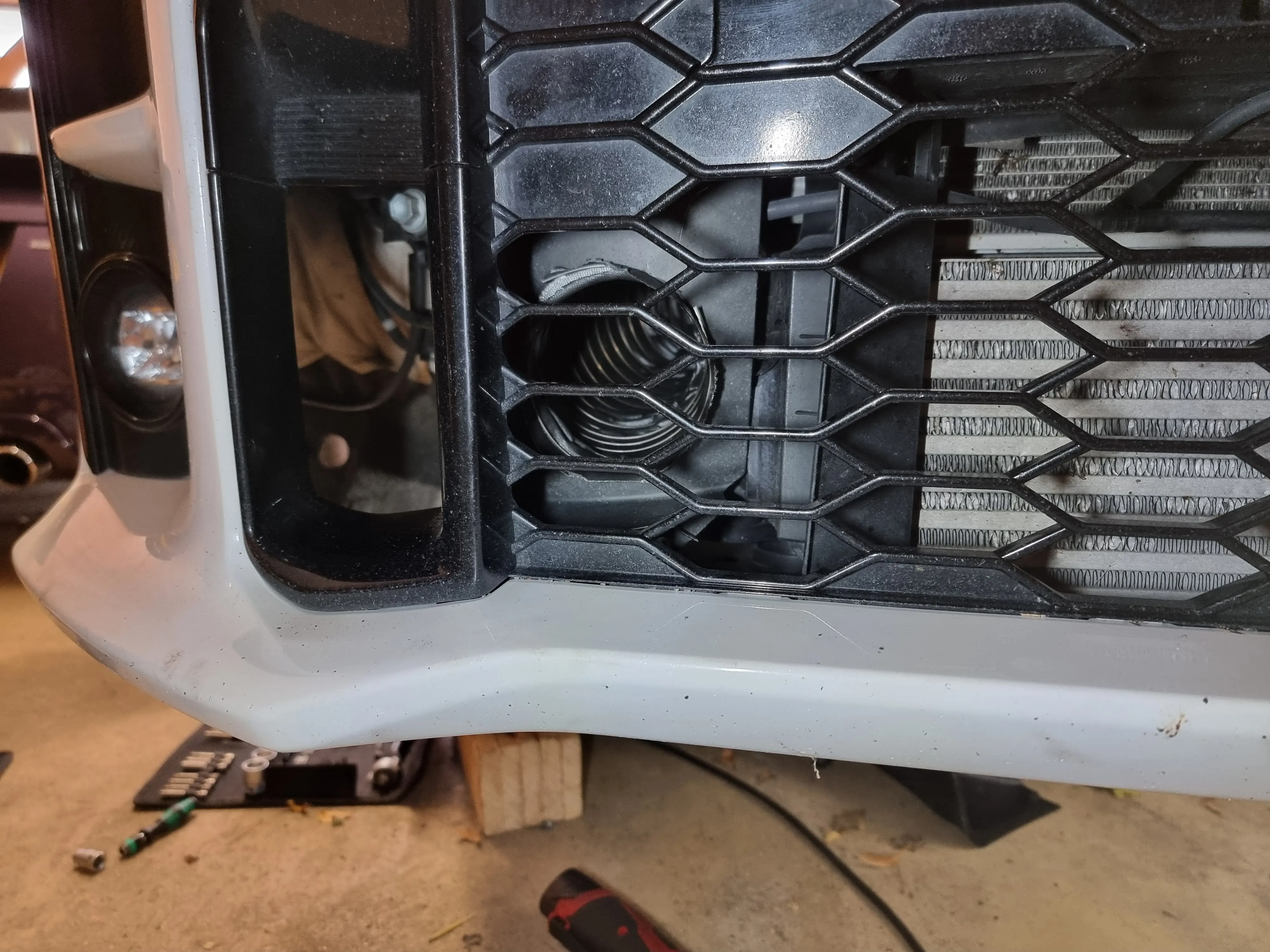

3) oil temps. You can actually run a bit of ducting from the lower blanking plate to the oil cooler. I run in mid 20.C days and it only gets to 113 max now. A dedicated oil cooler is not great if the oil is not hot.

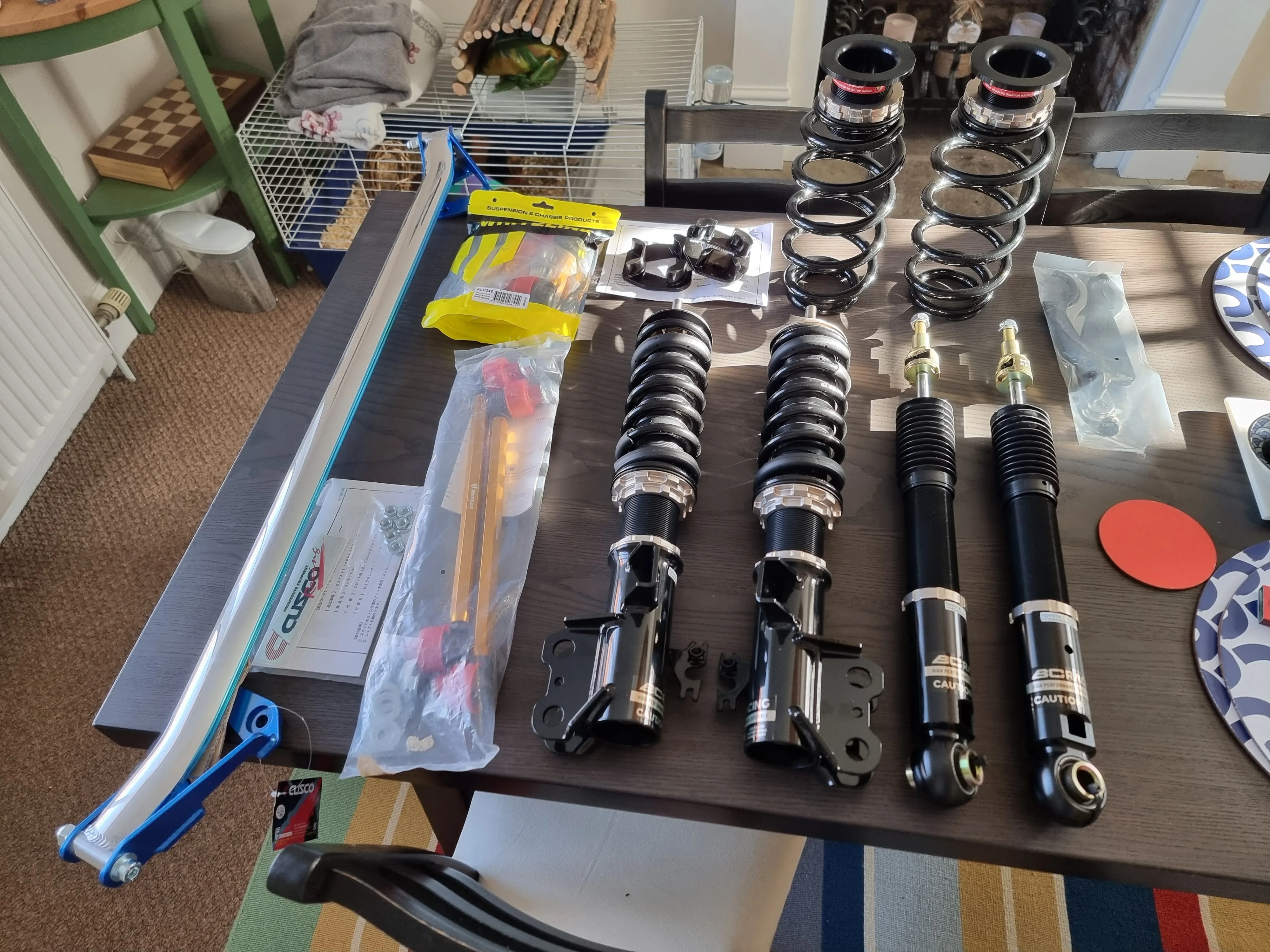

4) suspension is great for everything but long fast corners or the ring with the camber and humps. I literally bottom out the suspension through blanchimont at spa which is seriously unnerving when you take a bit much curb! I run BC coilovers and they are perfect. Not too stiff, get a bit lower to the ground and you can cornerweight it.

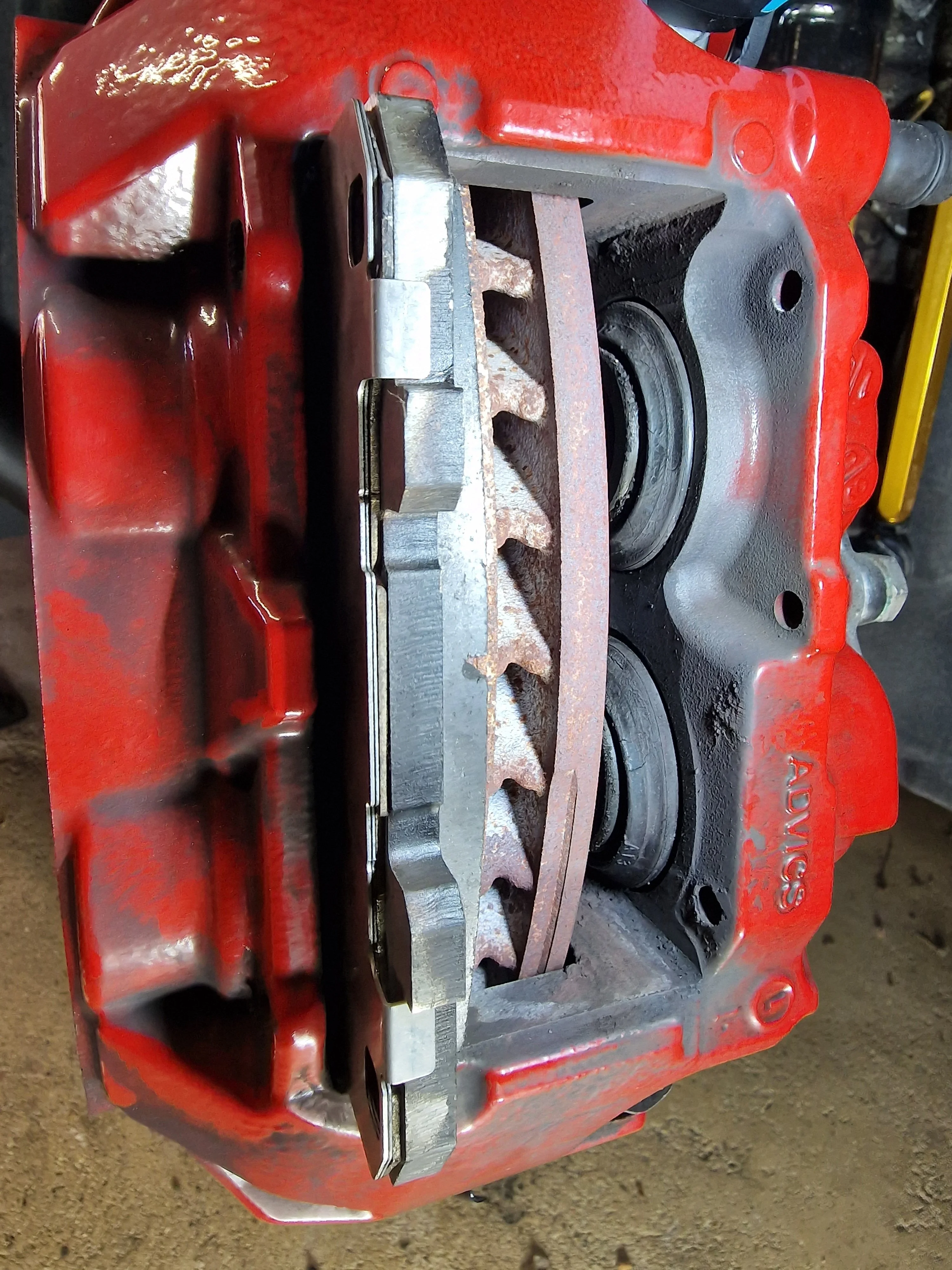

5) brakes. As mentioned totally standard works well. Obviously stick good fluid in and flush 100ml out of the caliper after each track day. OEM pads are fine for most, will do 2 or 3 days and cost 70 quid. I've tried most pads I reckon and I find myself sticking with the @EBC Brakes RP1s. They are like OEM +. More bite, better modulation, deal with temps totally fine, don't make excessive heat, last easily 3x longer than OEM (which makes them great value) and bonus points for not being dusty or noisy.

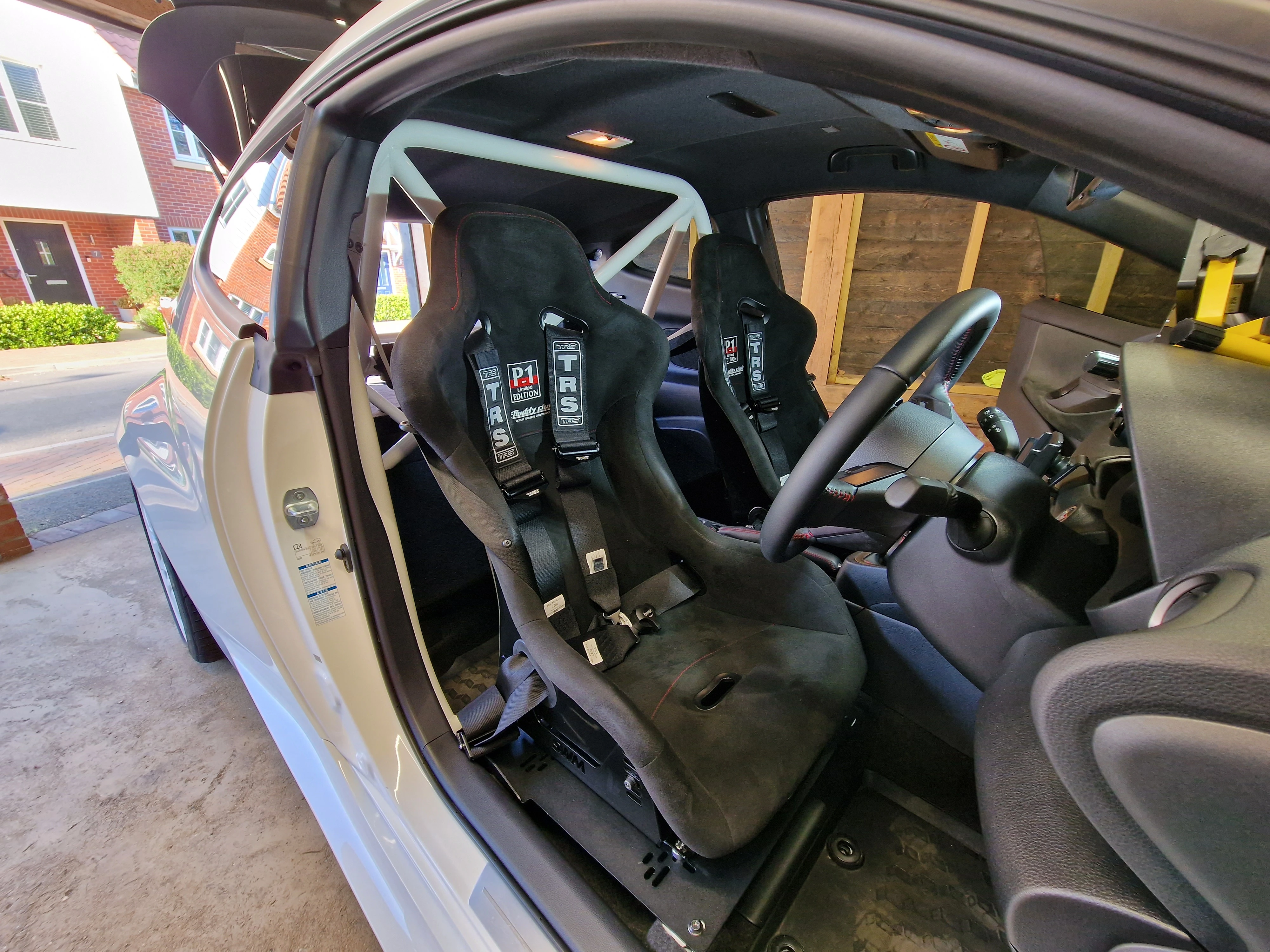

6) seats and stuff, absolutely. If you do it often or drive it near 10/10ths then seats, harness and Hans is a bit of a no brainer if you or anyone around you values your life. @SW Motorsports do a really good value cage and nice seat delete that again keeps it OEM+ along with all the seat mounting hardware.

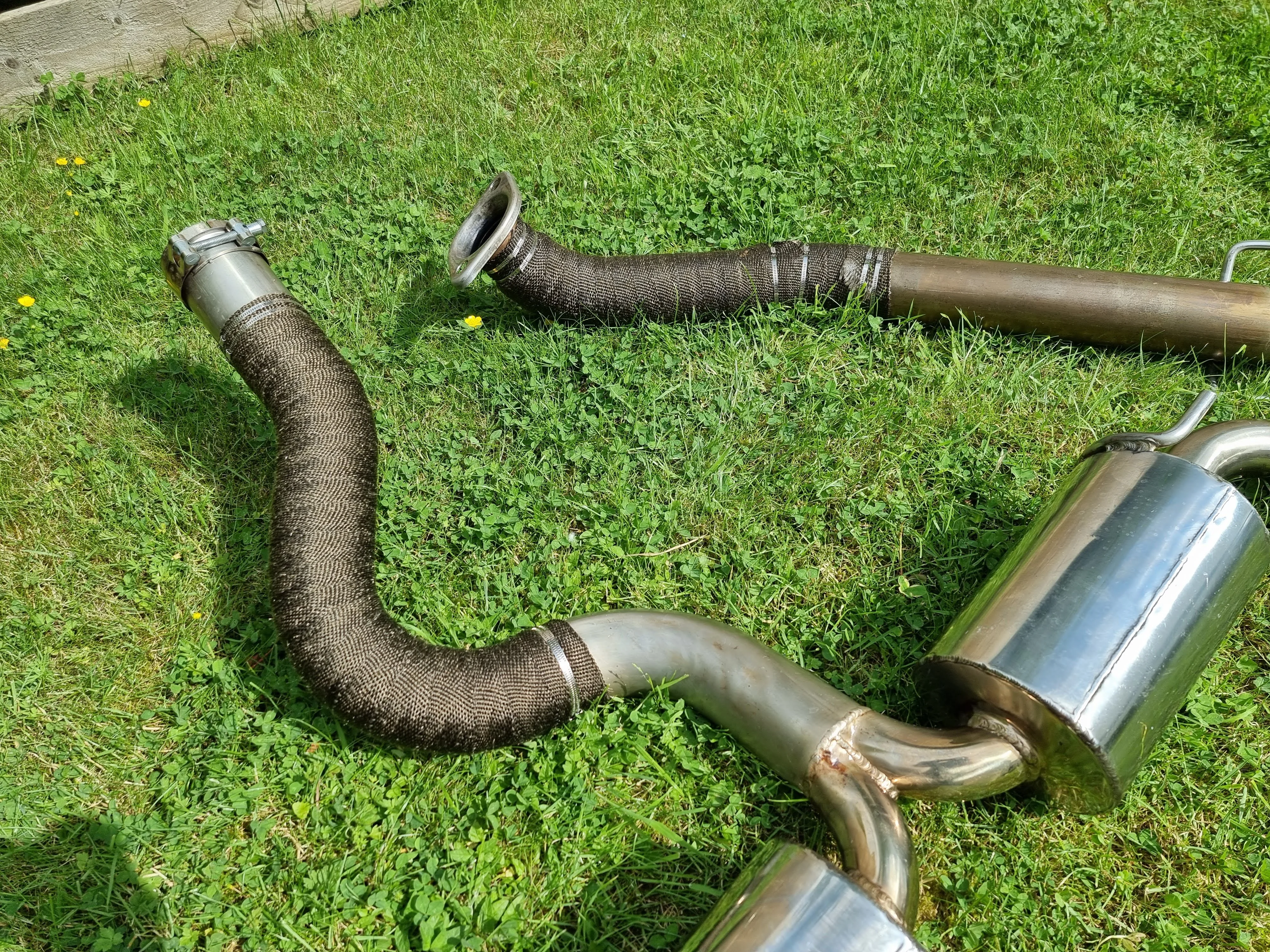

7) people say about the diffs overheating. I find this is only the case on standard tyres. I run 255/35 on track and never once had it. Heat wrapping the bits near the box and diff can't hurt.

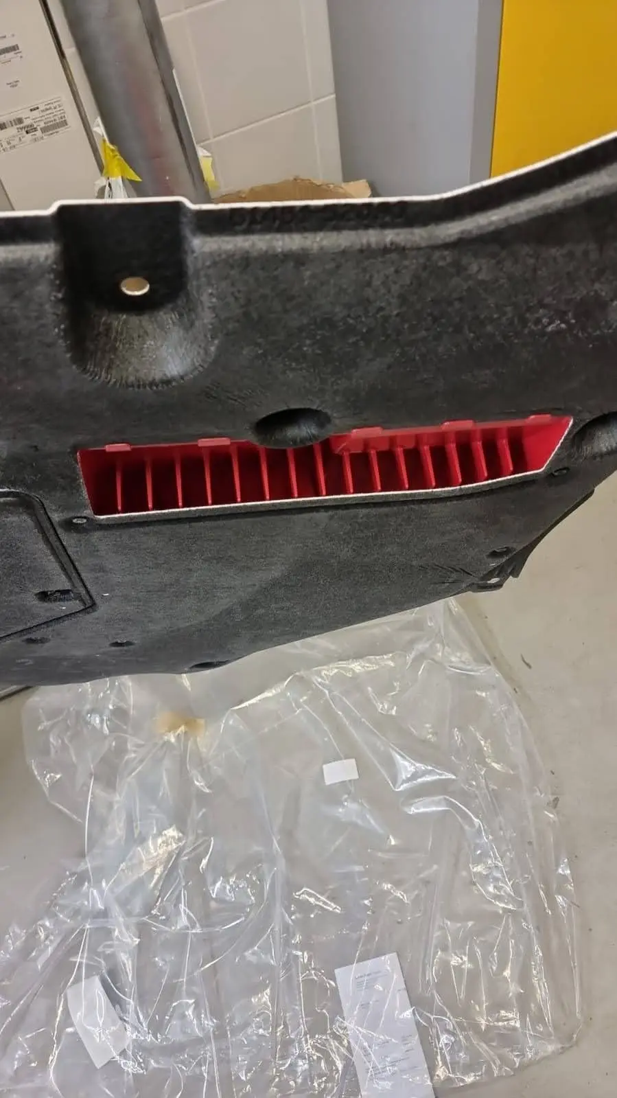

8) temps generally. It gets hot! Remove your engine cover, open the bonnet after sessions, buy the cooling undertray, run water wetter and slightly over fill it, intercooler sprayer makes a big difference on hot days.

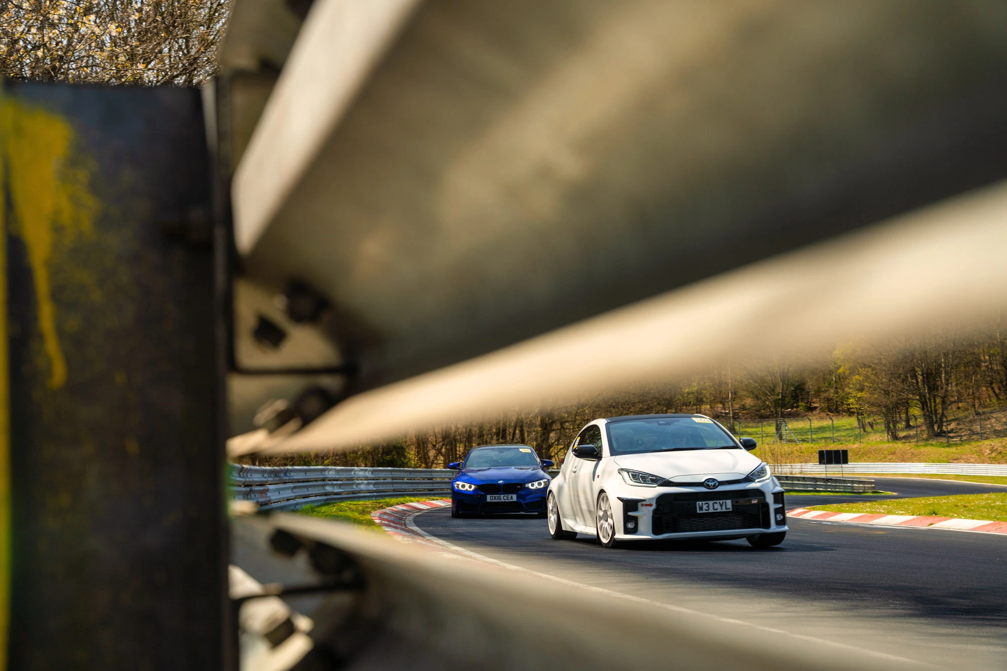

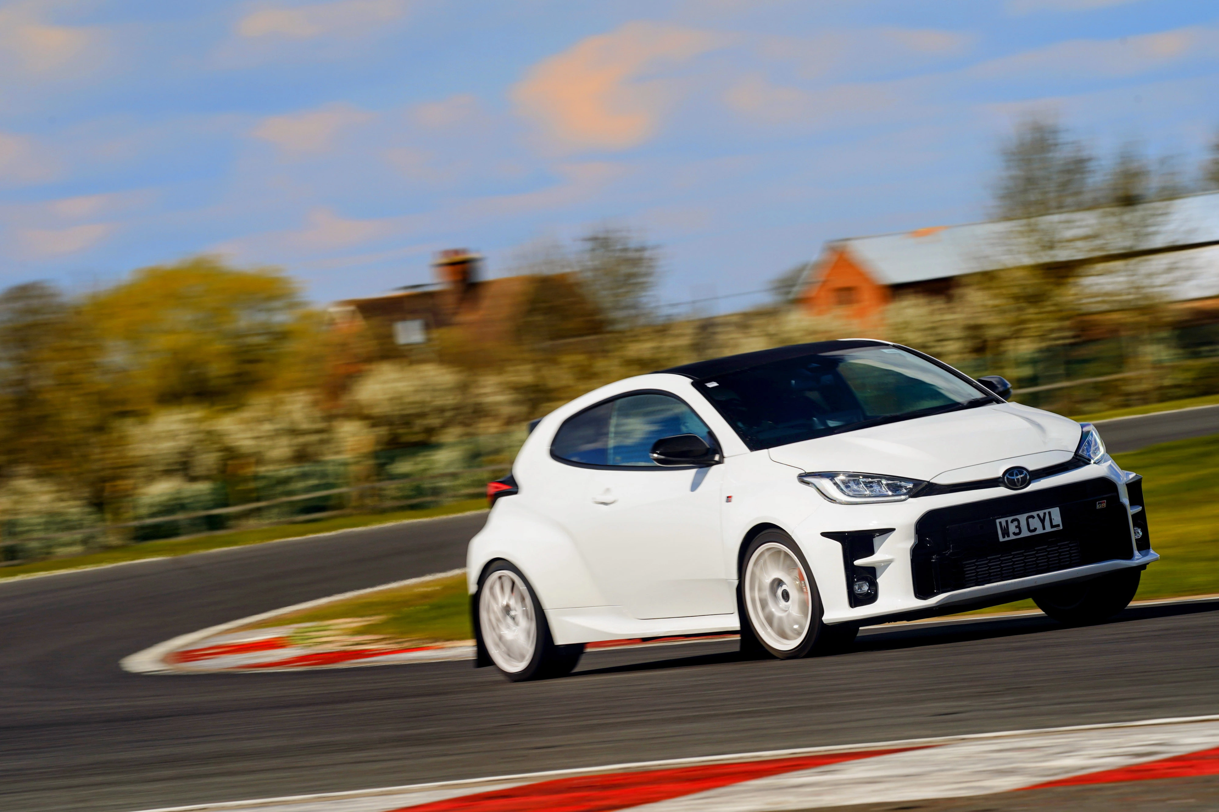

Here's me at the Nurburgring a couple of days ago.
Thanks for the positive words!

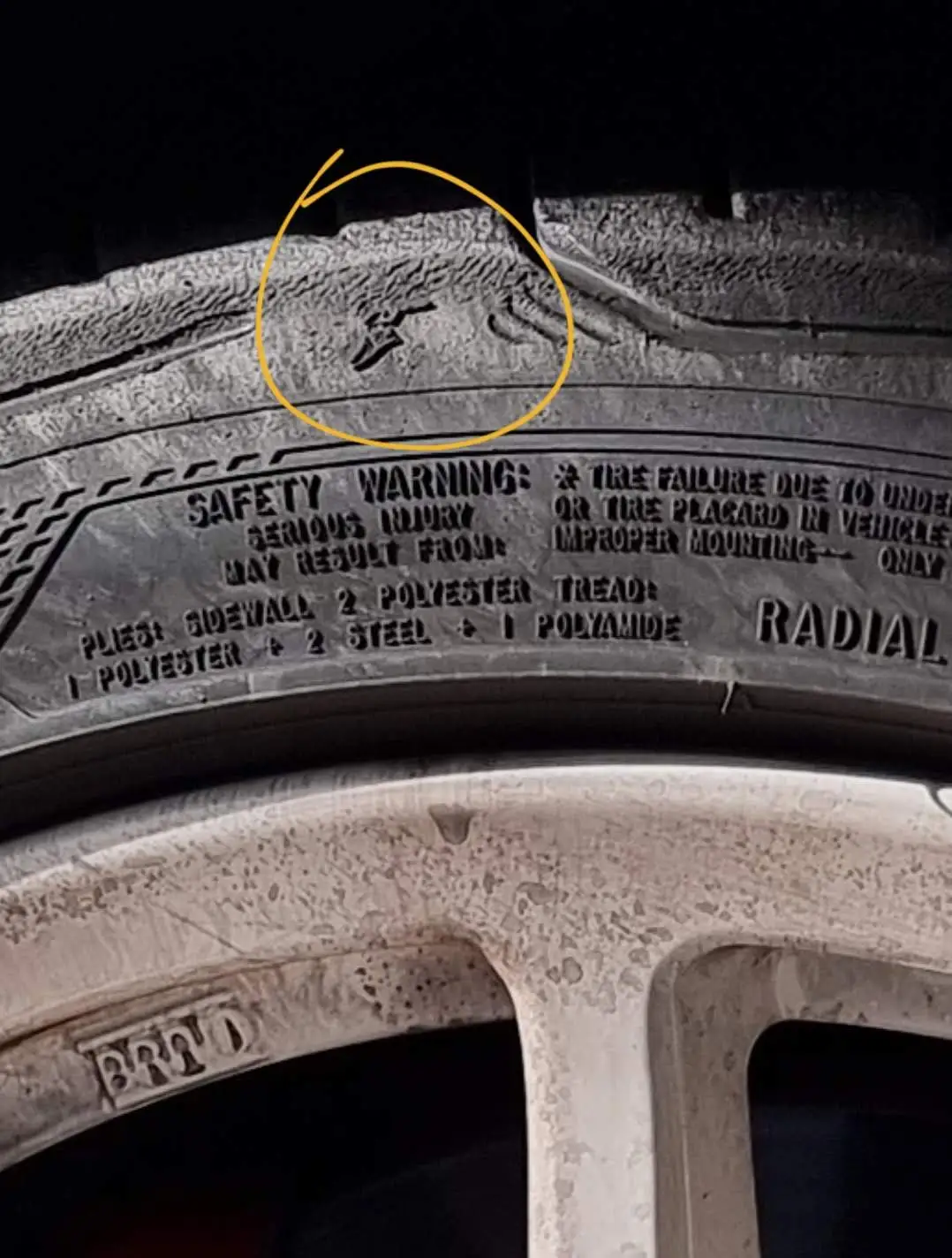

weird sound - from the tires scrubbing the fenders? I get zero noises from the driveline, only from the tires if driven properly
I'll have a good look underneath and suss that out. Also heard the exhaust can come loose if driven hard

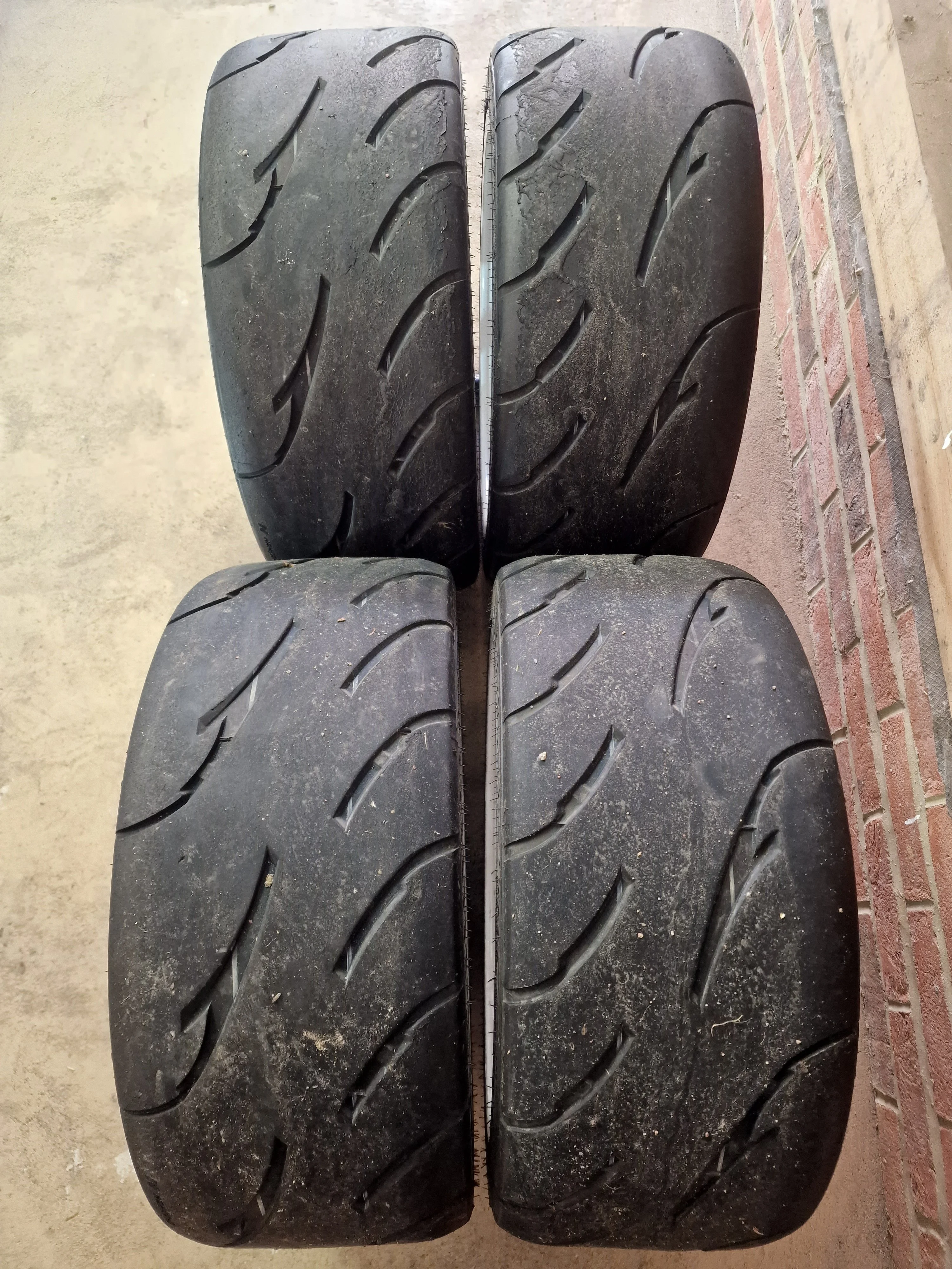

I ran Scrubbed RK7 Pirelli rally tarmac tyres absolute bitch when they’re cold but incredible when they’re at peak operating temp.
Started the day at 28 psi cold but they were hitting wild pressures within a few laps so dropped down to 20 cold (29 hot) and managed a 58.7 with a consistent 1:00s 8 laps in a row before hand.
I wanted to get a 58 and got bored after and started throwing it about.
Rally tyres have a better sidewalk for more aggressive driving IMO so I was launching it over the kerbs.
