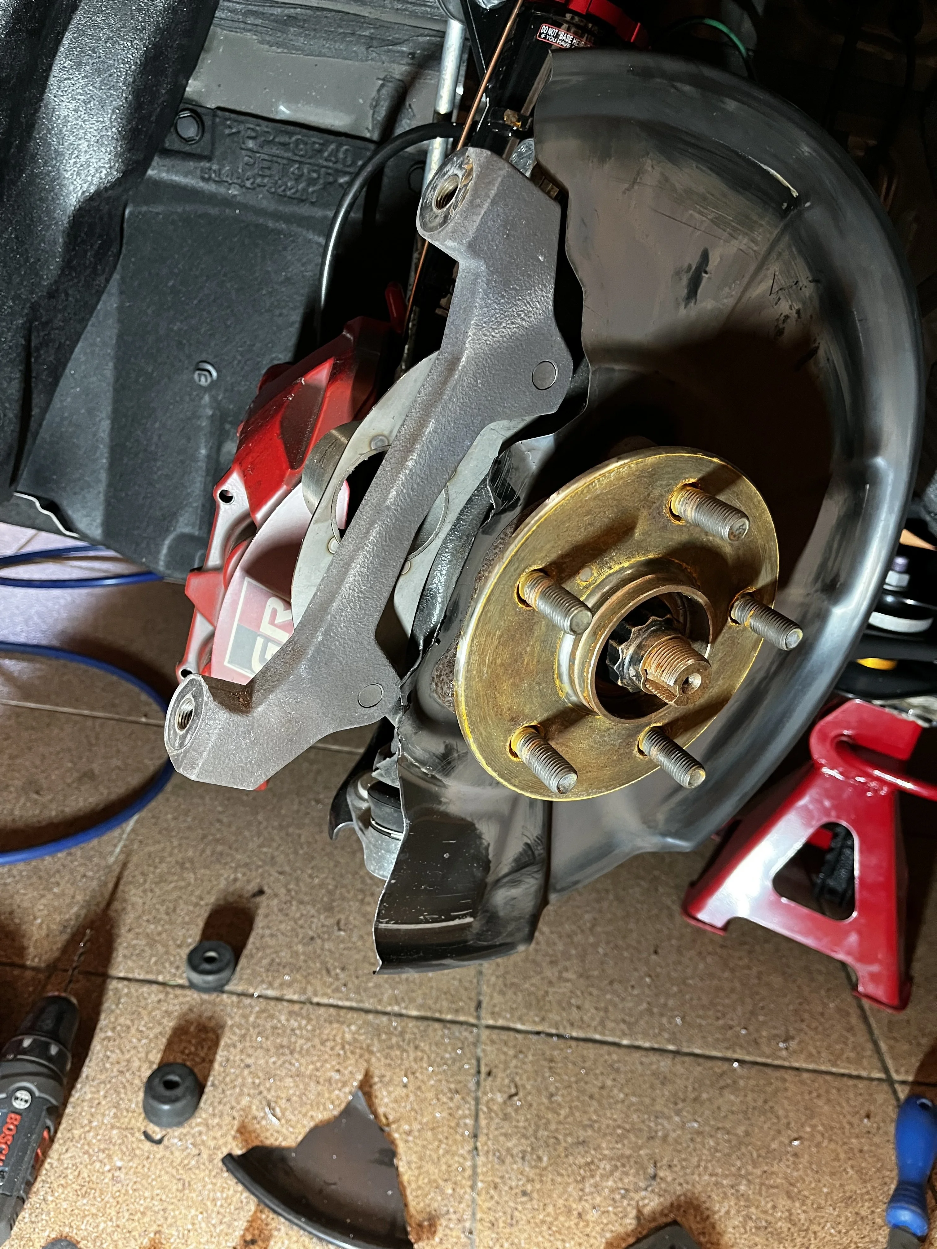

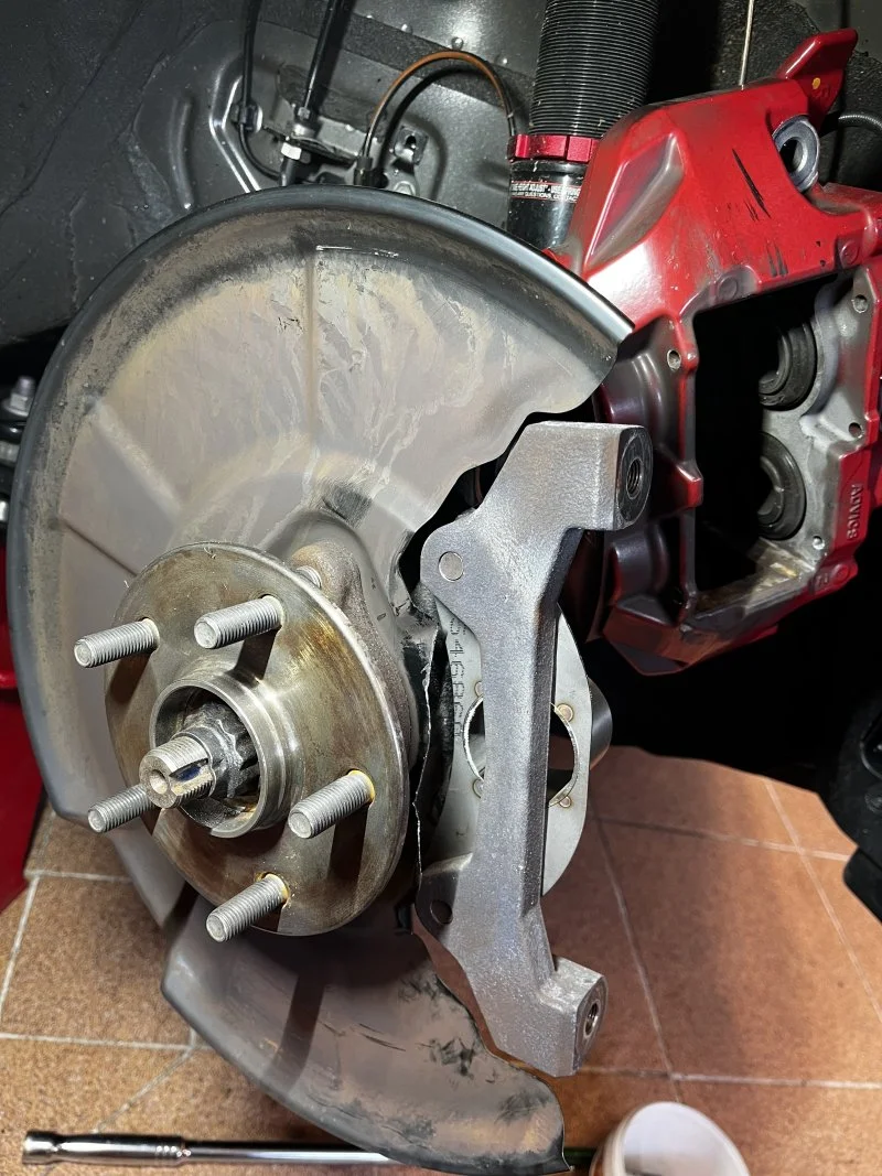

After taking the car out of hibernation in mid-June I installed the complete brake cooling kit and shims from hrnshn-racing.
You have to cut away some sheetmetal from the shield to leave room for the tubeholder, the original brake caliper adapters are in the way for the airflow but you can't avoid that.
looking good
It's tight between my 255/40x17 on 9's and the 3D-printed channel, so tight that the zip-tie were worn off. But when the zip-tie was gone also the sound of something rubbing was also gone. You don't need the zip-tie.
Mr hrnshn hinted about turning the tube so it flexes away from the cv-boot when you turn the steering wheel, it seems to work and my cv-boot's are still untouched.
I soaked the 3D-printed tube in water for some day's to take away some brittleness.
I also tied some zip-tie around the tube and the banjo-bolt on the caliper to keep the tube away (not in the pic).
And then some hrnshn shims and a change to ATE 200 brakefluid.

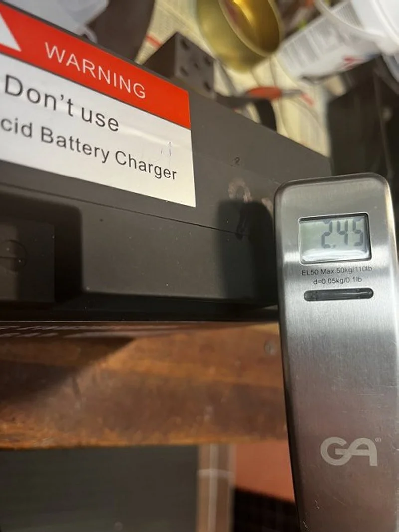

from this 12,45kg "small" 52Ah battery
to this 2,45kg Lithium battery, 16Ah and 1000 CCA, monitoring is possible with the BM6-app

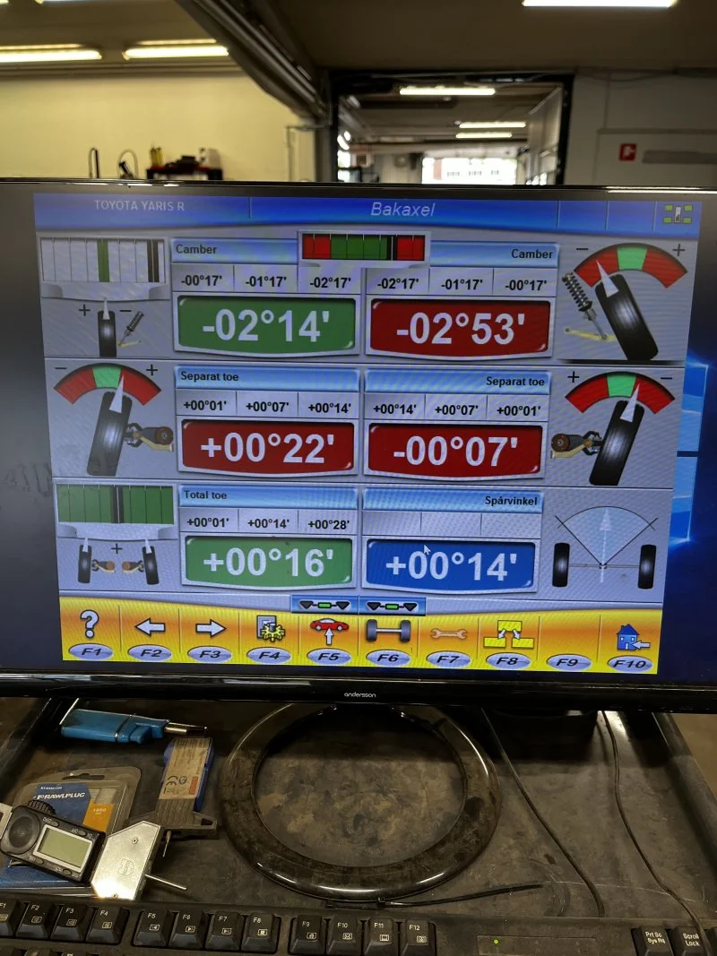

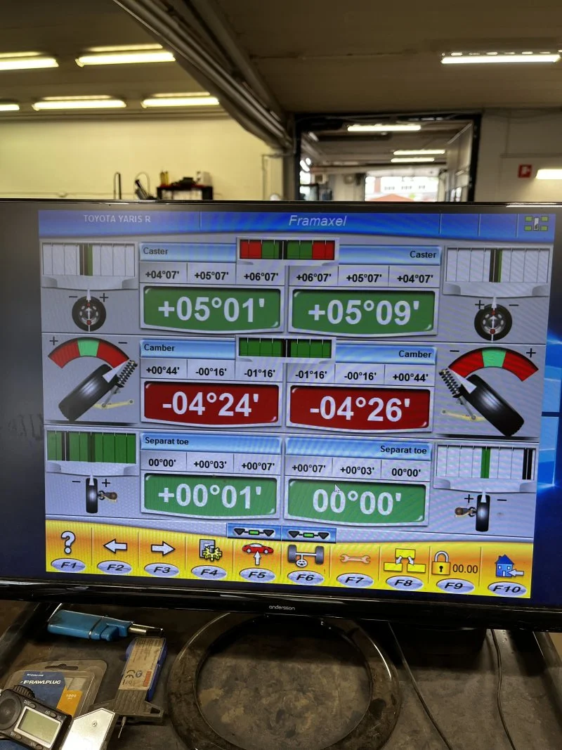

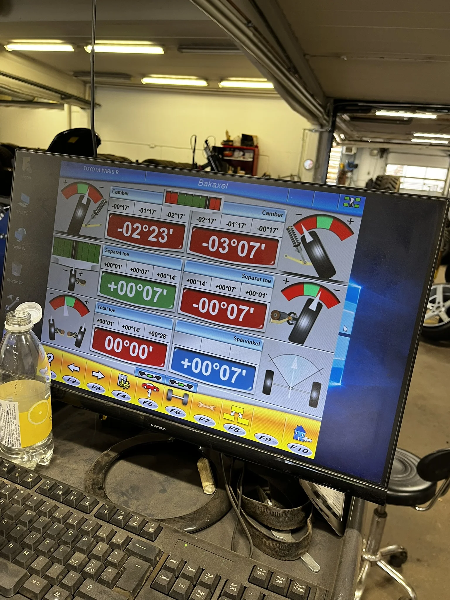

Rear axle: - I got a Track-ace thingie so I can check toe in 5 minutes, and it was way off so ...wheel alignment next showed a lot out toe-out right-rear and a whole lot of toe-in left-rear, not good was an understatement and it was due to a not so tightened camber bracket left-rear.
Rearaxle: - I restored the old setting
Front axle: - restored; it was just the left toe that was a bit off, so the MCA camber lock-bolts had held up perfectly. The caster is also perfect, on a lhd car it has to have a tad more on the right or you have to manually hold the car up against the mid of the road all the time.
looking good

I was very happy with the hrnshn brake cooling, but when I put on the the standard wheels and took it to the first safety inspection (~MOT) the edge on the left front tire was worn down to the fabric. So the standard wheels were rubbing against the 3D-printed air channels, I'd never thought the tires should give up while the 3D-printed part was intact. I have a lot of camber and also the "extra caster bushings" and that may be the problem. I didn't want to fiddle with the brake cooling every time I change between standard- and trackday wheels som I decided to try the Audi RS3 plastic brake ducts.
the rubbing on the air channel
The Audi parts, with some minor mods to make them fit.
I did cut away a bit of the shield

Which brand of battery do you use? I see you also had the same issue as me with the heavy steering. Could you solve it?
I use this battery with an excellent specification (1000 CCA) - https://en.wiborg-engineering.se/produktsida/wiborg-engineering-lithium-battery-racing-16ah
It is not good enough if you use the car once a week or once every fortnight, since the drain will leave you stranded. I haven't been able to start the car with a jumpstarter when it's drained, you have to re-charge it. So I only use the li-battery when I know I will use the car extensively, like when going on a trackday or to the ring. As a precaution you can add the jumpstarter before the battery has become drained.
I have not had any problems with heavy steering on track with the li-battery.

Luckily I did a check on the alignment before the trip, I had toe-out at the rear right and toe-in on the left. No wonder it felt a bit scary in Schwedenkreuz last trip 🥶

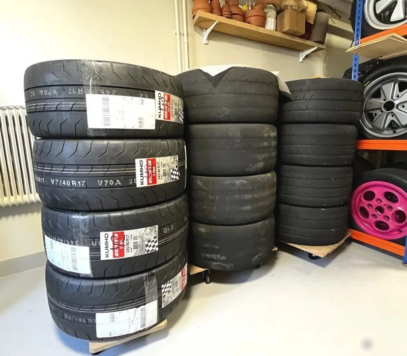

First thing this year was to get a new set of trackday tires, I found a set of Kumho V70A k61 medium 245/40x17" (to the right). The stack in the middle were really worn out, I always save a set of bad tires for autocross. Airfield tracks really kill tires so not a good idea to use new or good tires there, so now the stack to the right get downgraded to bad tires. I have had Kumho's on a light car before and it was almost to drive on glue, and it was an instant feeling. The threadwear is just 50.

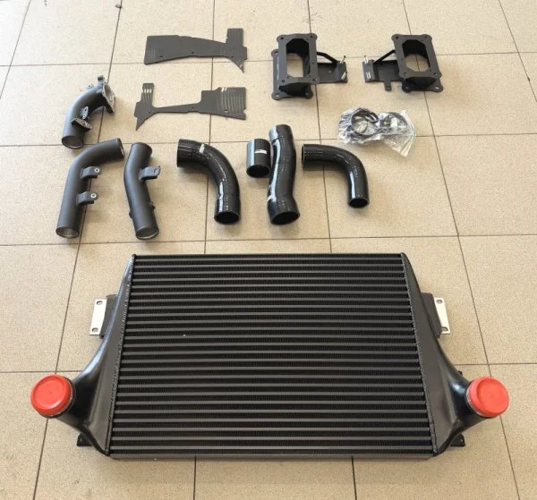

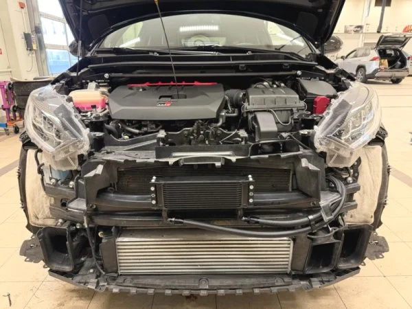

I Black Friday-ordered DO88's big intercooler kit and DO88 oil cooler when I got worried about high temps after I got the RaceChip.
16,36kg and 3,36kg

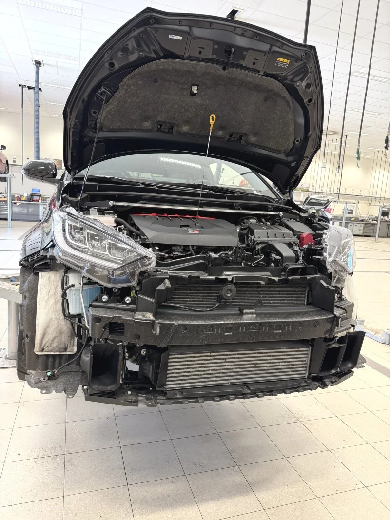

and then the old intercooler and piping and the inside bumper beam foam was removed, so a total of 12,5kg including the extra oil was added in the end.
all the work done at the same time as when the car was in for service at Toyota, this car is not my backyard mechanics car
opened up, the original intercooler is visible
here you see part of the watercooler and in front the condensor

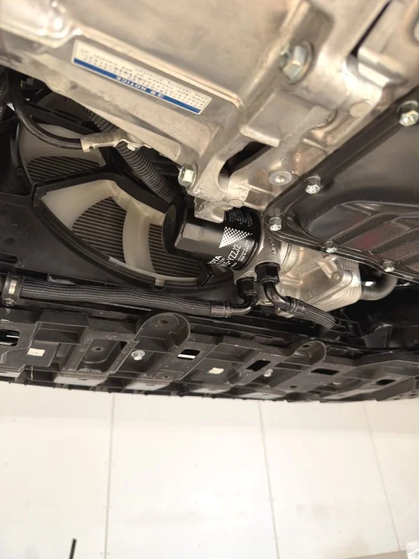

the DO88 oilcooler is a Setrab slimline, here fitted under the condensor
some extra padding was needed to avoid rubbing on some oil lines
DO88 use a Mocal oilfilter sandwich
my mechanic 🤩 found out a larger oil filter from an older Toyota Corolla T-sport is fitting, I have not seen about this earlier
With the oil cooler in place, the amount of oil at service has now increased from 4.4 liters to supposed 5.2 liters, plus I usually overfill 0.3 liters. Unfortunately, it is always difficult to read the oil on the needle as it never gets dirty and that it is thin blask 0W-20.
