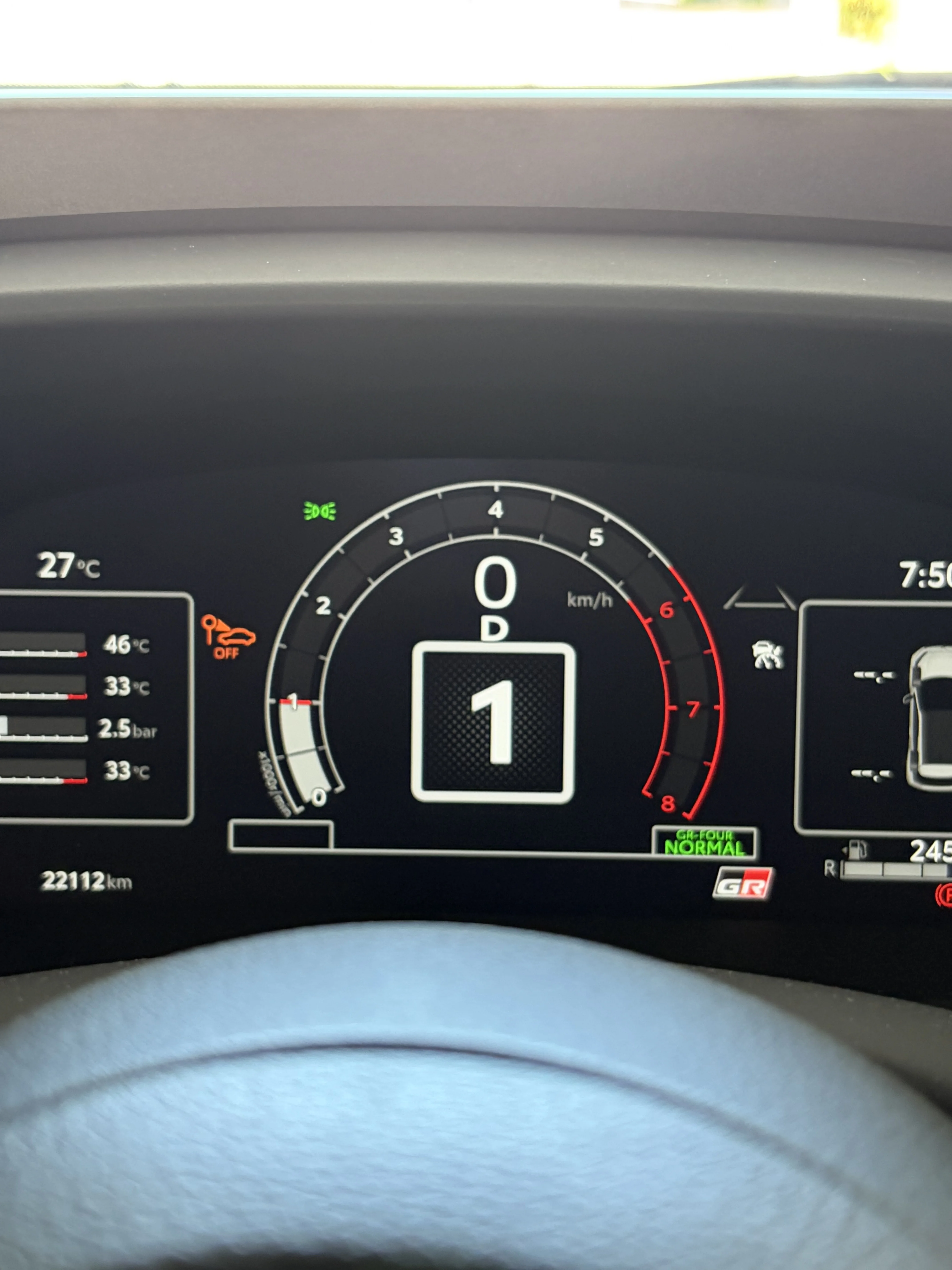

This is mine right after startup (just put into D), so it looks like I have the “original” view. But as other said I wouldnt mind it.
