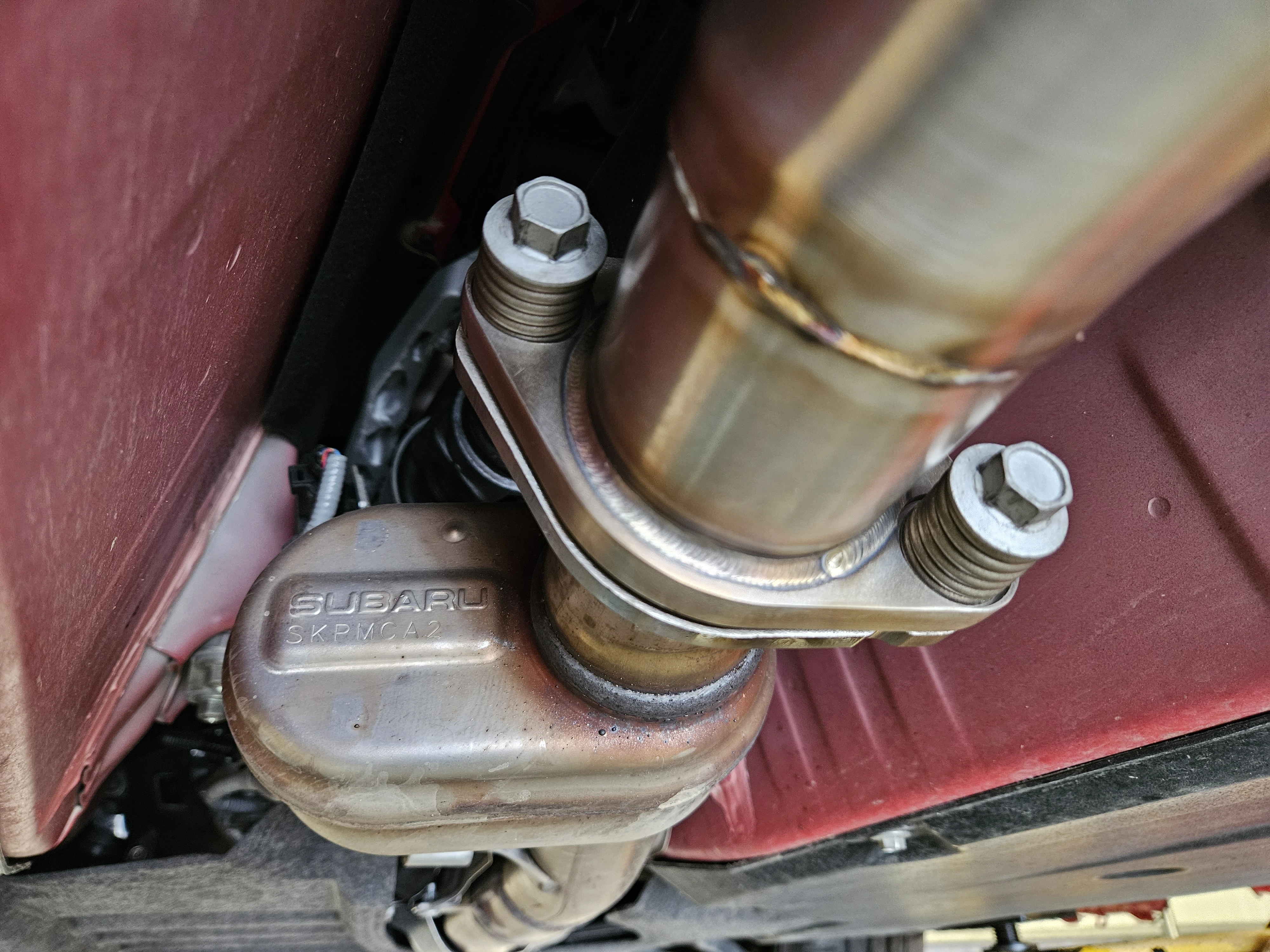

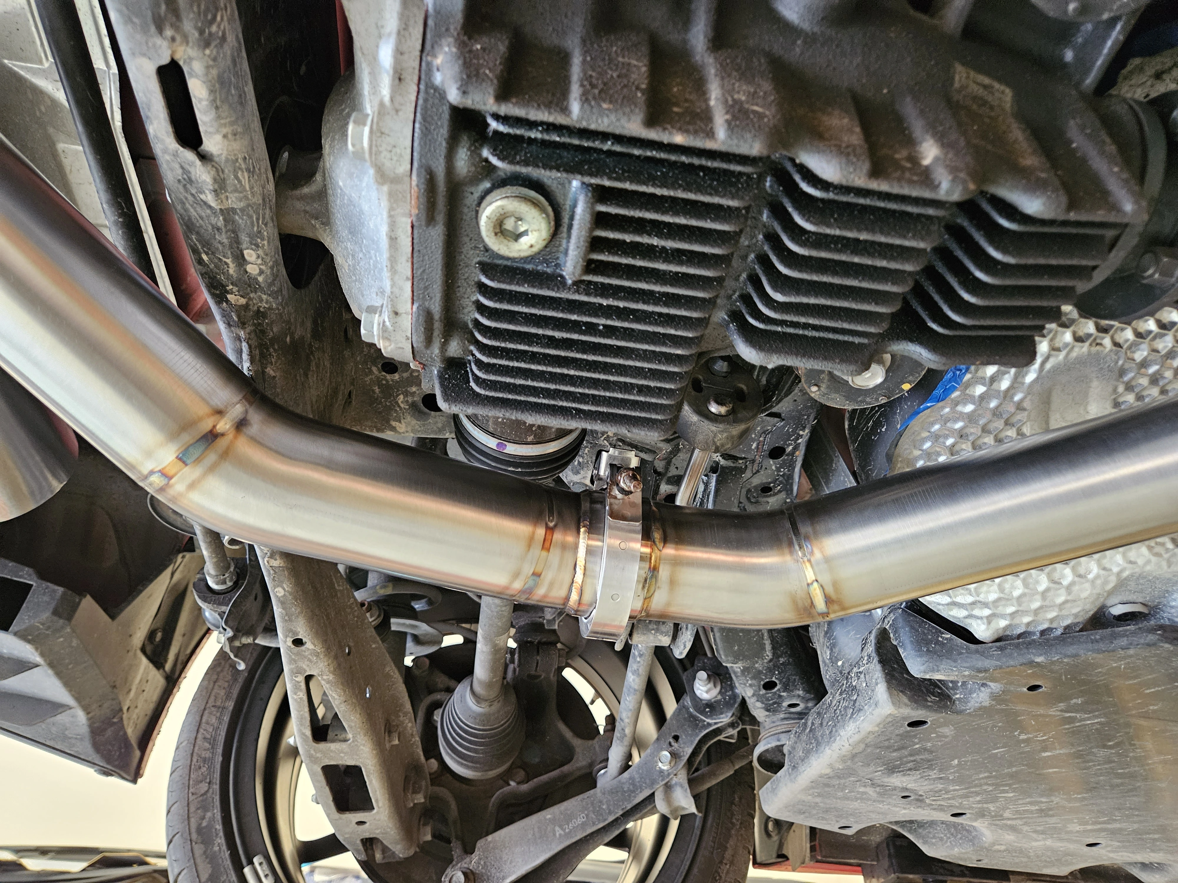

The customer then gets to see the full install process. The ease of install, the accuracy of the fitment to the OEM front pipe flange, accuracy re alignment to the OEM exhaust hanger points and the perfect alignment between the two sections of our systems at the V band connection. A final sign off from each customer on the tail pipe alignment, then it's engine start up time.

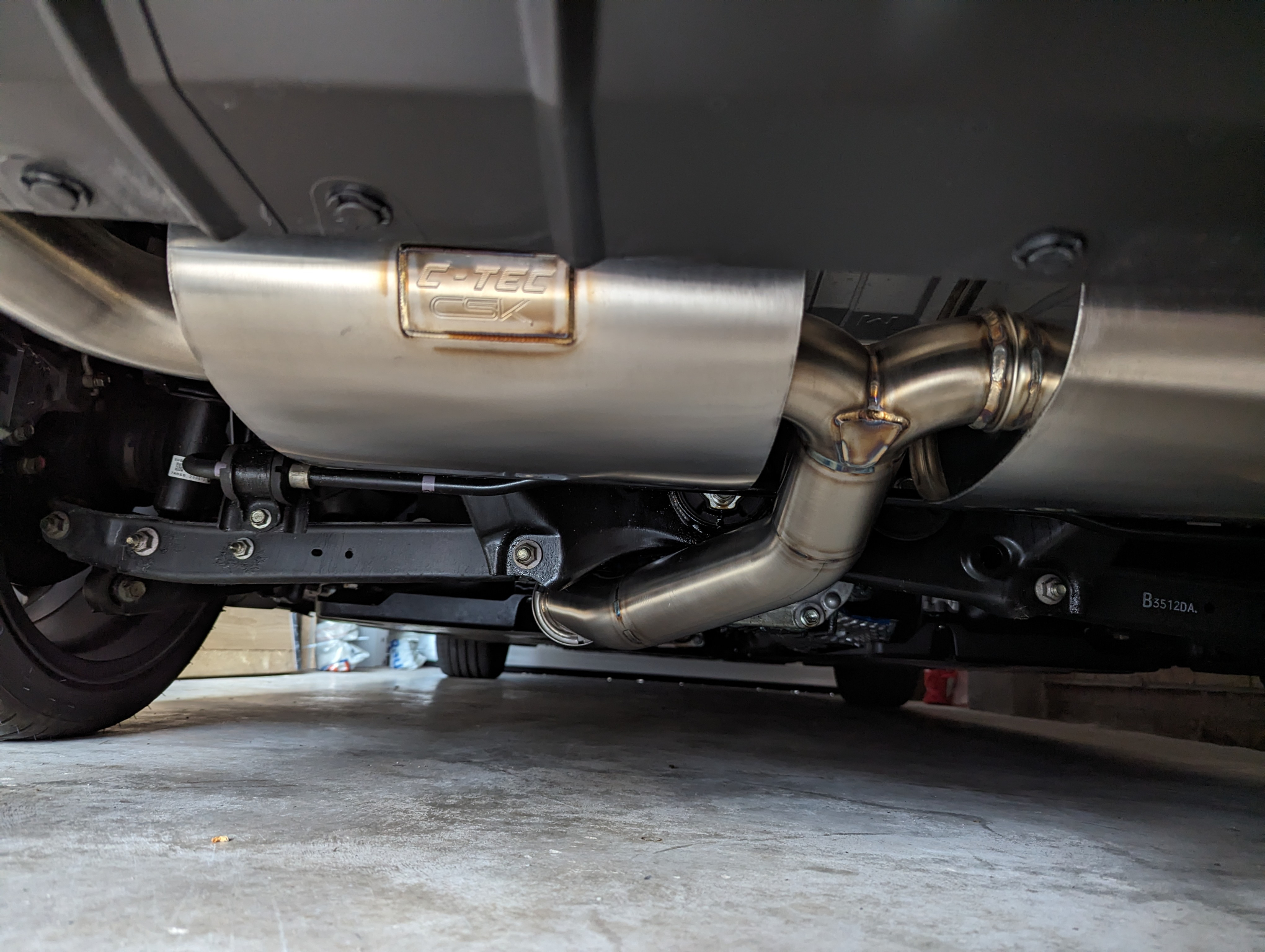

This is my exhaust from @ctecperformance. Firstly I have to say that the knowledge and passion for the product was a massive plus point for me, couldn't fault the experience at all. As for the exhaust itself, really high quality item, in my opinion. Fits perfectly, simple installation, and sounds fabulous. I've gone for the single wall tip option at 4.5inch others were available.
Cold start video below and some images of the system on the car. Its on my driveway in this video boxed in on all sides by a wall and fence.
Driving, the exhaust has a lovely tone which is changing in intensity throughout the rev range. I think so far my favourite is 3.5k - 5k. really nice induction noise and exhaust tone as the rpm increases. In 6th at 50 and 70mph system is really daily usable, in town at lower speeds and low rpm system is calm and not in anyway offensive to the locals. Down changes with some extra throttle input you're treated to various cracks and pops which is a very welcome change over standard.

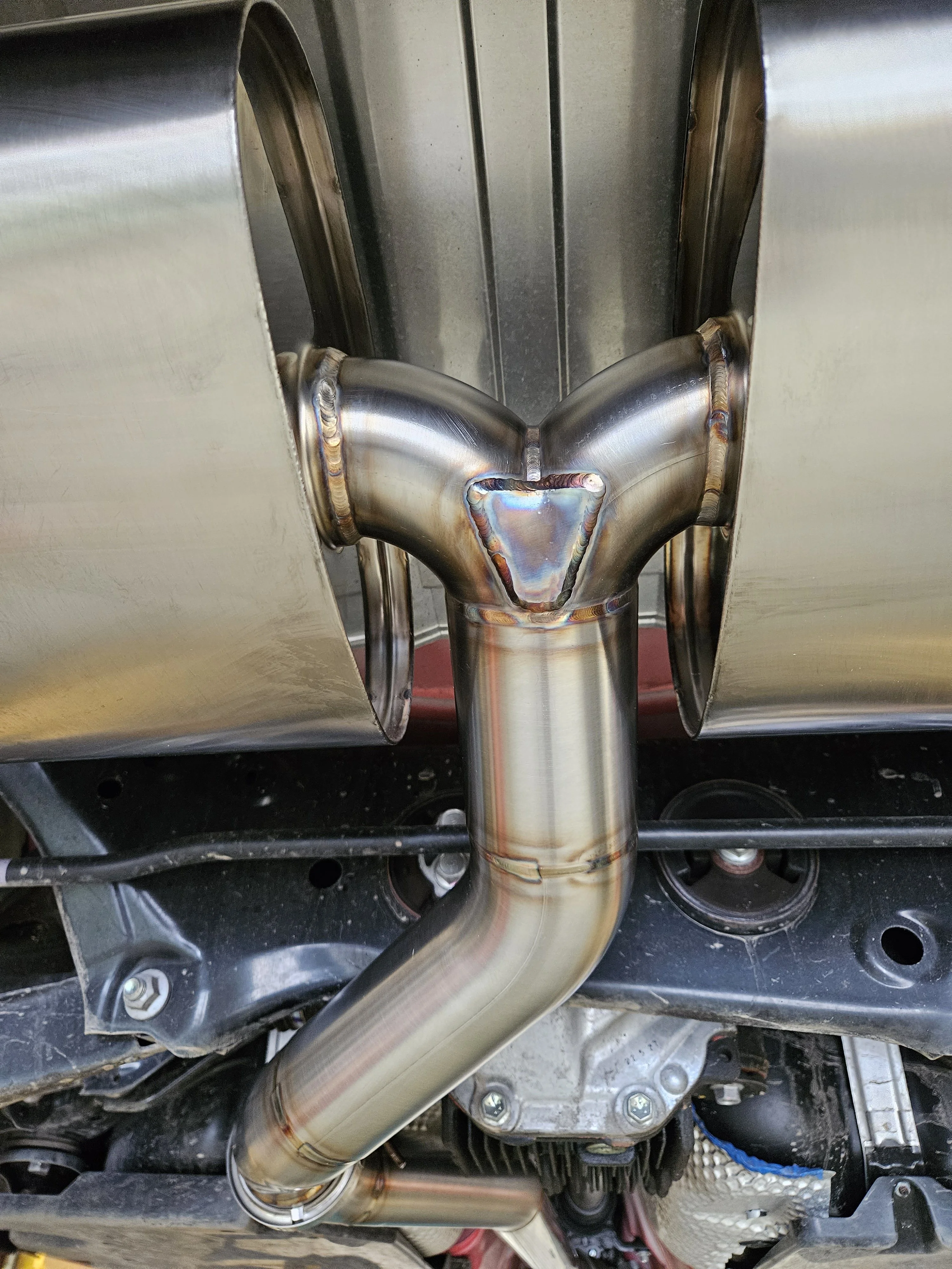

To be fair and honest as an ex Plumber that has worked with pipes and welds.....why does the insert piece that joins the 90 angle into the box exist...theres a pipe fill and welds to cover that shouldn't be there to my eye!!
The manufacturer signage appears to have missed a full course of the welding to attach it.
And to be totally honest why dont the tips fill the cut out...surely thats the point to work back from for the sounds ?

This isn't an insert, this is a plate brace to strengthen this area. This system is fabricated using a thin wall 1.2mm SS rather than the typical 1.5mm so it's a precautionary measure. We want our system to last.
I agree, from a purely cosmetic perspective, it would look prettier without the plate brace. However, as a manufacturer, we've taken the decision that function and durability wins over cosmetics here. It's worth noting, this small brace isn't visible with the system fitted, car on the tarmac.
The brand plate has a full perimeter TIG weld. It may be the angle/lighting on the photo as you're looking at it.
We offer both 4.5" tail pipe and 5" tail pipe options. With a 0.5" diameter tail pipe difference, there is no audible difference. We offer this to give the customer a choice, and thus far 75% have opted to go for the 4.5".

Can confirm the plaque isn't going anywhere ;) fab work and fitment is superb.
As for the tips filling the cut out, it will be the angle of the photo, they fill it out just fine and are just as long if not longer than some other exhausts for this platform.

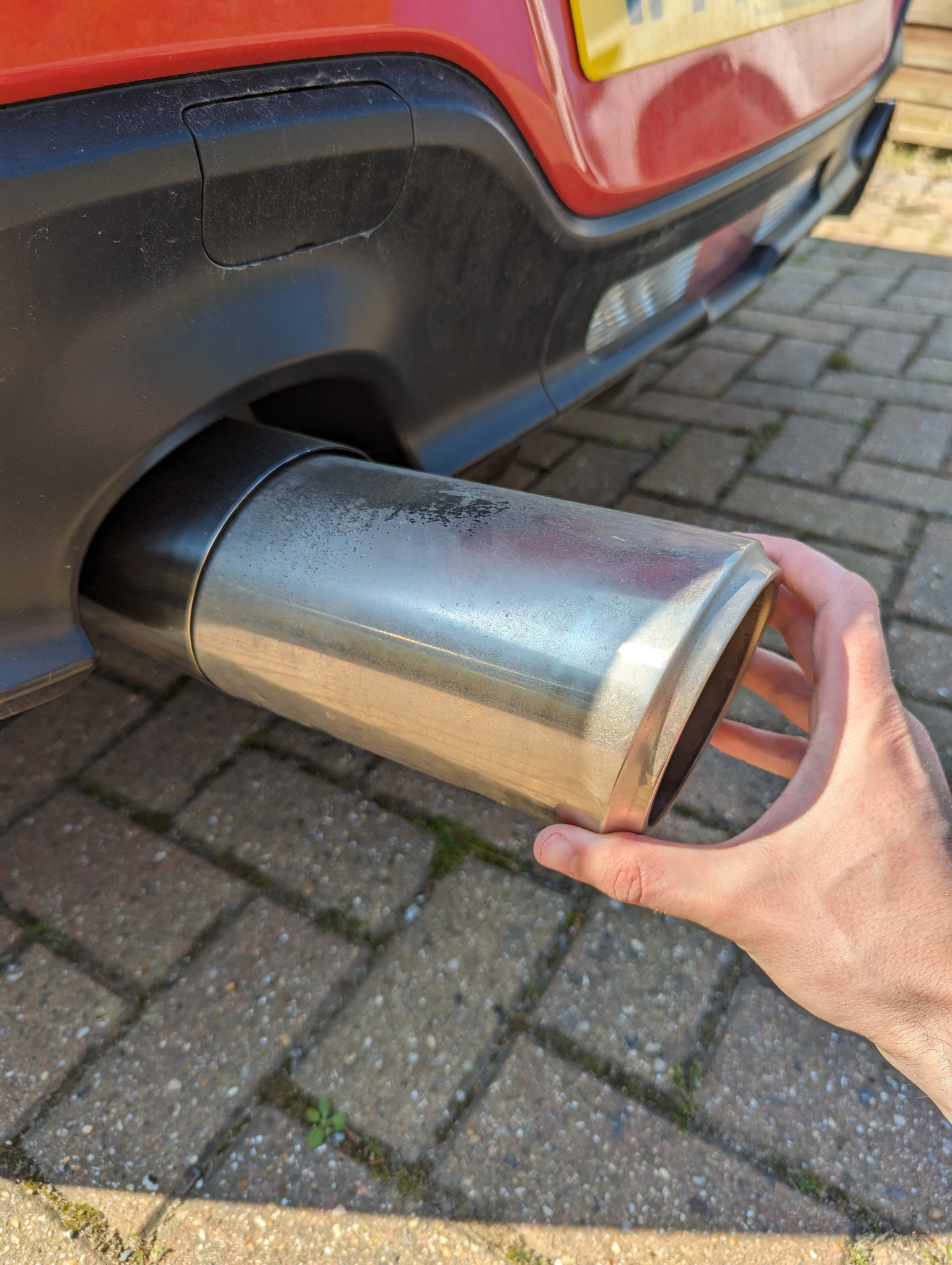

It's a bit of an illusion, single wall tips or those painted black look bigger. Think a small alloy wheel with a fat tyre and a large alloy with a rubber band tyre, both will have the same OD but the larger alloy will always look bigger.
For reference this is the stock tip against the 4.5" twin wall slash cut. Very similar, I wouldn't recommend going smaller as they will get lost in the bumper cut outs (which are pretty big!)
Personally I am also not a fan of massive exhaust tips, those fitted on my car are temporary. Charlie from CSK who is a partner with Nigel at CTEC has fabbed me up some lovely chrome twin wall 4.5" tips. I will post some photos when they are fitted.
