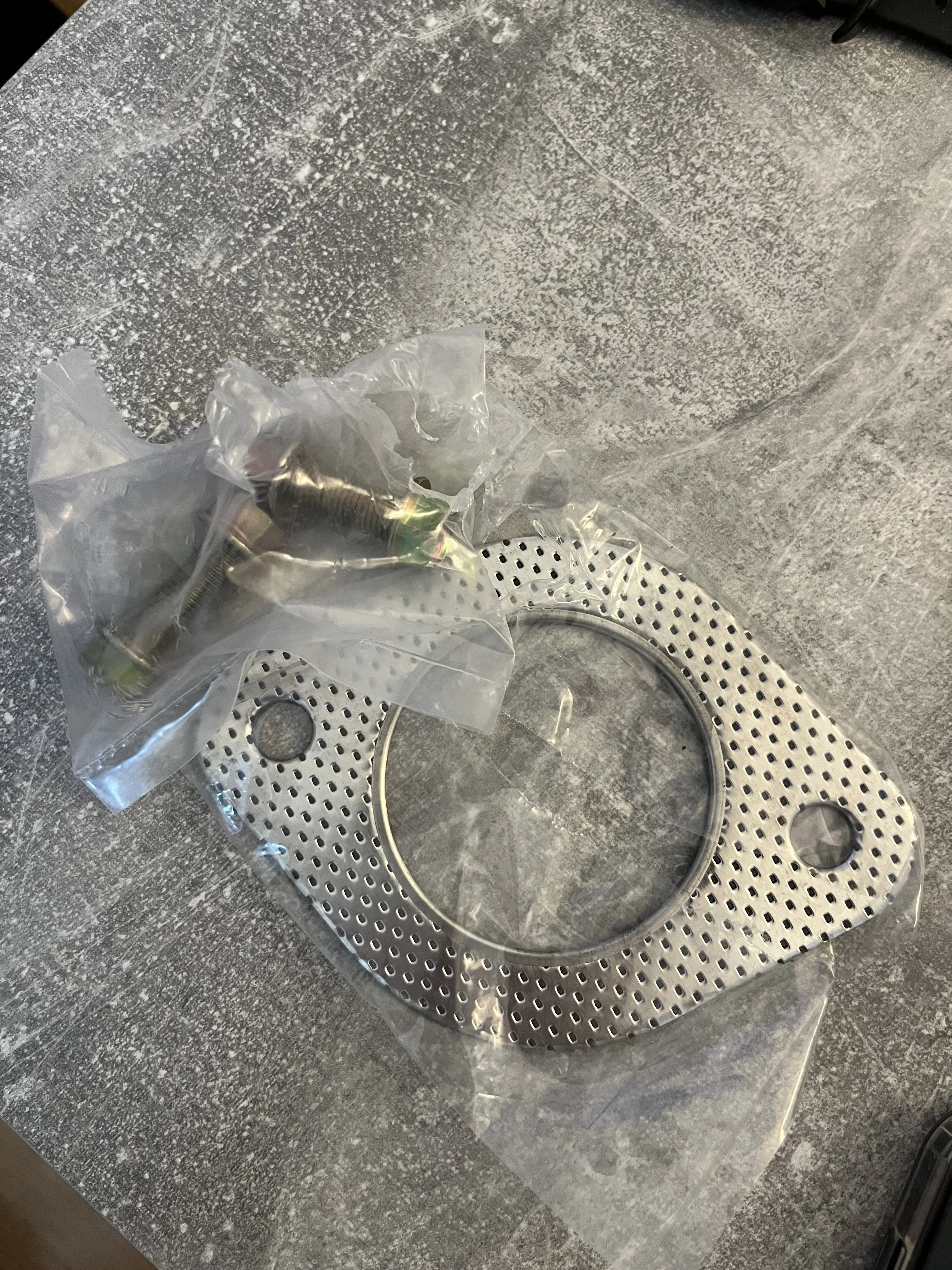

I finally installed the Remark Axle-back. What I find strange though… I received an additional flange type gasket for between the OEM stock midpipe and the Remark Axle-back… first I thought that it’s a spare gasket for the axleback but the size is actually different and fits perfectly on the rear of the stock midpipe…
This gasket is not mentioned in any instructions provided by the seller nor on the official Remark page… all instructions manuals and videos say to install the axle-back using the stock OEM gasket ring.
Anyone had the same?
I just installed the axleback on the stock ring type gasket per instructions, just wanted to check if I am not missing something?
