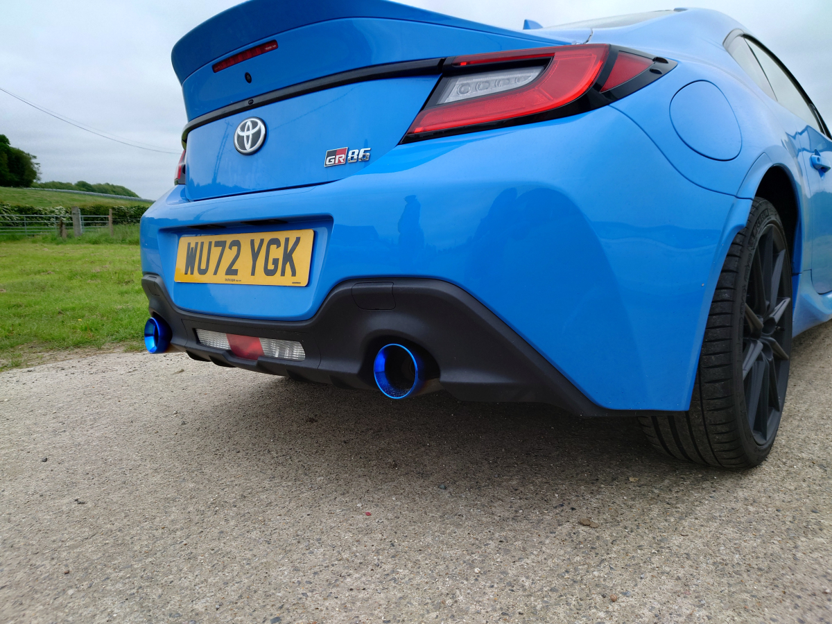

I like blue exhaust tips, they compliment the car nicely. πŸ‘Œ

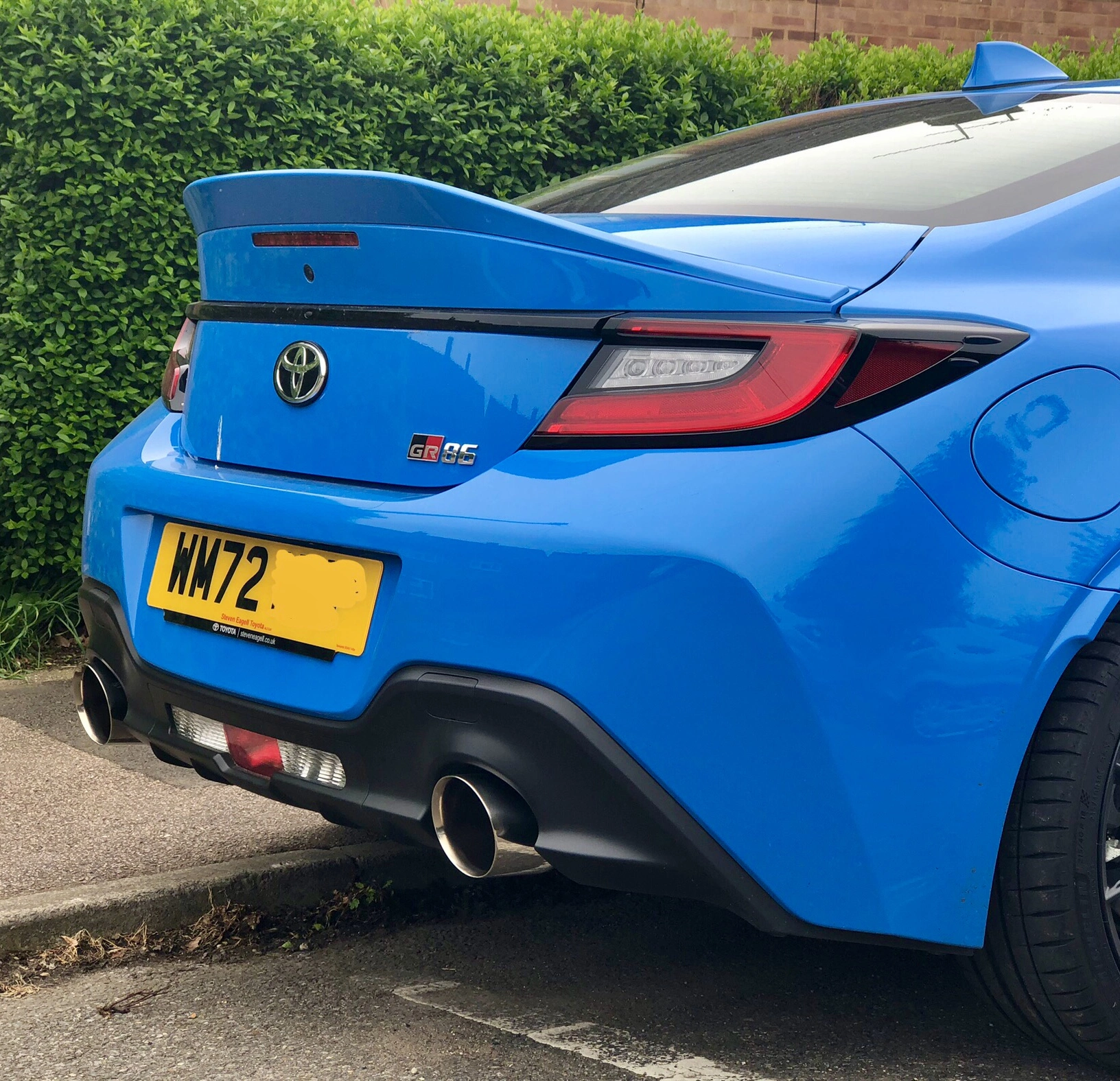

Remark on. Fairly easy job and it sits nearly perfectly.
Quite fruity! Transforms the car though and genuinely makes it easier to drive at low speeds.

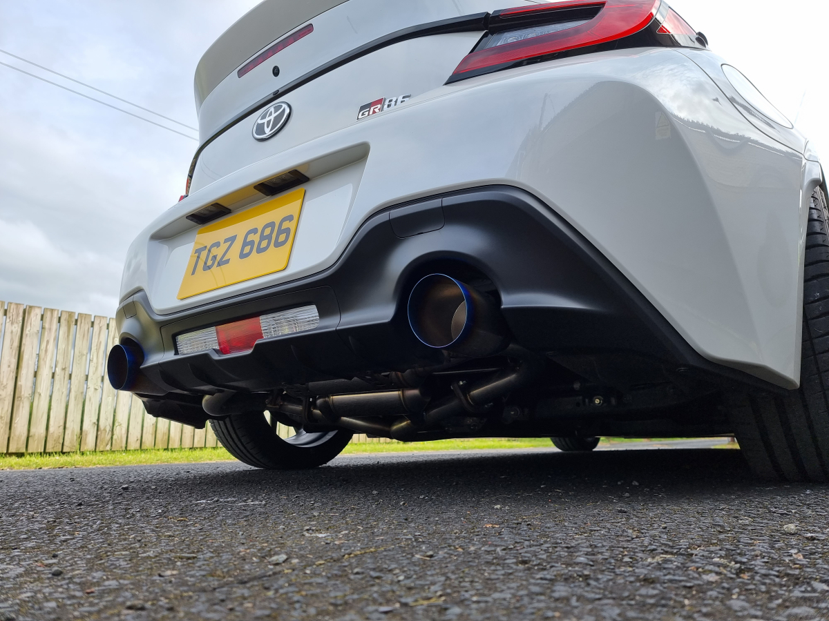

Another exhaust to add to the many choices available.. Fujitsubo A-R exhaust with the optional blue tips (supplied by Torque GT).
Stunning design and compliments the car really well. Not very loud, but a nice proper grunt when driving. No drone at all when driving at 60 / 70. The only thing I find odd is the lack of noise in the top end, when you are really pushing the car.
Would love to see (hear) what a front pipe would add to the system, but guess not an option yet with the GPF. Apologies, no videos available yet... on my to-do list.
Most systems will be like this because of their use of absorption type silencers. Nice at low end then fade away up the top end. Whilst a front pipe can sort it, it will be a MOT failure when it comes to it, unless you manage to get a GPF in an aftermarket pipe.
