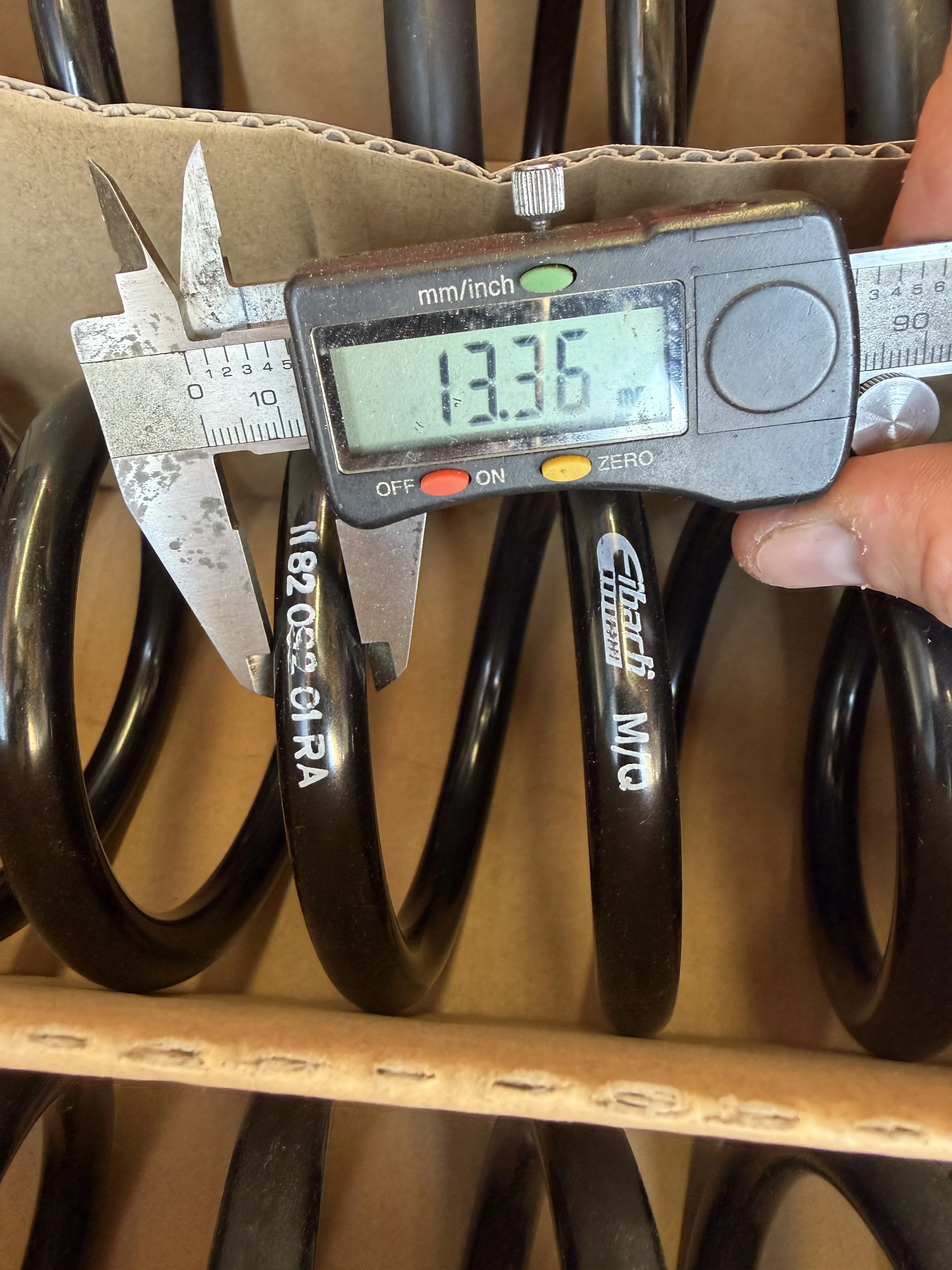

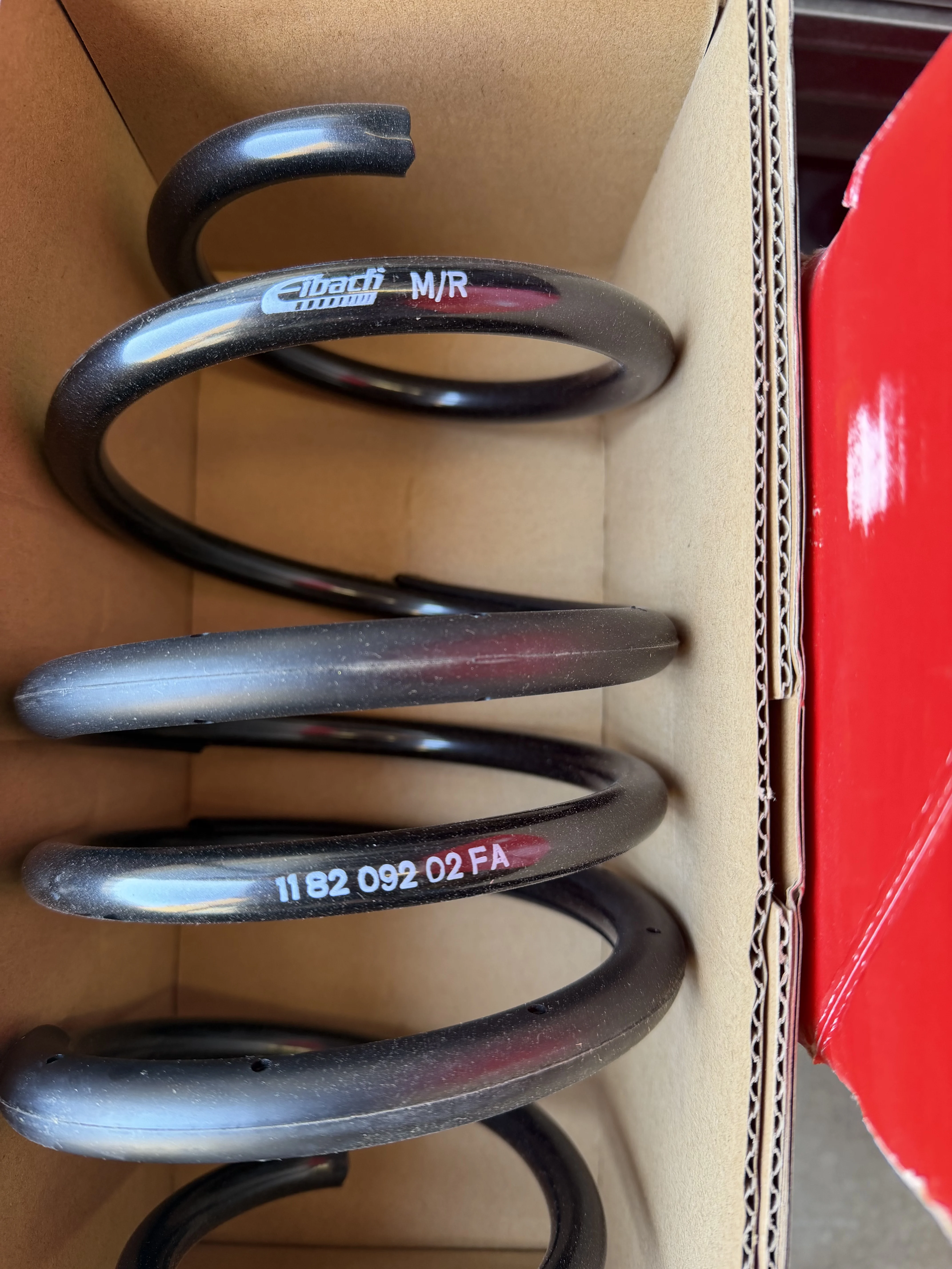

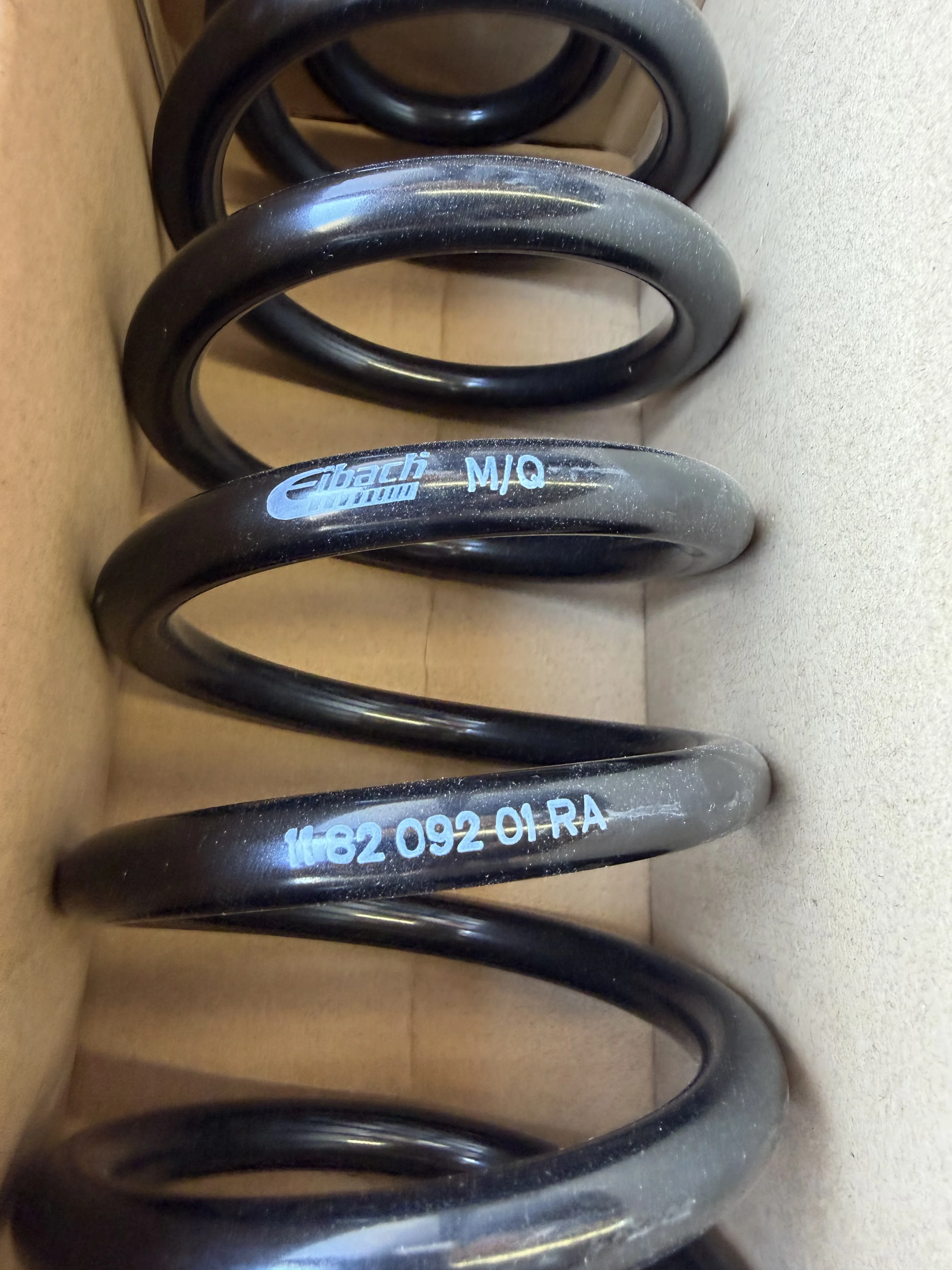

So I got the kit today and then put the part numbers and everything into ChatGPT just to do an analysis. Here is what it’s found.
So for the Facelift Gen 2 it it seems like the rear was not changed so exactly the same as a GEN one kits but the front springs are different on the GTS which is consistent. It seems.
I checked the markings in your photos against current Eibach listings. What you received appears to be the correct Eibach Pro-Kit for the Gen 2/facelift GR Yaris, but there is one interesting detail with the front spring marking that is worth explaining.
Your box is clearly labelled E10-82-092-02-22. Eibach lists that exact kit for the facelift GR Yaris GXPA16, with a nominal lowering of about 30 mm front / 25 mm rear (Eibach itself describes it as roughly 25–30 mm each axle).
What you have
FA = Front Axle and RA = Rear Axle.
So the two larger springs in your third photo marked 11-82-092-02-FA are the fronts. The two springs in your first photo marked 11-82-092-01-RA are the rears.
A current Eibach specialist listing for E10-82-092-02-22 specifically gives the replacement spring markings as F11-82-092-02-FA front and F11-82-092-01-RA rear, which matches what is physically in your box.

Your new Gen 2 kit has the revised 02-FA front spring. That’s consistent with the current parts listing for the facelift kit. So I would not be concerned that the front says 02 while the rear says 01. It appears Eibach revised the front spring for the facelift while retaining the rear spring specification.

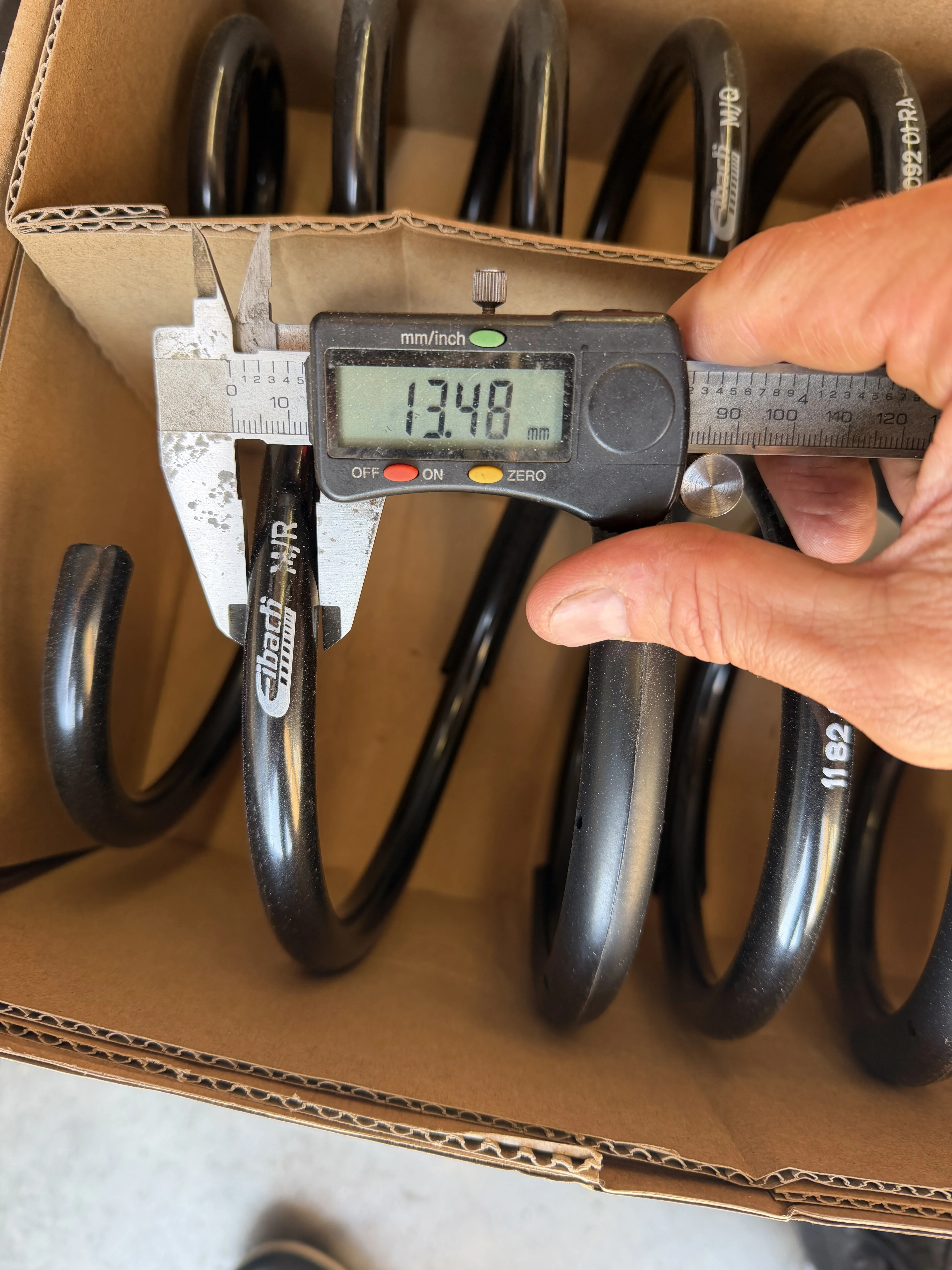

Because you’ve physically got the springs, we can get surprisingly close to calculating the rear spring rate from the spring dimensions. The rear is particularly straightforward because it’s linear.
If you can give me the wire diameter with vernier calipers and I use the coil dimensions from your spring, I can calculate the rear rate in N/mm and kg/mm. We can also estimate the front’s working-rate range.
