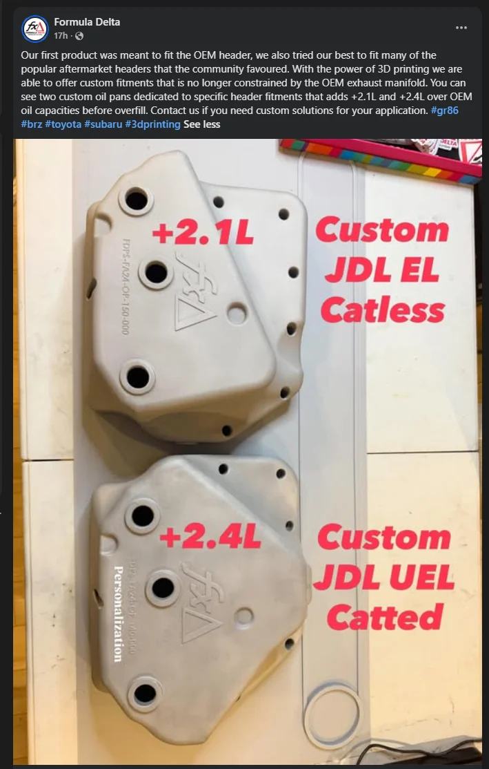

I originally ordered the oil pan, to go on my first gen BRZ which now has an FA24 swap 😲 - I've been meaning to do a post about it, but just haven't got round to it and its not been as straight forward as first imagined, so I've also lacked motivation to do anything in that area . 😔
Althought I'm hopeful it should be finished soon, finger crossed it'll be ready for Japfest in a couple of weeks. Once its finalised I'm planning to do atleast two trackdays before attempting to fit the pan, that way I can get some inital oil pressure date to reference, so it'll be a couple of months yet. The car currently has an ACE CS400 exhaust manifold, so I'll need to see if it fits alongside this manifold.
And if it doesn't fit, I've already planned for that. Initally the plan was for it to go on my brothers GR. However since I've had the FA24 conversion, I'm actually considering changing the exhaust manifold, why. The car is also fitted with a Harrop supercharger 😁. The ACE CS400 manifold, is designed for low end torque which was perfect for an N/A FA20 application, however with the PD supercharger I don't need a manifold with low end torque, I need top end power / torque, not that it doesn't make enough power as is. Also since FD have announced the 3d printed pans with extra capacity I might order one of these, and then the cast pan will go on my brothers GR.
