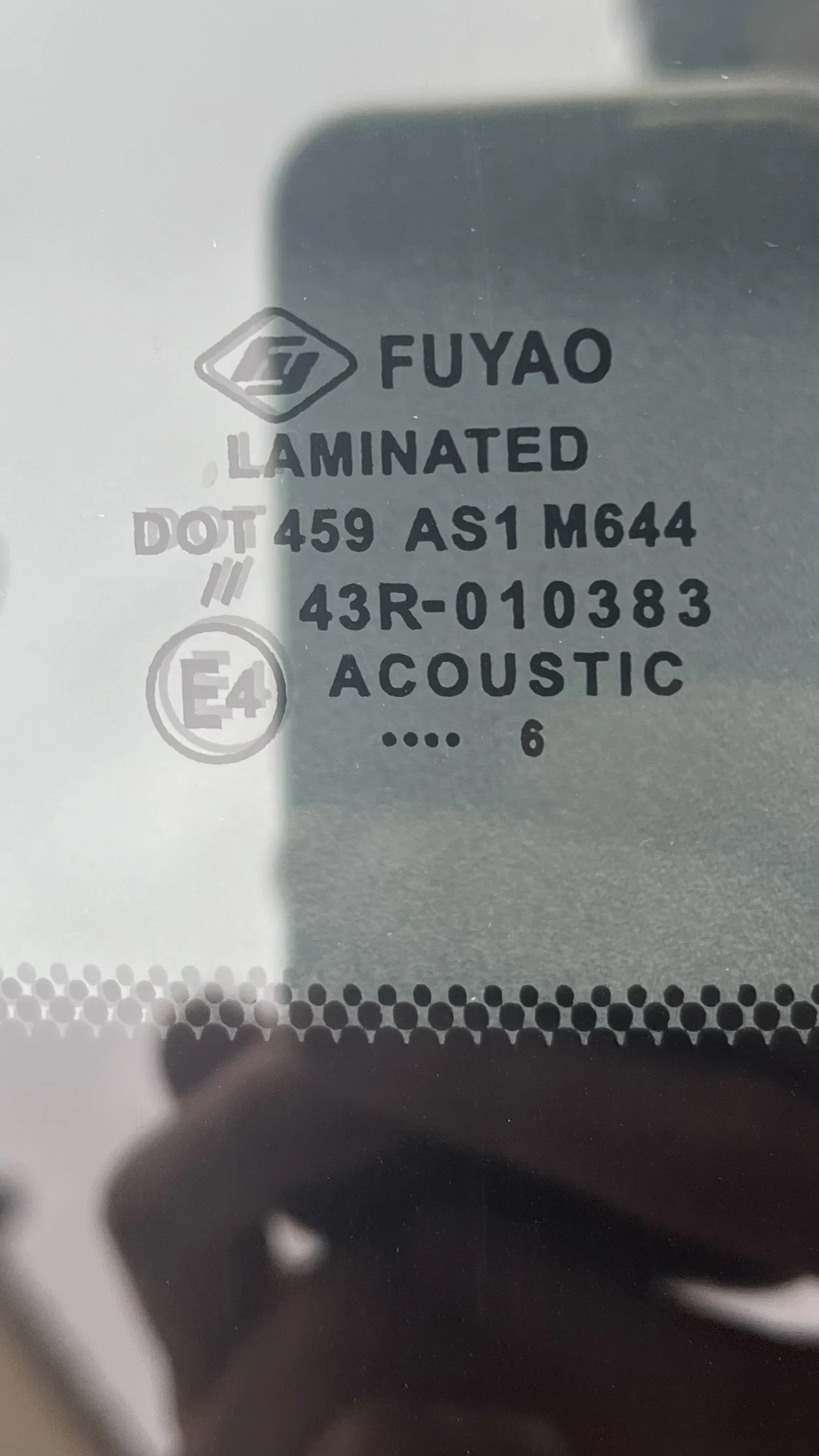

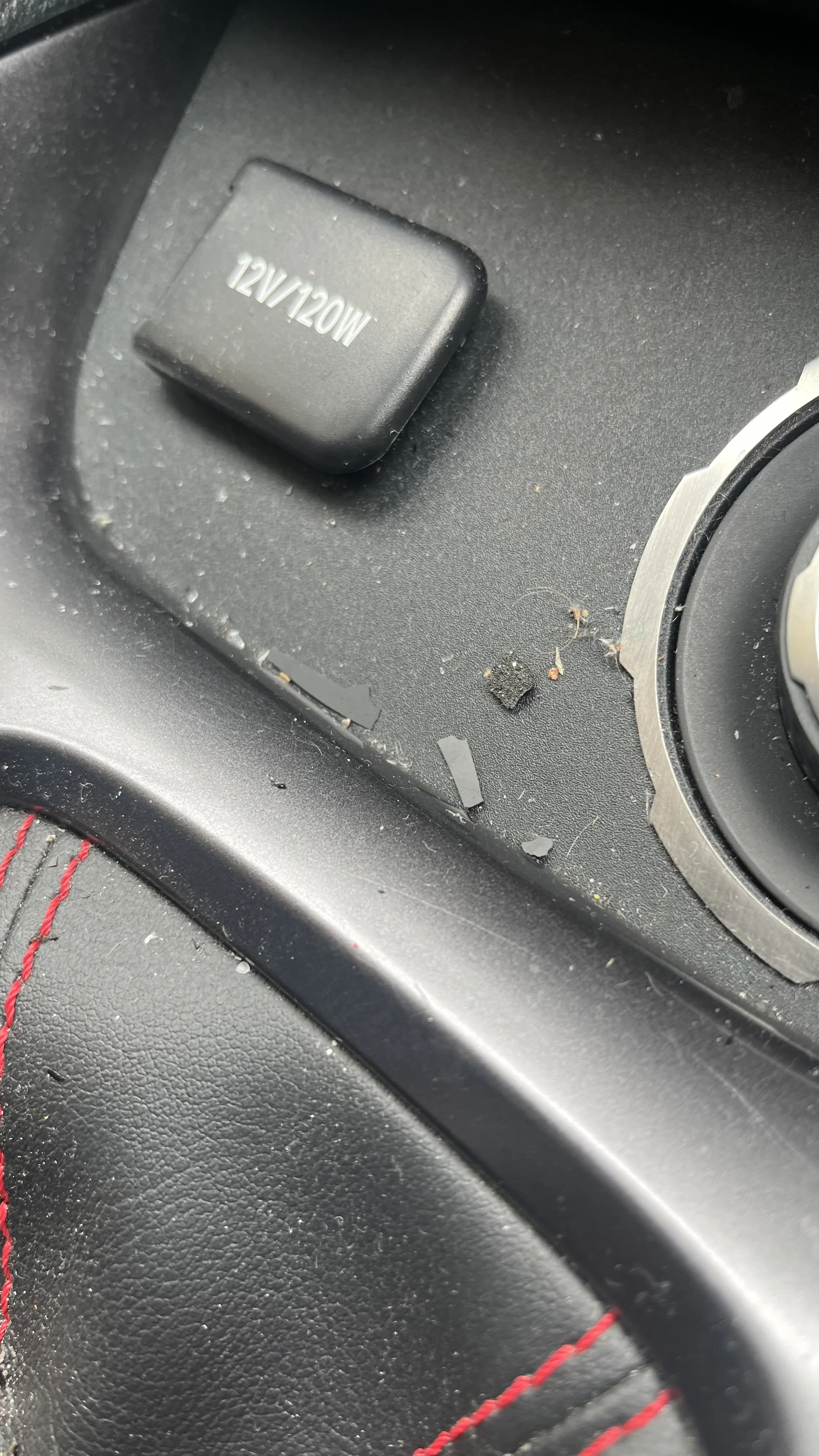

Out of interest do you have a picture of the windscreen used? Mine was non Toyota and in a way hoping that it is a bit more robust, but having some questions about the tidiness which naturally makes you worried about the job that was done (eg found some small bits of glass on the dashboard and some old sealant, they could have at least hoovered). I would’ve mentioned at the time but it had taken 3.5 hours wait despite the quoted 2, and I needed to get back home. Sure there is a new rattling noise too when I hit bumps. But main thing is that it’s sealed properly and is the correct windscreen, that’s my main thought.
This is the windscreen they put in, plus some of the debris left. Not impressed.

That's very poor job. Fuyao are cheap Chinese screens I wouldn't want them in my GR. Did they also scratch the plastics or where they already like that?

Yeah it’s rubbish, and you just want the problem fixed (crack was spreading), in hindsight I should have insisted on Toyota screen if it cost more but there wasn’t an option on booking so I assumed it would be a direct swap. And while the car was being done, you trust they’d check in (but they didn’t).
Generally was a rubbish experience all round. Some of the scratches on that surround were me, I use it as a daily car but all the debris etc was from them. I just hate when people don’t have any care or pride in their work (or others’ property).
I’d like to live and learn but it’s a bit hit or miss with something like this as only chains seem to do it, and not like it’s a regular thing so unlike tyres and wheels, might never be requiring the work done again. I posted elsewhere as I’ve now located the rattle but there’s still shards that I’m finding between the dash panels. But sour taste for sure.
