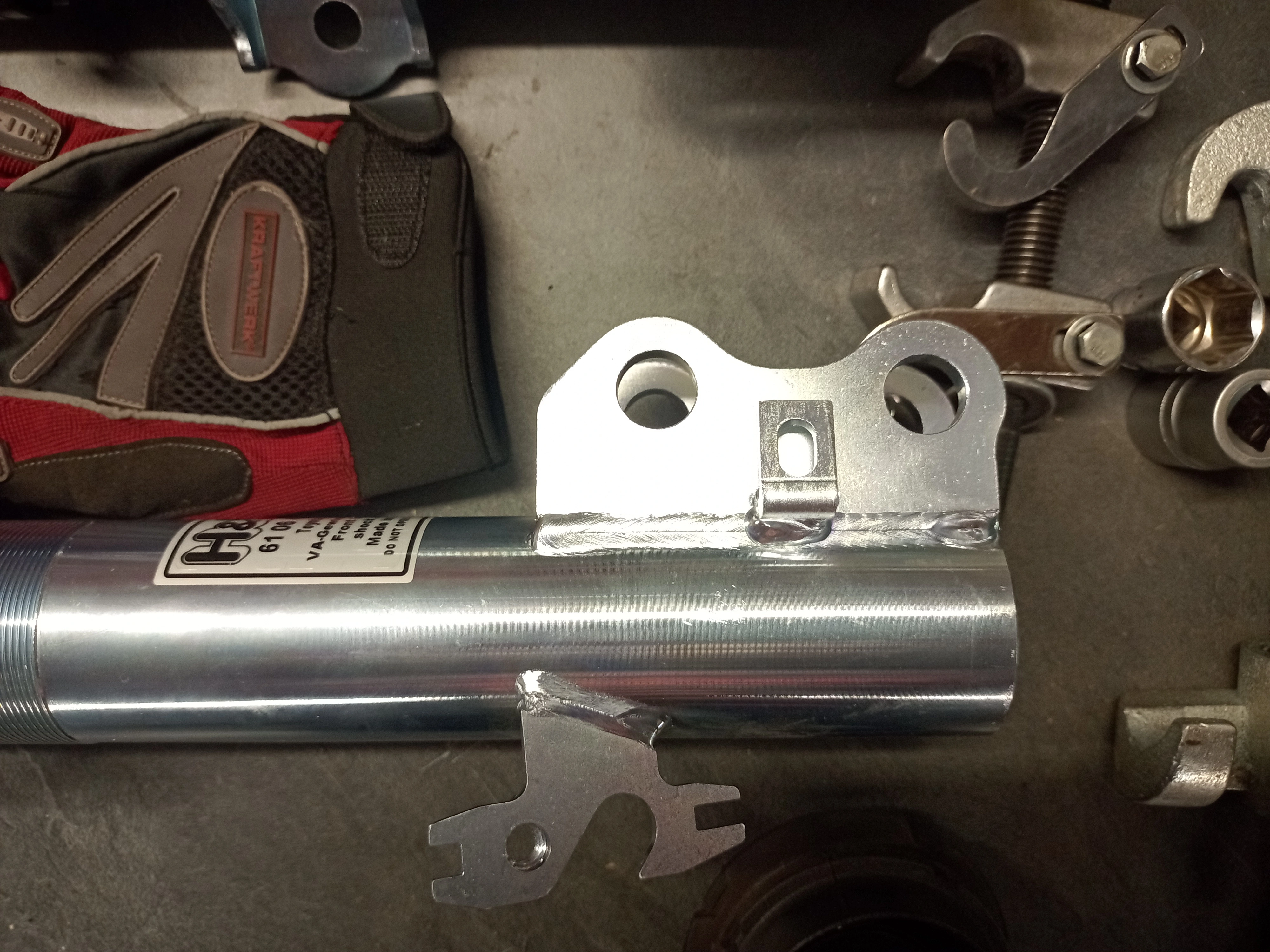

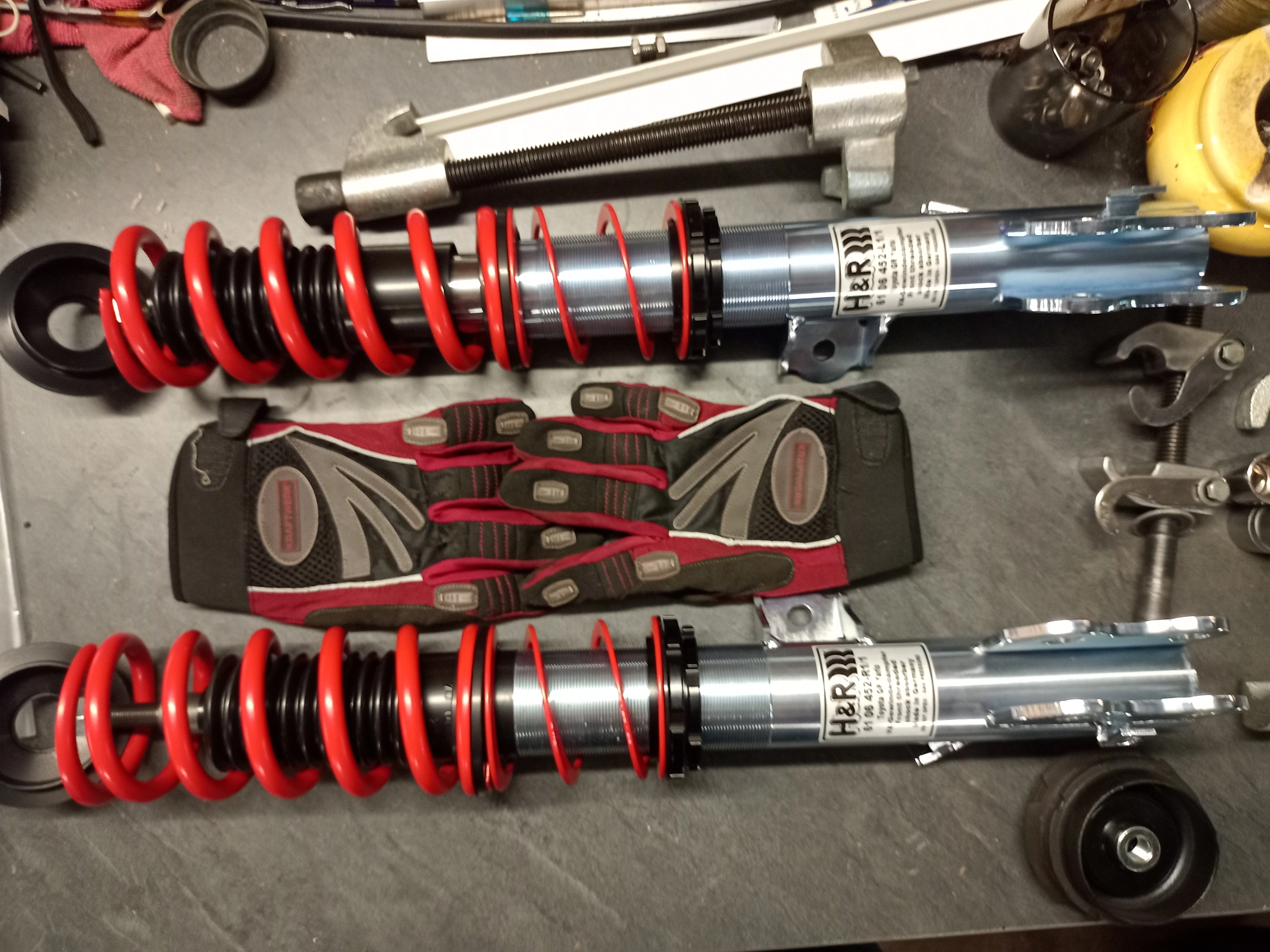

For those who would like to see how the basic H&R look like. No slotted hole for camber adjustment like they sometimes do for other car brands. No damping adjustement of course, and not as stiff as we might initially think given the numbers in the chart above. A good compromise for someone who doesn't want to radically transform their GRY, or get lost in settings.
View attachment 18377View attachment 18378
These aren't the H&R Clubsports, right?
Does Bilstein do clubsports for the GR Yaris? Haven’t found them anywhere and haven’t heard anyone discussing them so far… just curious really

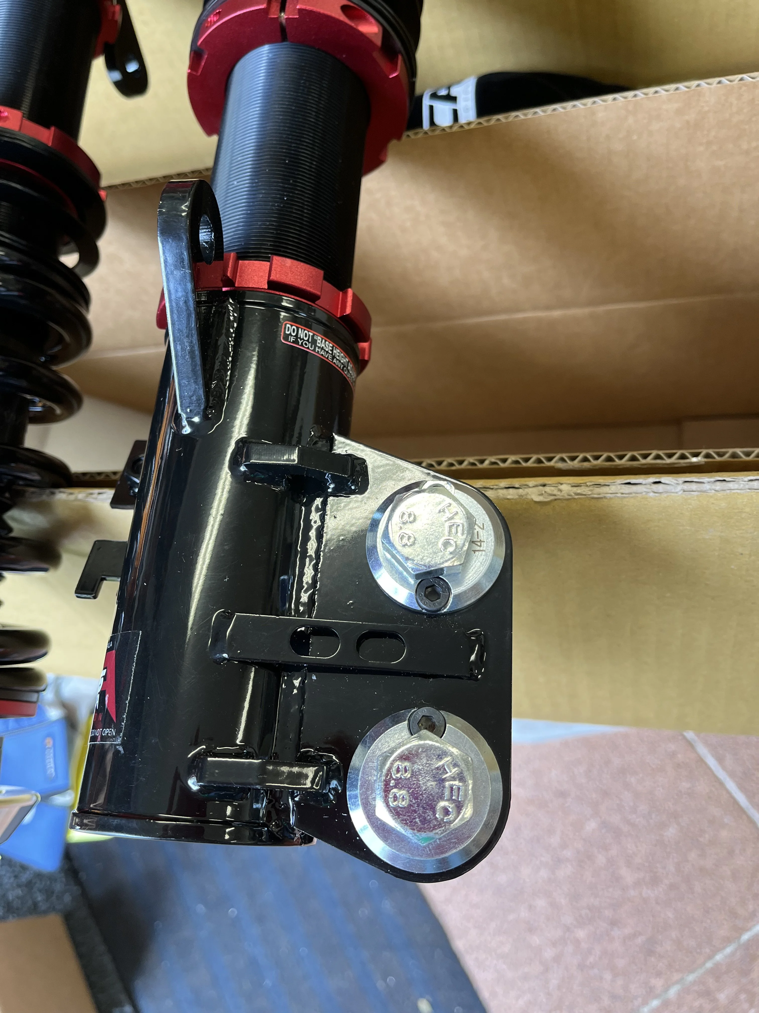

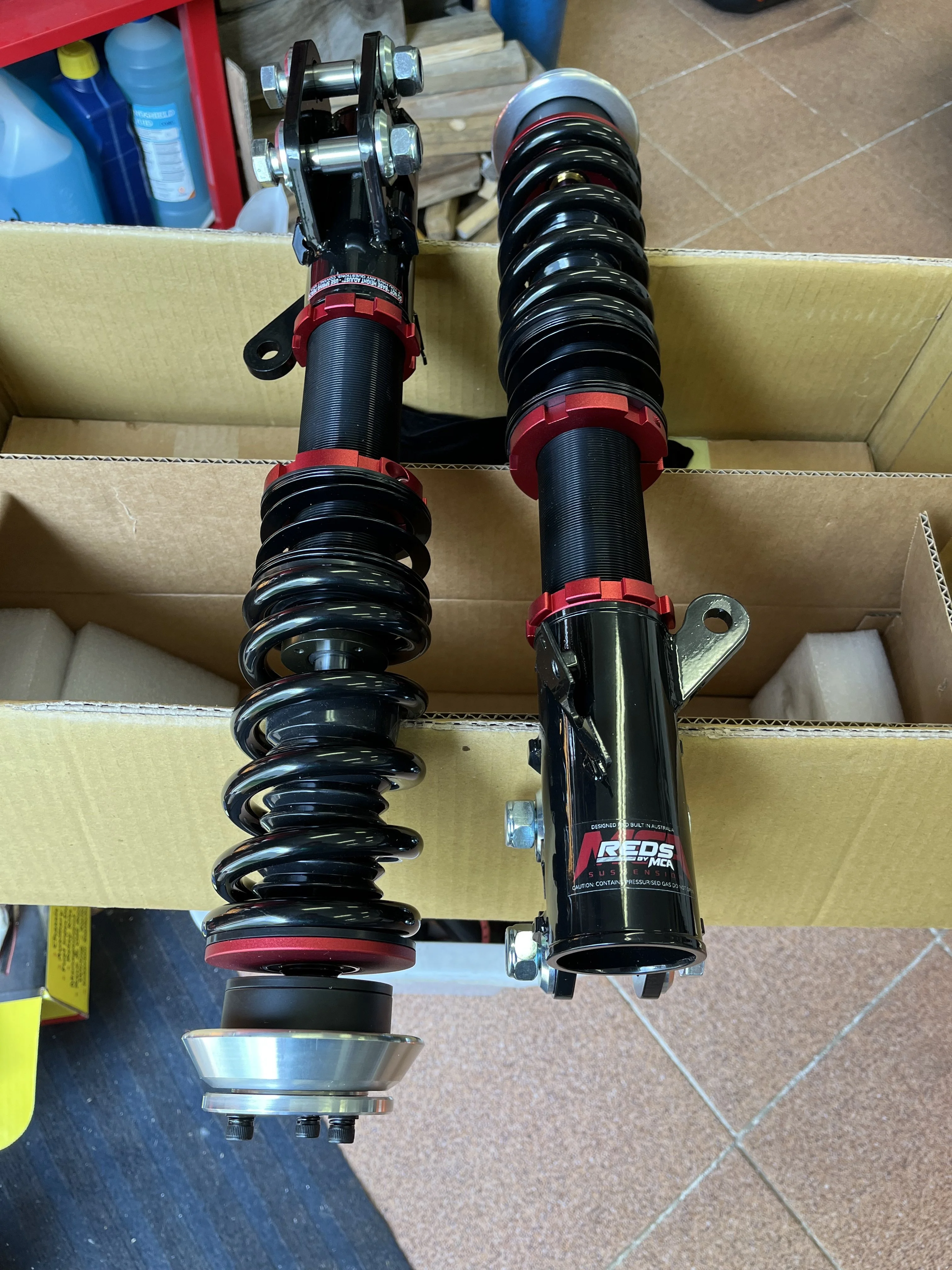

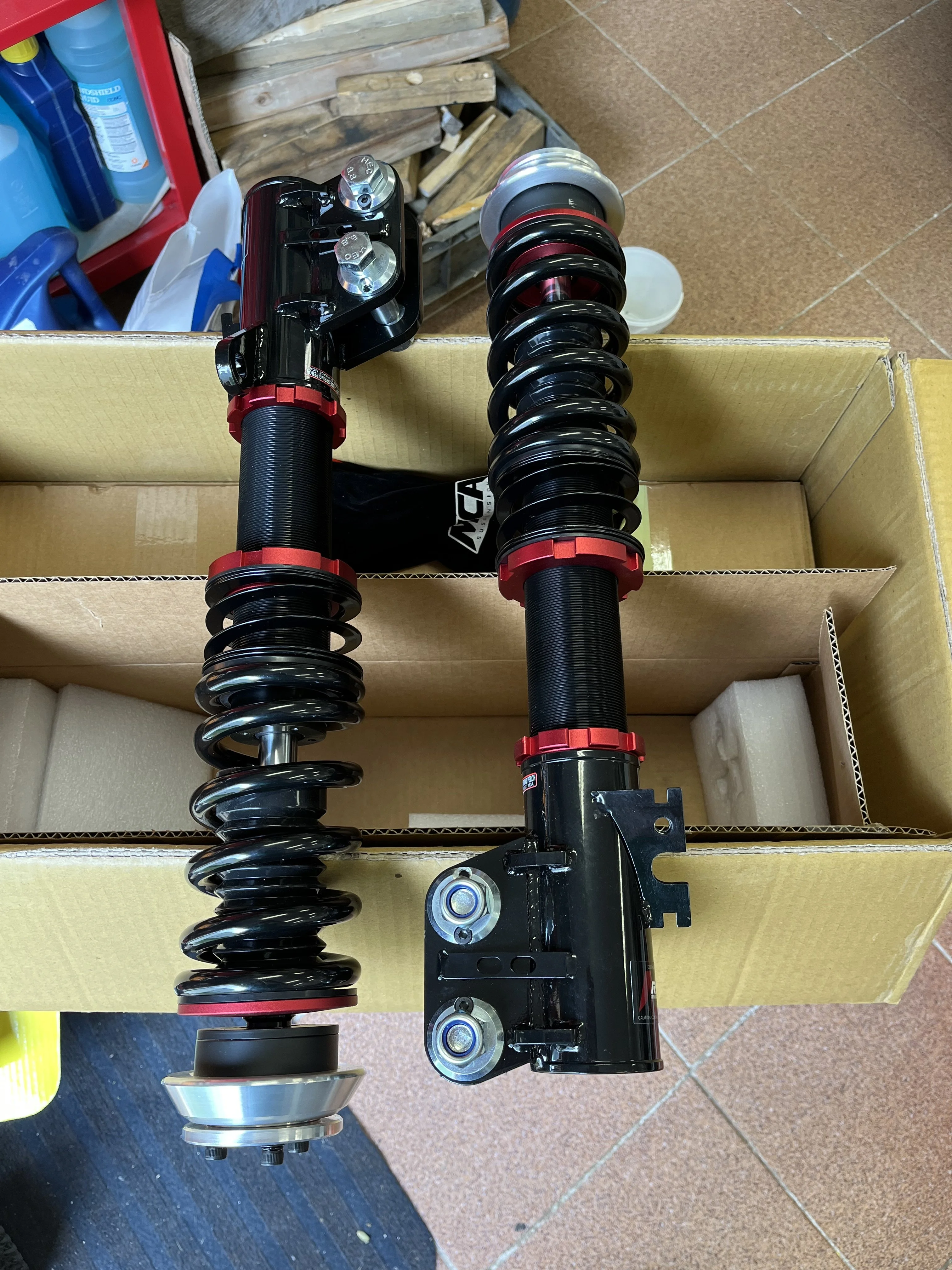

my current options are
- kw v3 - likely best compromise for street and track, but tad too soft for track, assuming its 5kg front and 4kg rear but maybe adjusting low compression helps in dialing the leaning out from GR.
- HKS Hipermax S - can maintain the stock ride height, spring ratio 7kg front 6kg rear (would be likely good sweetspot for track/road
- MCA Reds - best for track use as you can order them with custom spring ratios but unsure how they tolderate scandi weather as I also use car in winter.
Any recommendations to what way to go? Currently I'm maybe up for either kw or MCA. kw will still be upgrade to stock spring - it won't be fastest setup for track but that's life - car is not full bone track car anyways.
