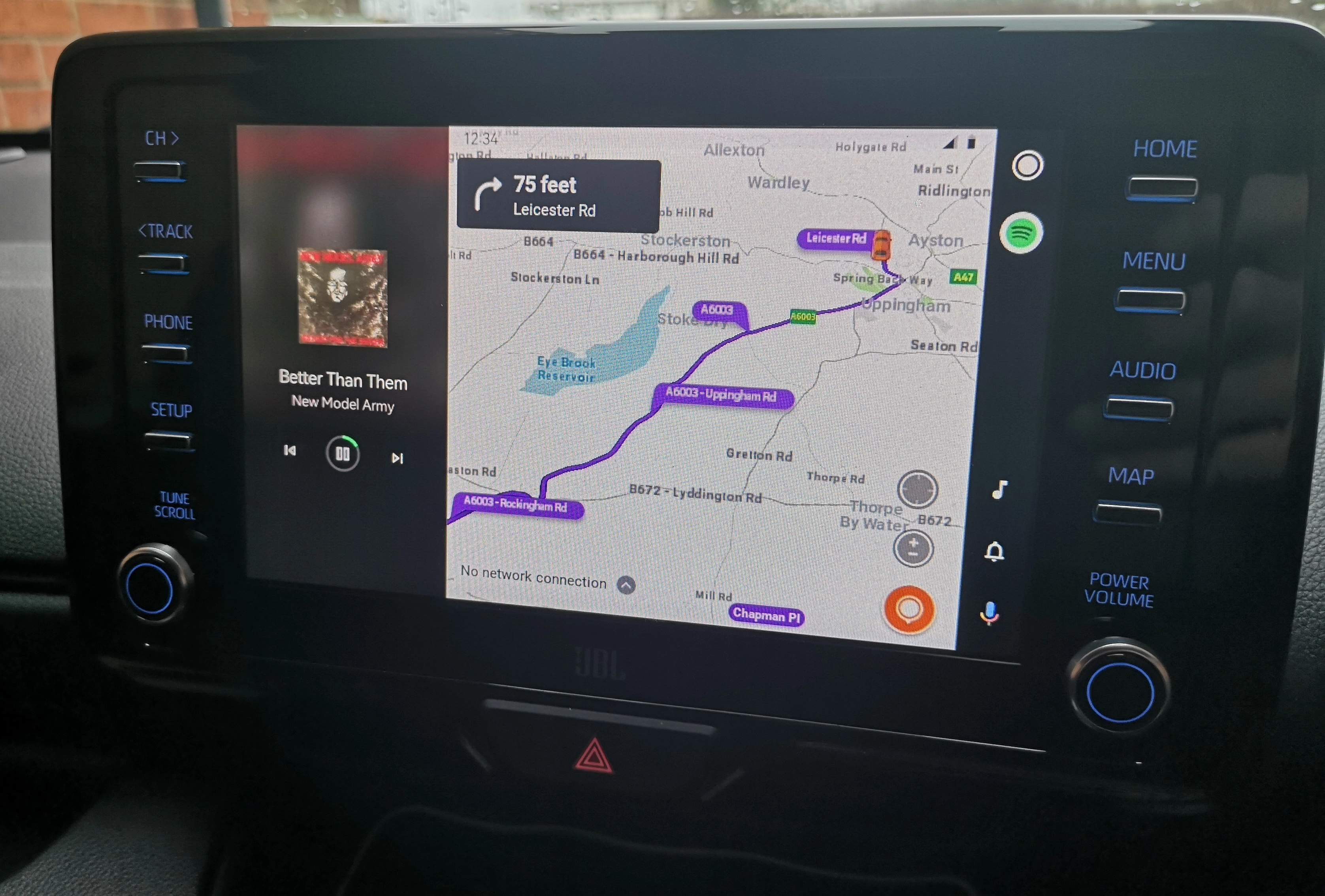

Got the split screen working and found that Waze is easier to use use, as you can see more of the options with the resolution set to 103 (even on the smaller split screen).
But I spotted an issue.
"No Internet connection"
Phone is connected to the Carsifi via WiFi, and it's not allowing data to be transmitted over the mobile network whilst connected. This works fine on other WiFi connections (it will switch to mobile if it sees there's no Internet connection via the WiFi), but not the Carsifi one... đŸ¤”

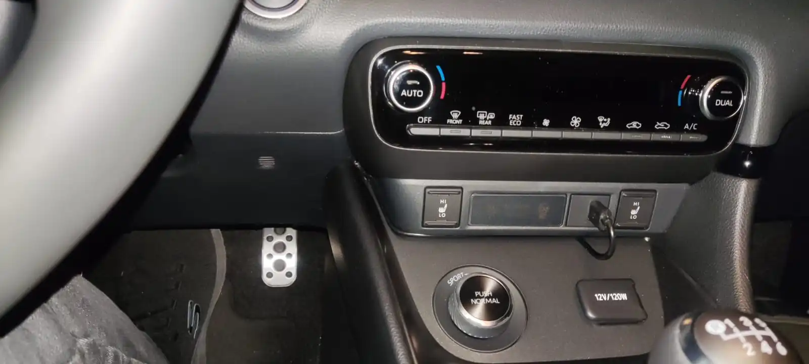

I have managed to hide it under the steering wheel, so I can access if something is wrong. Here some photos if someone is looking where to hide it.
So that adapter needs to be permanently connected to the car? To the one usb port we have? Any idea if there is an option to connect elsewhere? Could there be a second usb port behind the screen or behind the dash maybe?

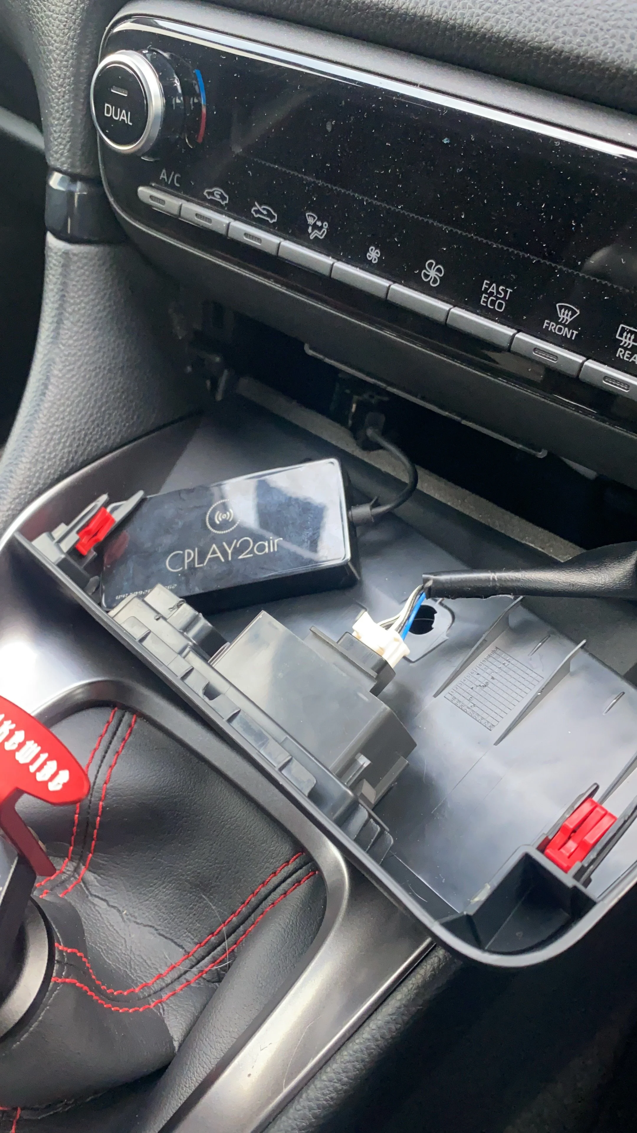

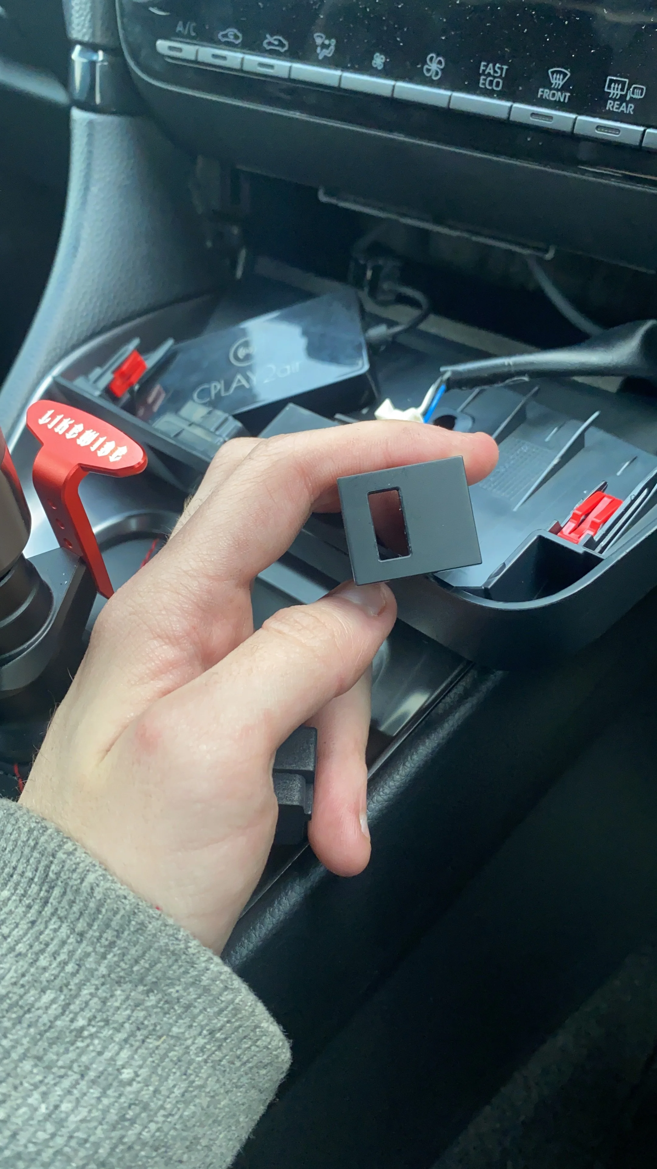

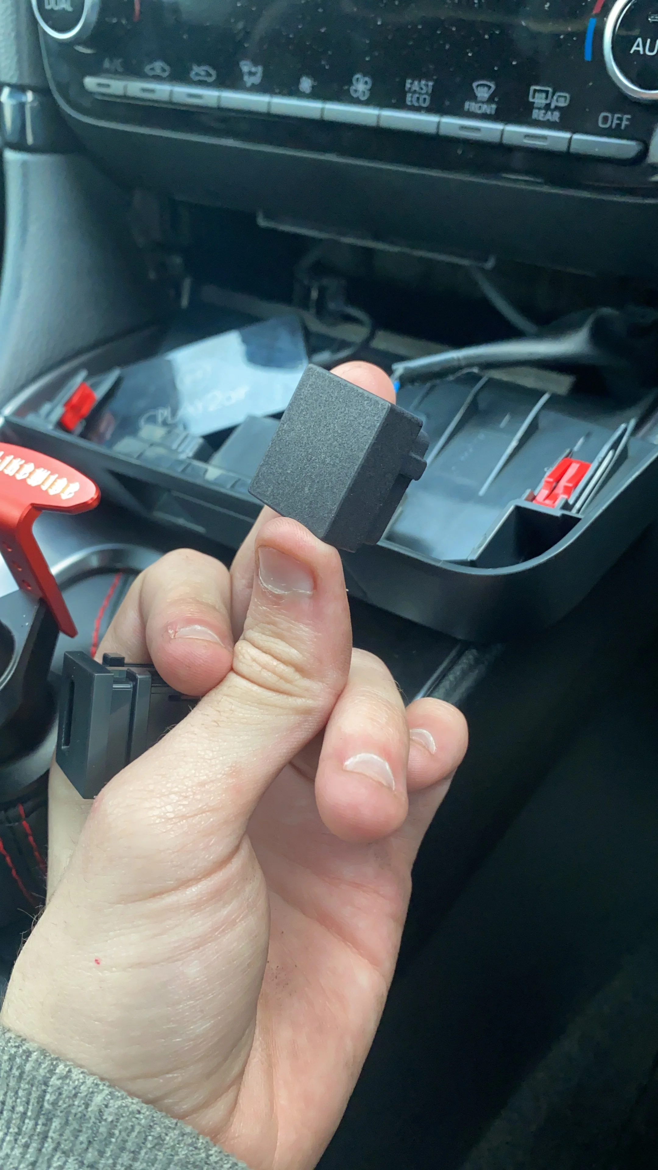

I run a wireless adapter behind the dash please see below some images hope they help.
Also have some spare blanking plugs if people want them.
