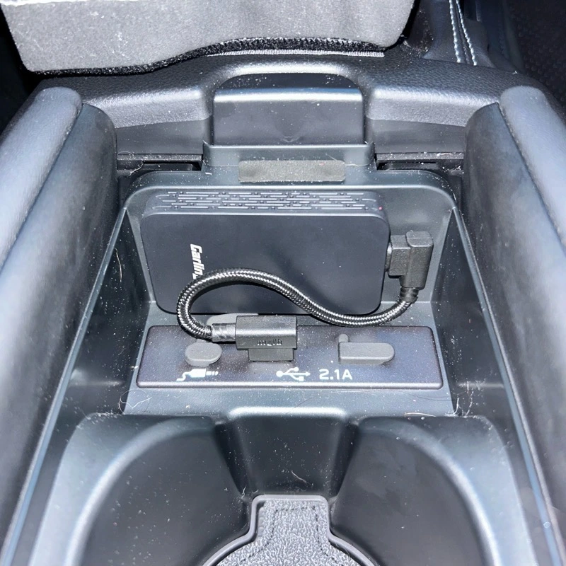

I mounted my Carlinkit with 3M tape to the front of the housing, using a short 90degree USB cable for connectivity. It means it can be hidden away with the compartment closed. Haven't had any issues to date. (Photo linked from my 'Members cars' thread).
img_6194-jpeg.24667
Thanks everyone. It seems to be working well, and now I need to find a 90 degree cable!
