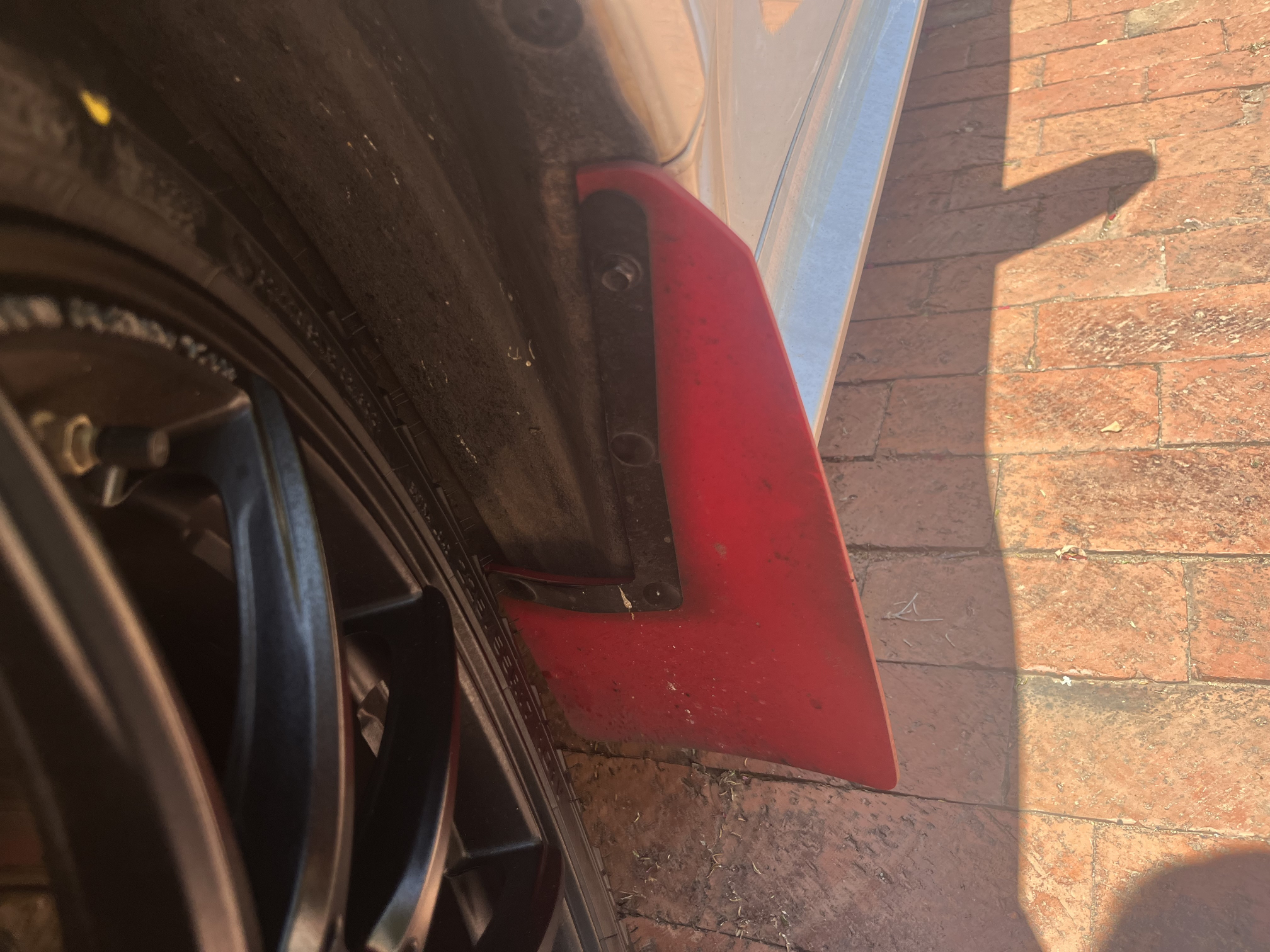

Took a lot of math and convincing my self but finally did it, cars running aline hype flow forged 17” wheels 8.5 wide, and falken wildpeak 225/55/17

And how does it drive? I have/had mine on 17" gravel tyres 225/45 which are in effect probably /50, but the tyre I got was way too soft sideways. Will try some other in the future... How do these tyres drive?

They drive quite well, i can feel the side walls flexing more than the standard tyres on turn in so feels a but floaty but thats due to the lager side wall. Other than that they are good

Do they withstand some rally(cross) type of driving? Do they like sliding? Or just for general all-terrain use?

I got them to go send it off road😂 so hopefully they stand up to it, only put them on today so haven’t had time to go throw it around on a dirt road

But they should stand up to it

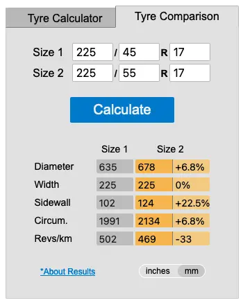

also +7% higher gearing so that is quite a bit, hitting that 100km/h on second gear, and top speed goes to 246km/h if not gps limited.

Illegal here and probably many countries, tacho underreading and no insurance payout if in an accident that in any way can be attributed to tyres (quite easily)....

Yes from my math it should hit 100 in second gear now

See but I’m in good old south africa where everybody puts bigger tyres on their pickups and suv so no one will mind it on the yaris
