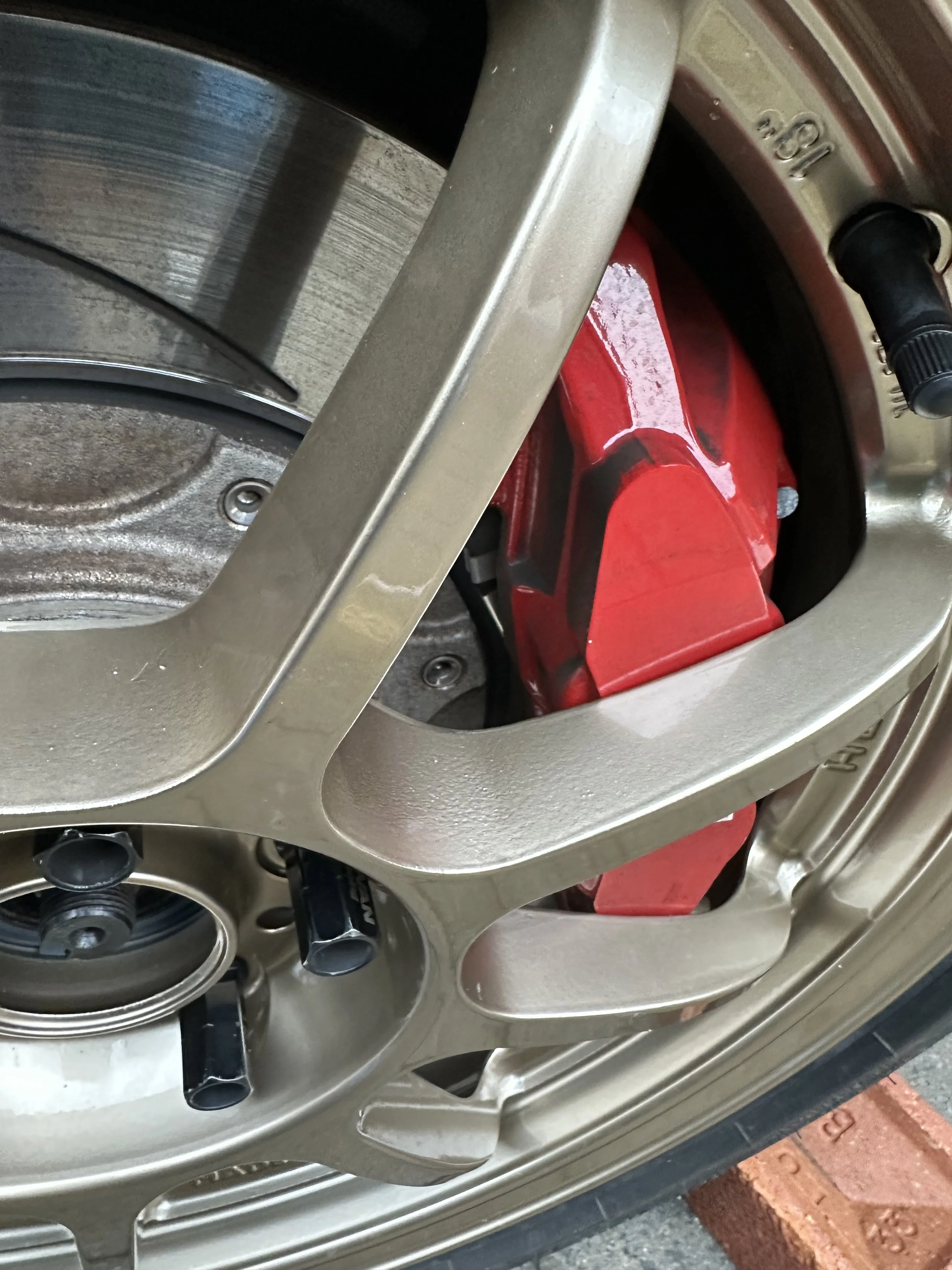

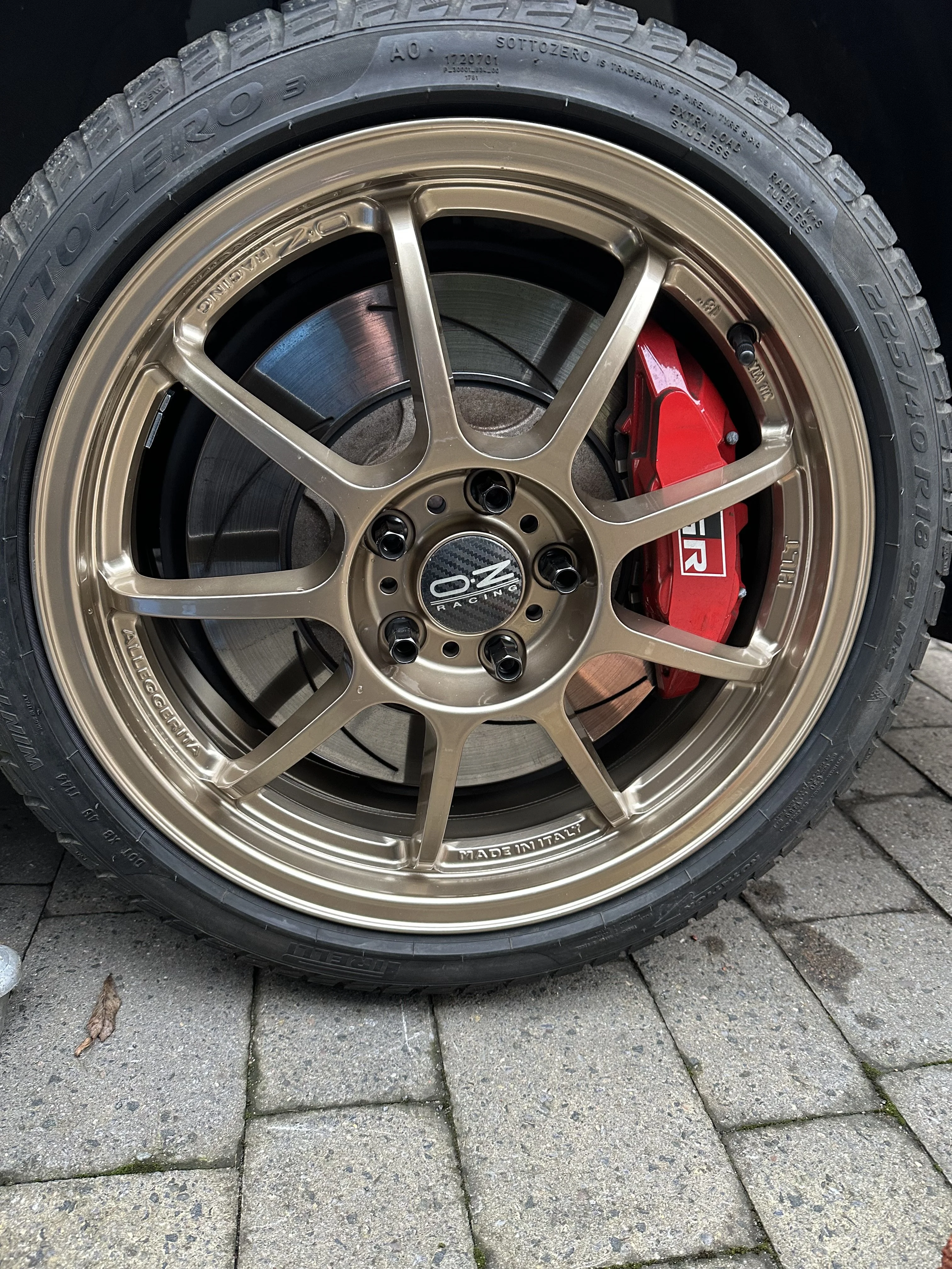

Fitted some lovely OZs as winter wheels but they don’t fit, 18” and ET45 but the rim width is 7” rather than 8” and they don’t clear the caliper. Im guessing spacers would sort this?
If they just touch, and if you have 10+ turns on the nuts, and if the hub is properly engaging 10+mm, you could get away with 3-4 mm spacers.
I had the much same with the Avensis wheels I'm using for Winters. The face to face clearance was about 0.3mm. I just use 2mm spacers, still plenty of hub centric engagement.
