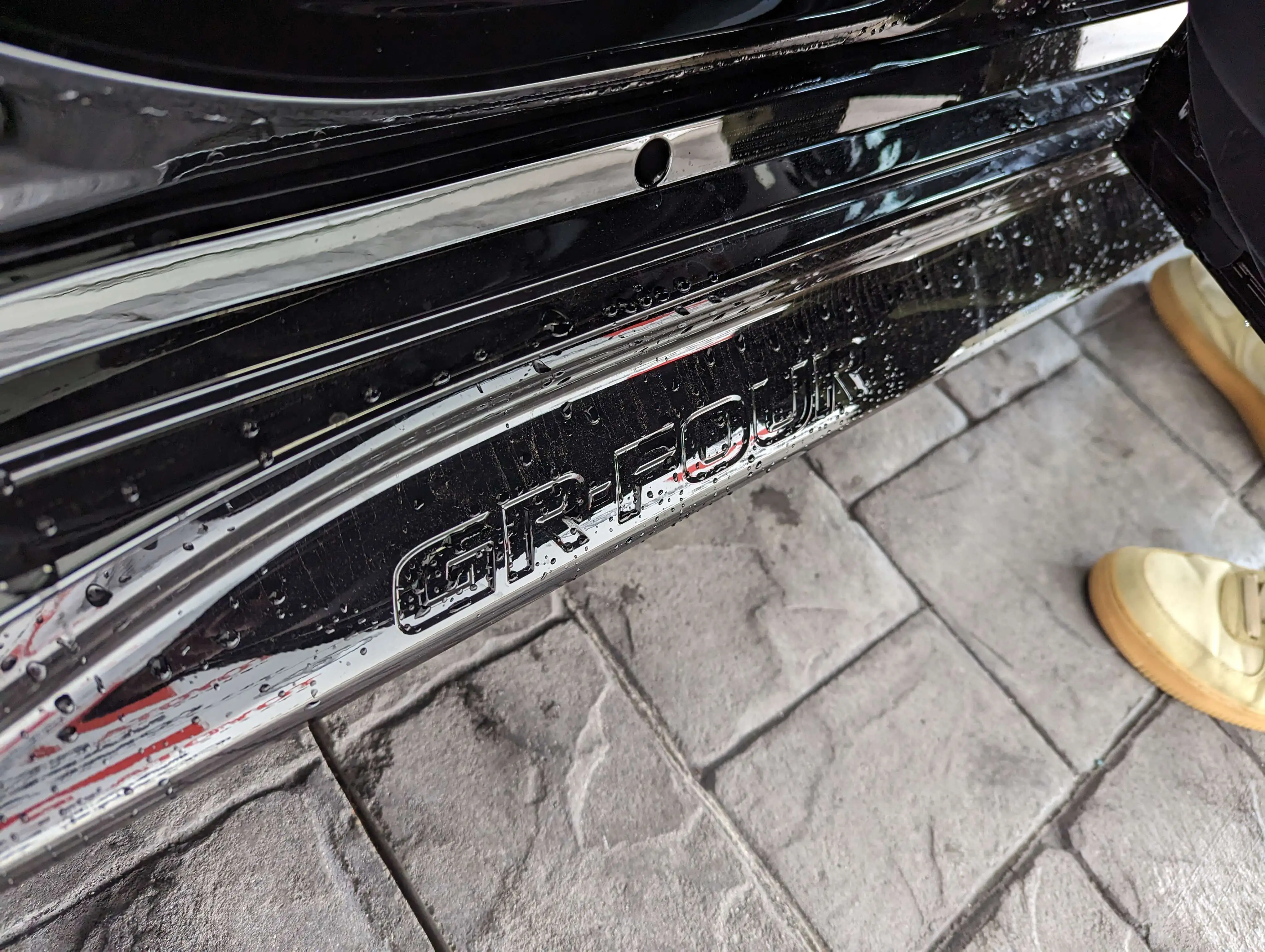

might as well post this here too. heres the GRC's front under tray with the transfer case duct
pxl_20230206_155650442-jpg.13442
