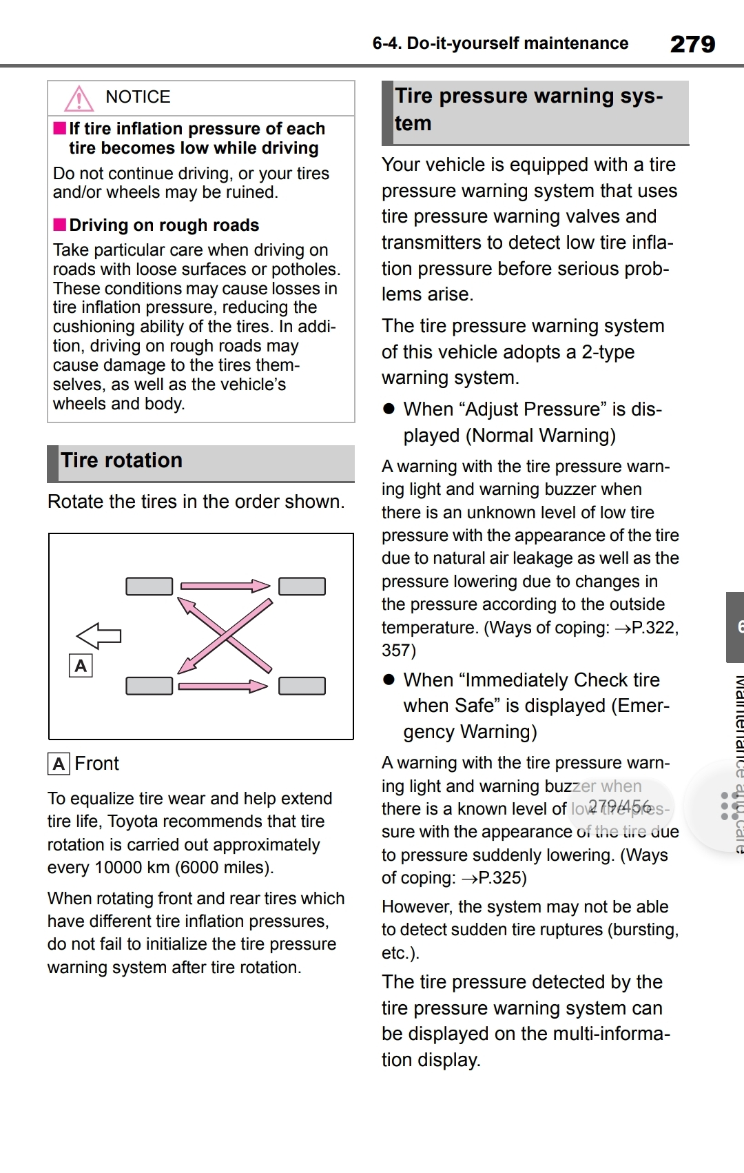

Took my car in for the 12k miles service, and the tread across the tyres has worn evenly. But they did say that the inside edge of the fronts is scrubbing.
They offered to replace the tyres, but I told them no, and I'll change them when I need to.
What they didn't offer, was to rotate the tyres. I was thinking the easiest thing is to swap the fronts with the rears on each side, but the manual suggests moving the fronts to the back on the same side, and then moving the backs to the opposite corner at the front.
What would people suggest, and I'm guessing it makes sense to do this fairly regularly? Advice appreciated.
I do what the manual says but I get the wheels rebalanced too (which is £20) as with wear they change a bit.

I’ve always rotated tyres on my cars but this is the first that swaps a pair side to side as well
I swap front to rear every 5,000ish km. I marked the rims with a marker pen inside so I don't get confused after swapping to and from track tyres. Those do an event in one position then swap to the opposite next track day. May be overkill but easily done when the wheels are on and off for sprints.
Swapped mine front to back a little while ago but definitely didn't know it was suggested to swap the backs to opposite fronts... Not noticed any negative effects.
Also, if you had directional tyres you wouldn't be able to do it anyway.
Will rotate my wheels this weekend. Then I'll do it regularly.. every 3,000m or 6,000m?
