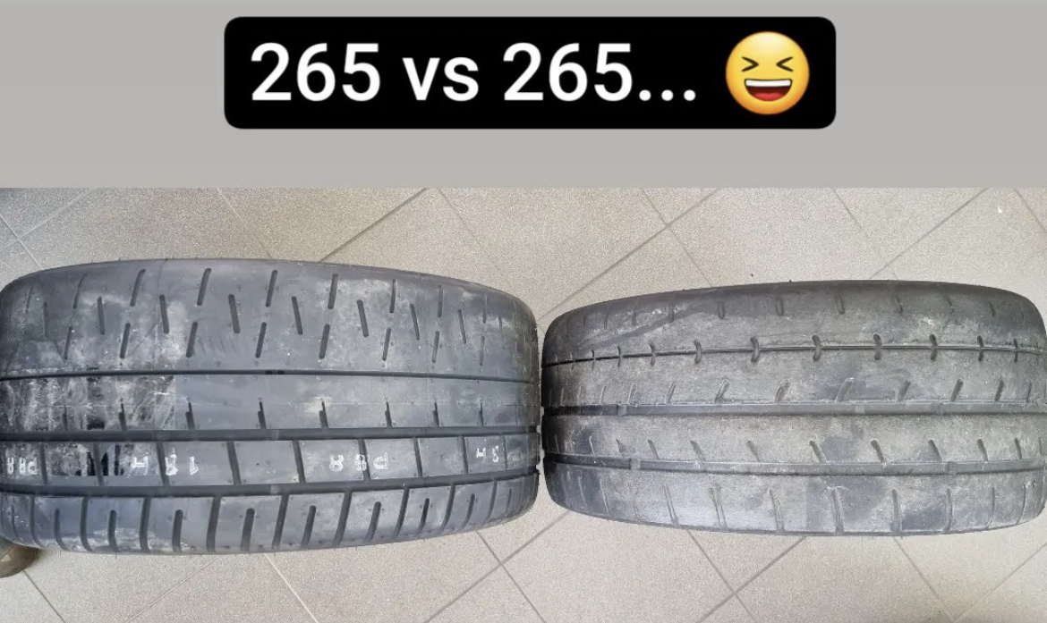

And 265/255 isn‘t the same width on every tire.
See attached pic of the Yokohama A052 and the Pirelli Trofeo R both in 265/35. The Trofeo R is ~285mm wide.
255/35 and 265/35 there are certain tires available and certain aren‘t, so you also need to decide which tires you want to run and than commit to that.
