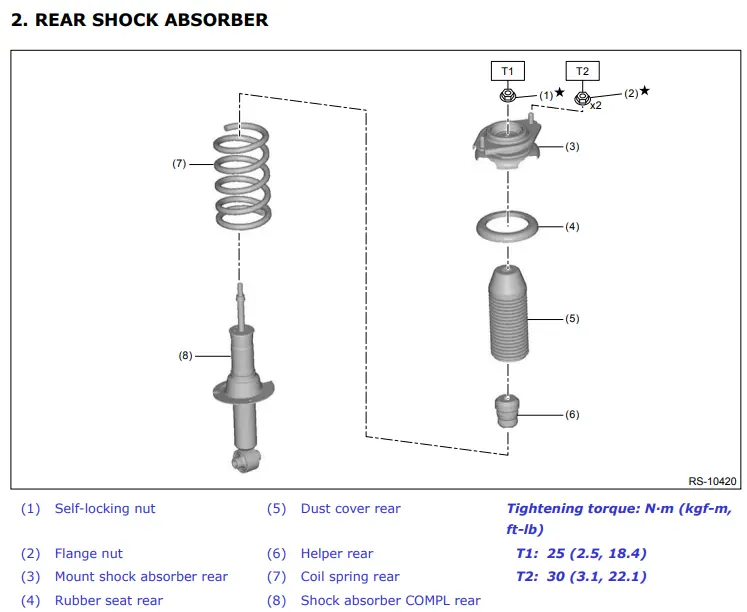

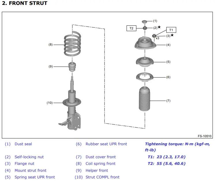

Item 9:
Item 6:
Used sites like PartSouq or other catalogues to good success previously.
See this link for fronts: Partsouq link, which suggests SU00300374.
ToyotaPartsDirect don't list it but doesn't mean they won't source it if you ask them to.
