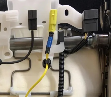

One of the challenges is the connection to the airbag. Toyota does not sell the airbag connector individually.
What people do is cut off the original connector on the OEM seat and make an adapter from it.:oops:
Yellow is the airbag connector:
That is wild…
We just put a resistor in and tape it shut. Never failed and you can go back to stock if needed in about 3min.

Thanks both. I'd rather not cut any wires, ideally. My seats will have airbags so I do want to use them which means no resistors. I think I just need the right connector then use two wires and ignore ground (brown) 🤞

no need to do this. there is a plug available from lexus that fits and can be connected to the recaro seat. so you can keep it pluggable. i found a thread about it here or at yaris owners uk

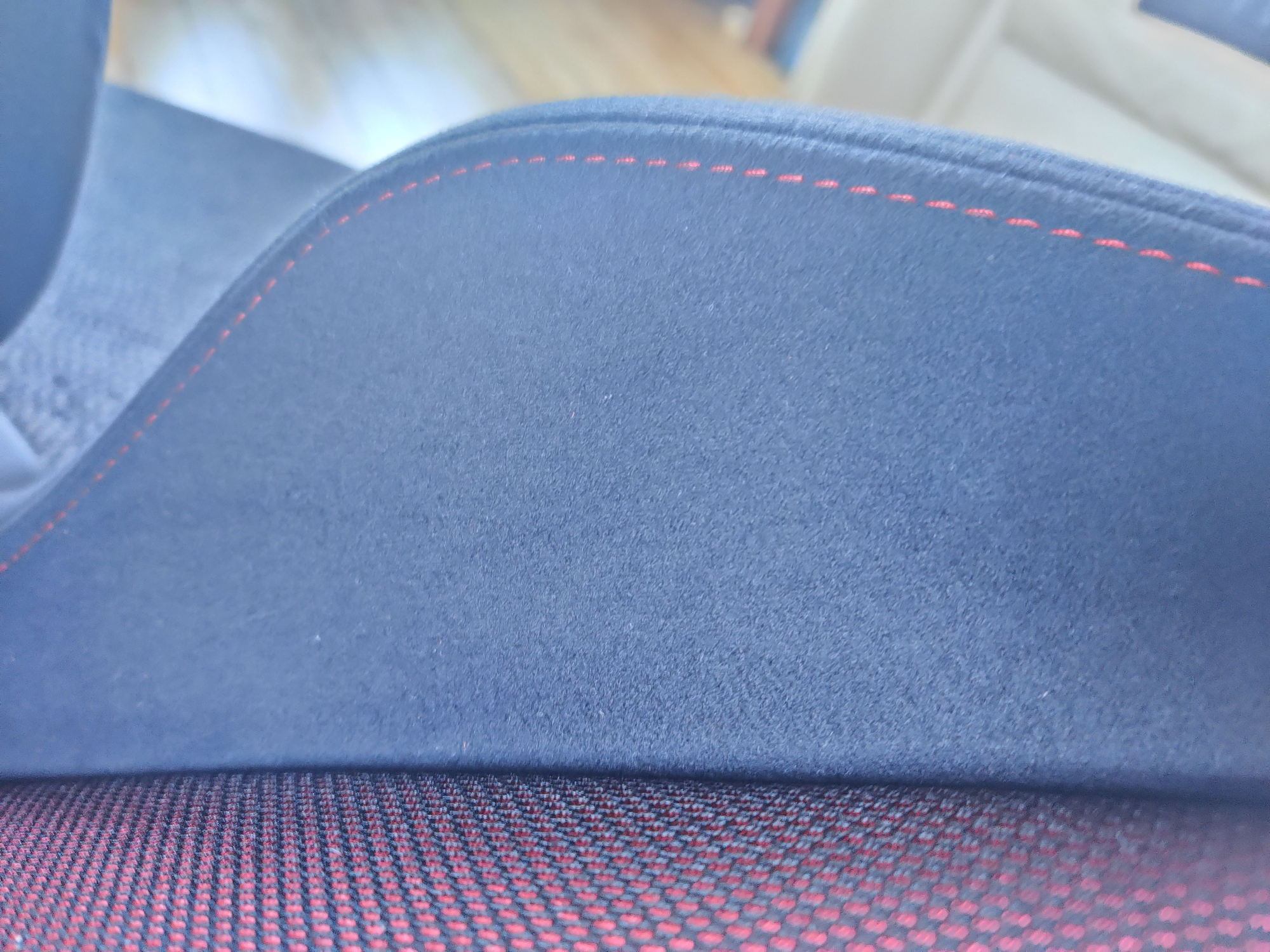

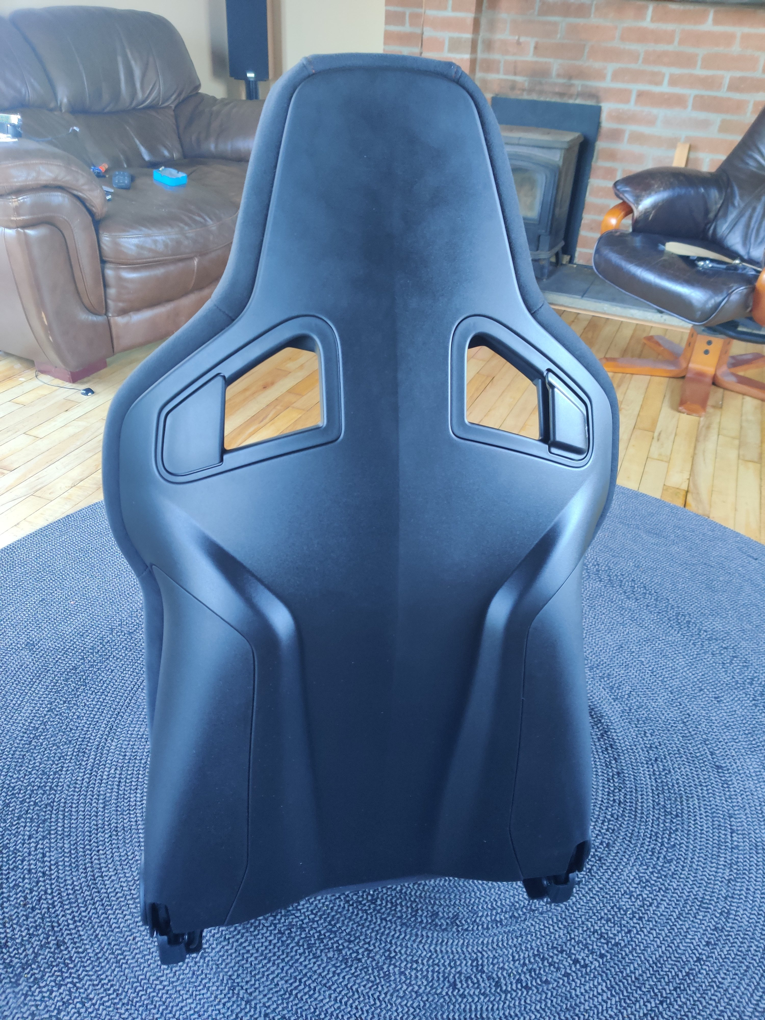

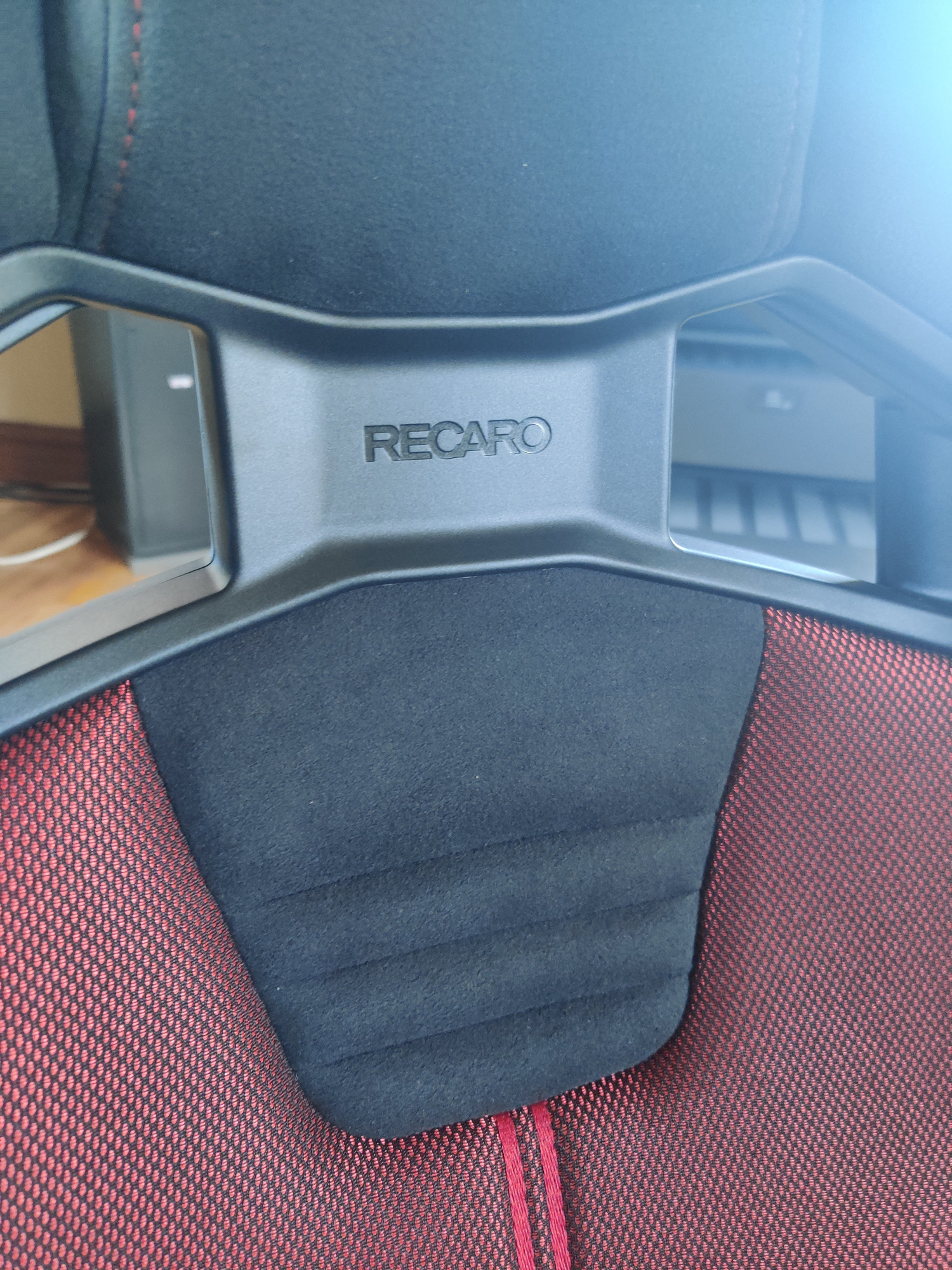

I was going to update this thread when they were fitted. The seats arrived last week and they'll be fitted next week - they look absolutely fantastic plus they have red stitching which I didn't expect, but there are no airbags!! I though they'd all come with them based on this Recaro JP site as you can see airbags on the 3D render and there's no mention of them being optional.
Oh well, I won't be sending them back as it was a bloody fortune with all shipping costs etc - ended up no cheaper than buying UK ones which would have had airbags (but aren't as nice looking in my opinion and they don't have option for electric recliners or lumbar)

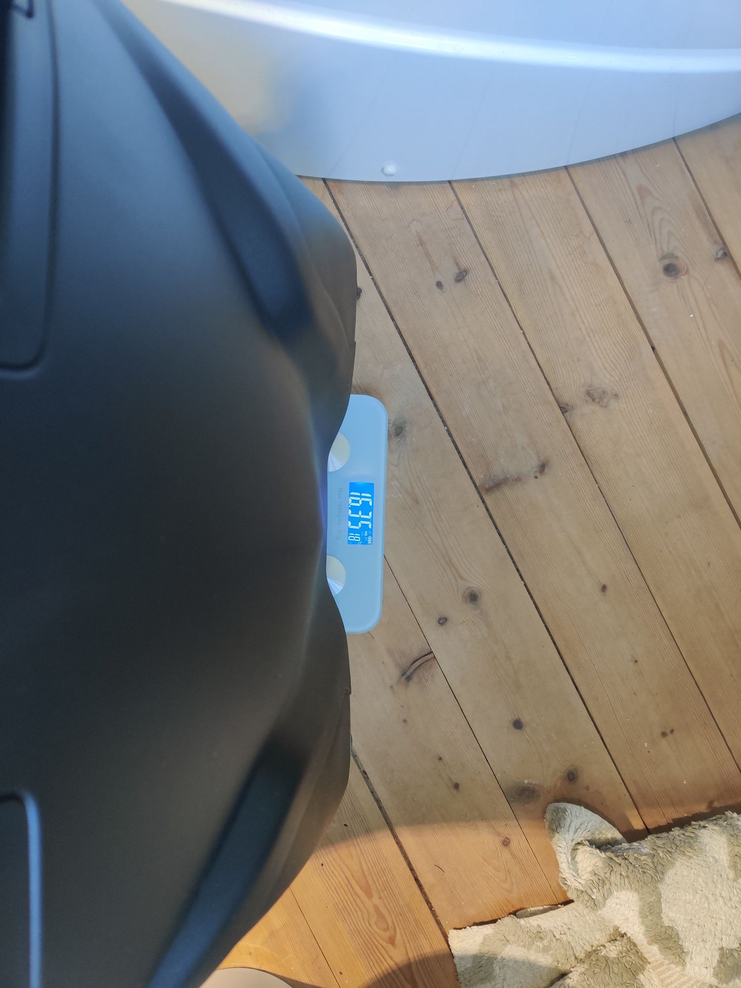

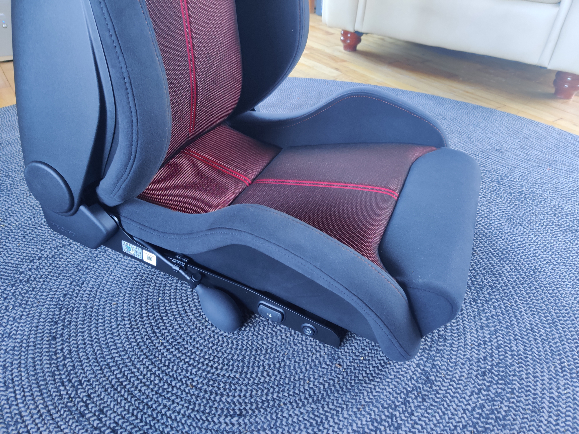

One seat weighs 16.35kg plus the mounting plate and runners are around 8kg (not taken out and weighed separately) so I doubt this will be lighter than OEM.

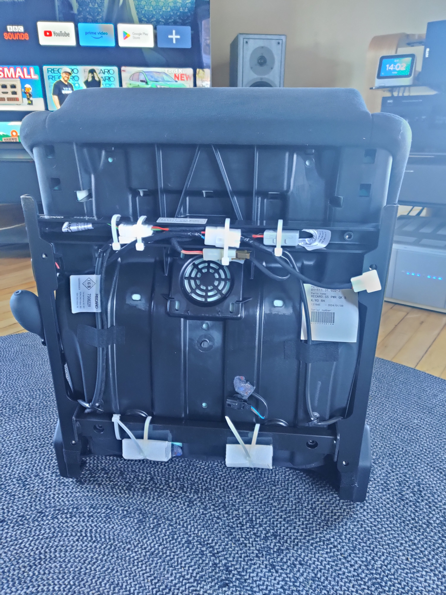

There are 2 connectors at the bottom which I'm not sure about. I thought this seat would only need 12v feed.

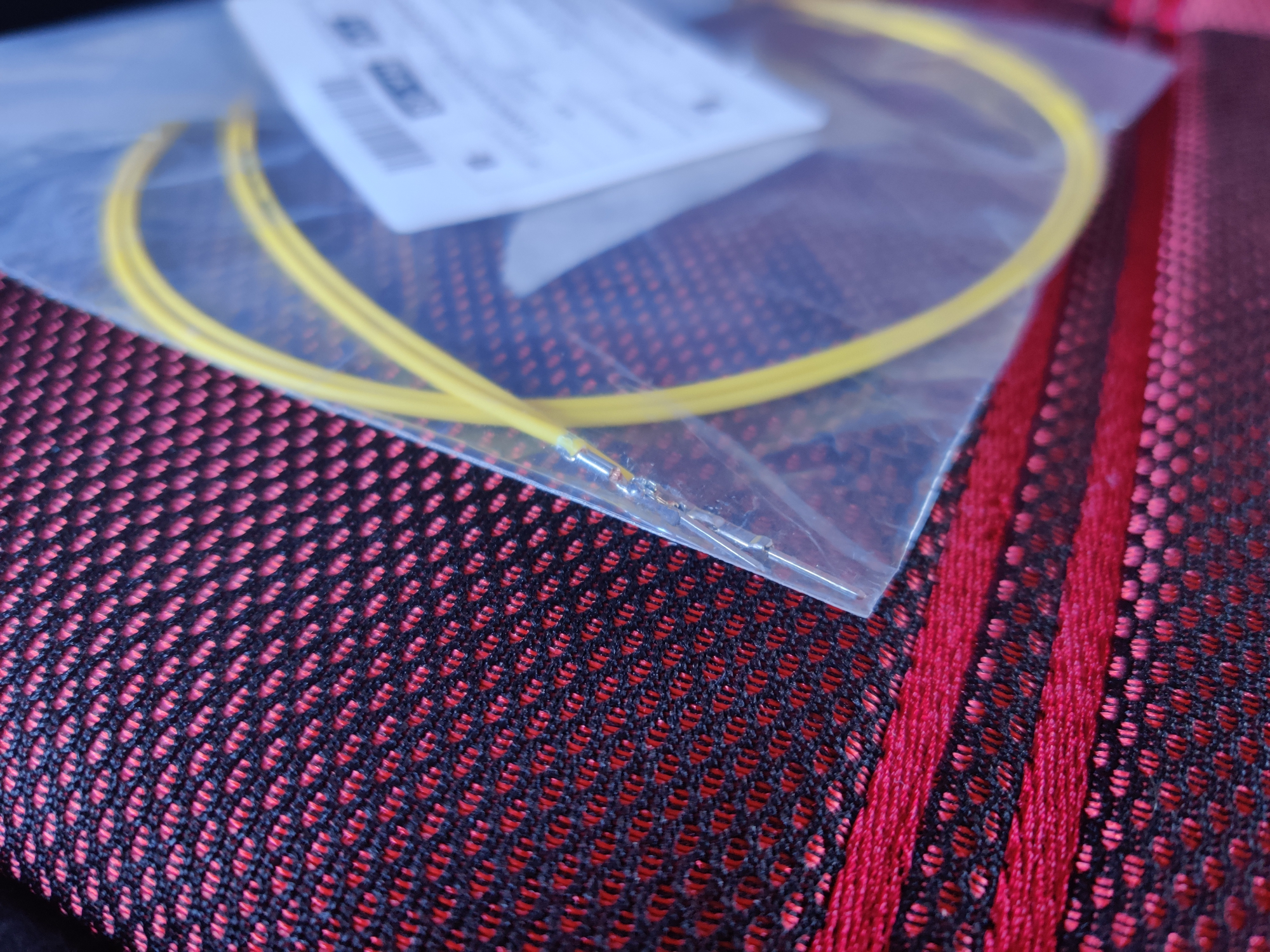

I did a lot of research before buying and also came across that thread which was very helpful, thanks Tralien. I ended up ordering that VW cable which wasn't bloody cheap but then I think I found the right connector with the pins on Aliexpress, so the VW cable will be going back if that all works out.
It was difficult to find info for these seats so I hope someone finds these links useful in future:-
6098-3933 connector & pins (12v?) - https://www.aliexpress.com/item/1005003994263139.html
90980-12697 connector & pins (airbag) - https://www.aliexpress.com/item/1005005486822238.html
VW cable for airbag pins (hopefully not needed) - https://www.allcarpartsfast.co.uk/vw-audi-seat-skoda/vw-audi-seat-skoda-000979017e-wire-set/
